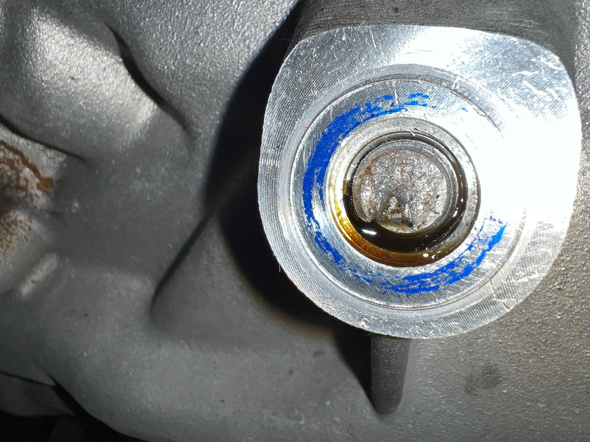

As I was tightening the drain plug to 18 foot pounds, the bolt head sheared off. It's the bolt on the front of the pan not the one that's on the side of the pan. I think the problem is my torque wrench. It never clicked and now that I think about it I should've known I was overtightening the bolt. Spilled milk at this point.
Does anyone have experience with removing a broken plug. I don't believe the threads are stripped because I hand-started and tightened the bolt. Would a normal screw extractor work? Recommendation on a type of extractor?

I would take a dremel with a cut off wheel and make a small cut carefully, and us a screw driver. You can always escalate from there.

Any extractor should work. You might try a left hand twist drill bit since it's just over-tightened.
Tap at the edge with a small punch or chisel to get it to turn. It should come out with very little force.

it is tightened far more than 18ft lbs to sheer like that. I don't think a screwdriver will get it out. You need a bolt extractor tool kit where you can drill a hole in the center and then get a reverse tap on it and back it out carefully.

I was able to remove the broken bolt using an Irvin bolt extractor set. I used the #3 extractor after using a 5/32 drill bit. I used a center punch to make an indent but the bit still walked on me. Then I used a left handed 5/32 bit to make the hole. Afterwards, the extractor removed easily. Luckily, the threads weren't damaged!
