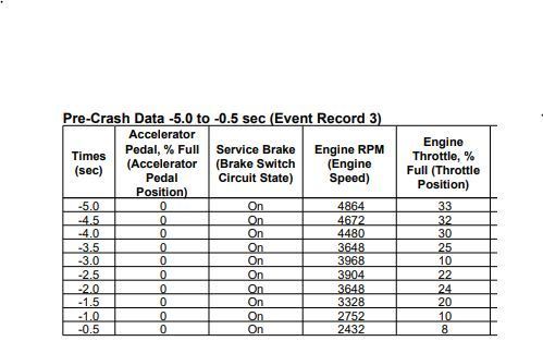

On a different but related tack... has anyone out there evaluated reported accelerator pedal sensor position vs. the throttle sensor position? This data could come from real time ECM monitoring or ACM stored data. The ACM data below came from an event that started at over 95 mph (t minus 5 sec) but had slowed to under 40 mph at the time of impact. One interesting observation to me is that the accelerator pedal sensor reads zero (percent of full open) across the 5 sec period (corresponding with driver being on the brakes, as the brake circuit was reported "on") but the corresponding throttle sensor never went to zero. Does anyone know if this is normal for a late model corvette, or any other performance car for that matter? Does this signal that the car engine is still under power or is it just a function of higher RPMs pulling air through the throttle body while minimal fuel is being supplied by the fuel injectors? Comments appreciated.

I don't think it'll ever go to zero because that would risk stalling the engine. Older cable operated throttles had a separate idle air valve to make sure the engine could still breathe while the throttle was closed. Electronic throttles combine both functions. So it'll always be open a little bit for idle control.
