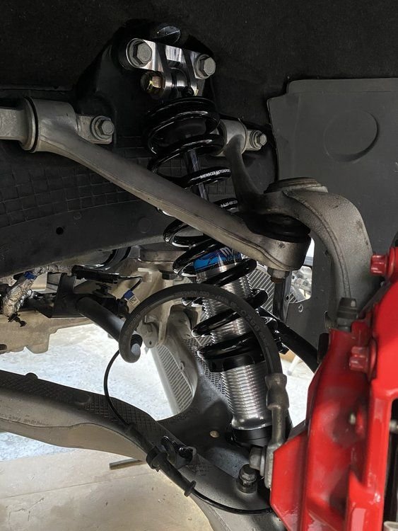

We are doing menscers on this C7. They will valve the shocks anyway you want them. Went with “No prep” calving on this car.

I’m just finishing up the twin turbo kit so it hasn’t been on the road yet.
