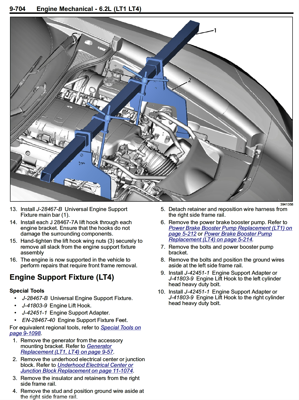

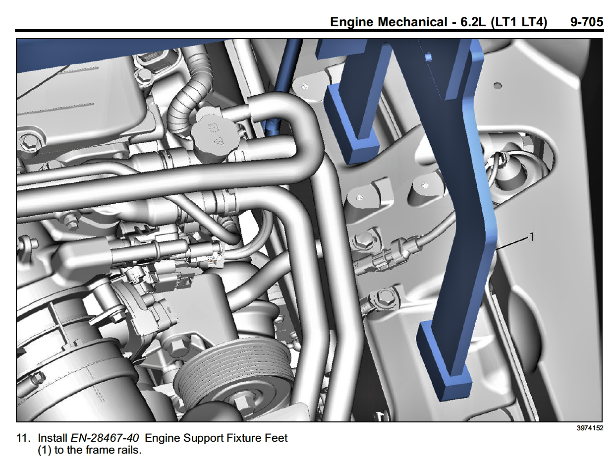

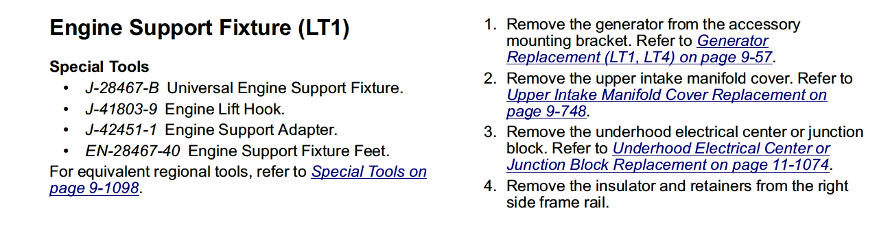

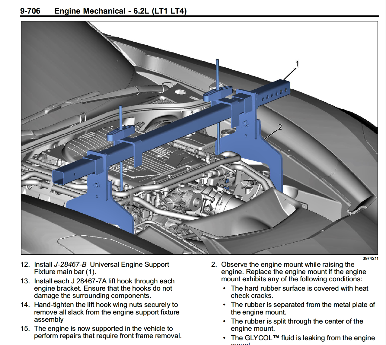

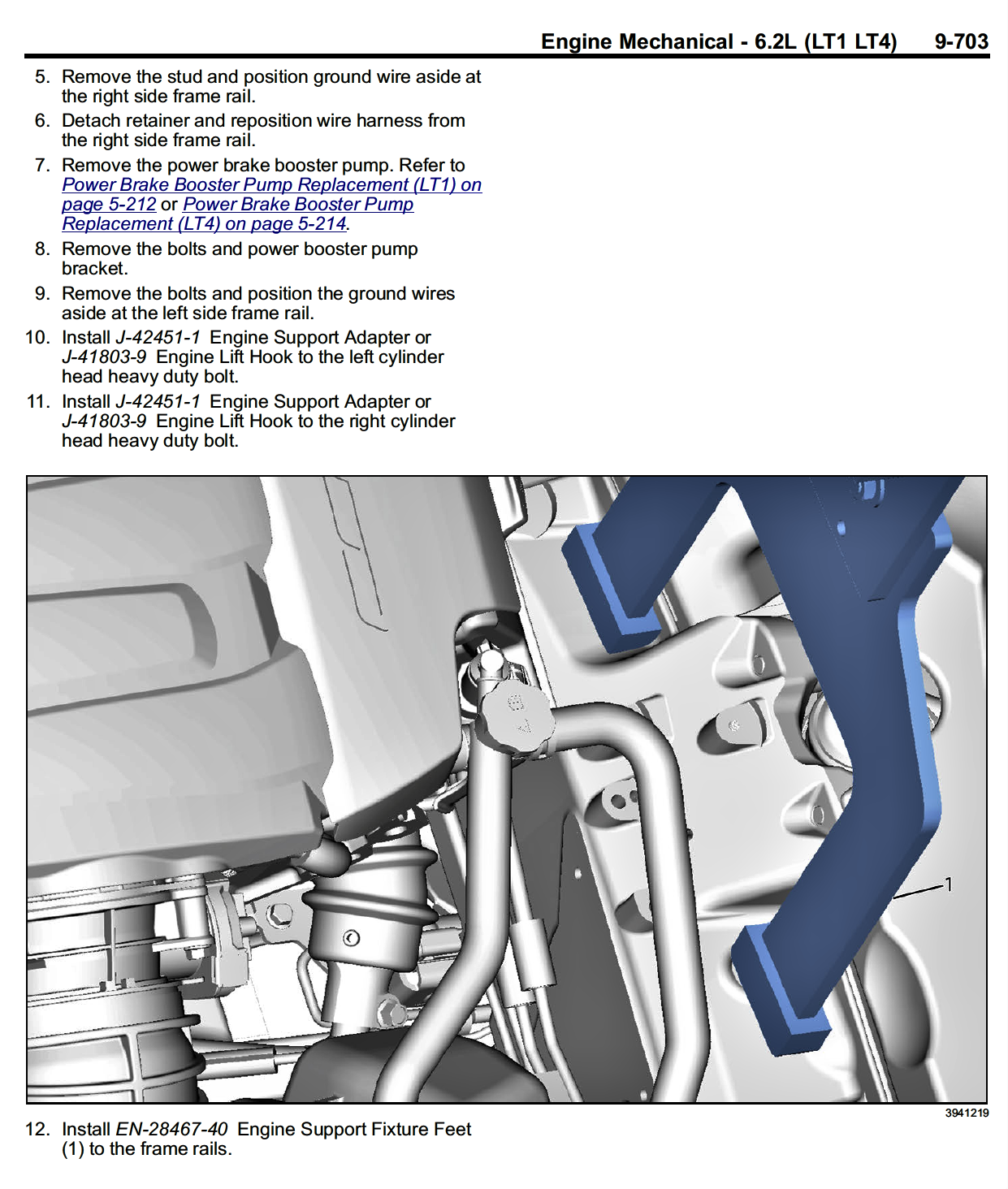

This is what the dealer uses to support the engine when the frame needs work:
I imagine the official tool costs an arm and a leg. However, you could probably make a home made set up that would do the same thing. I don't think I would want an engine hoist holding the engine while I was under the car working on it. There is always too much of a chance of a hydraulic failure letting it drop on you.
Bill

I've got the Harbor Freight version of that cross bar. I don't think the legs are long enough to reach the frame rails. It might not be too hard to get longer legs made though.
