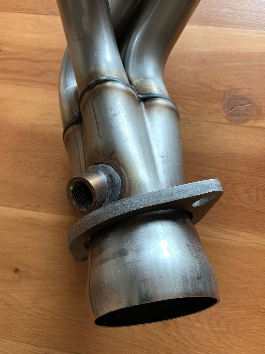

Might as well reignite this thread, it's relevant. I have my new catted ARH mid-length system and trying to figure where the wideband bung should go. Having a local speed shop install them ... hoping they can figure it out but wanted to check here too.
As I understand, for best accuracy the wideband sensor has to be pre-cat, and it has to be in a spot where airflow over it isn't affected by the O2 sensor ... so that means I'd have to have it mounted opposite the O2 sensor, in the ~12 o'clock to 3 o'clock position.
(Tuner said they won't delete the O2 sensors in my new tune, because EPA regulations ... thus we can't just plug it into the existing O2 bung)
Haven't been able to eyeball things to see if it'd be possible to install the sensor to the right of the O2 bung in this photo - would that work, or will things be too tight?
