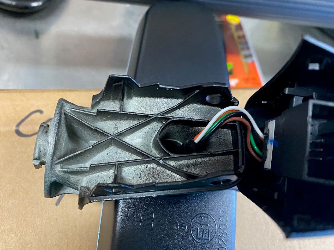

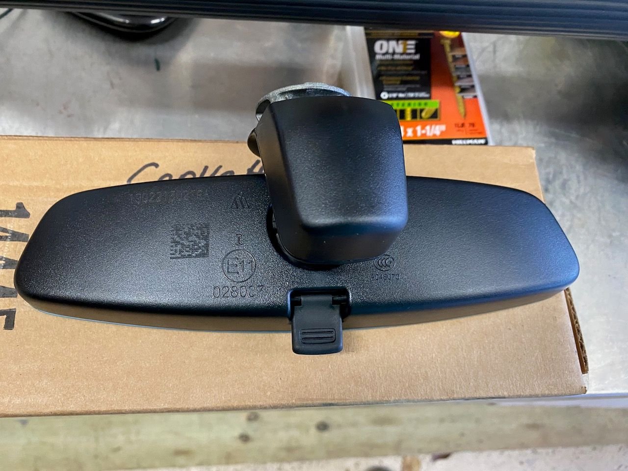

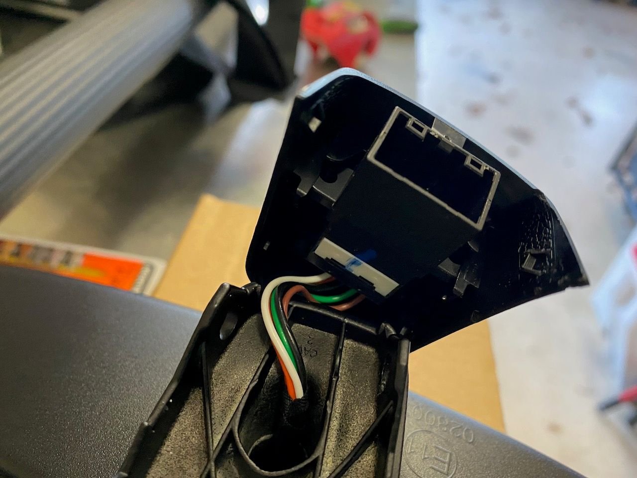

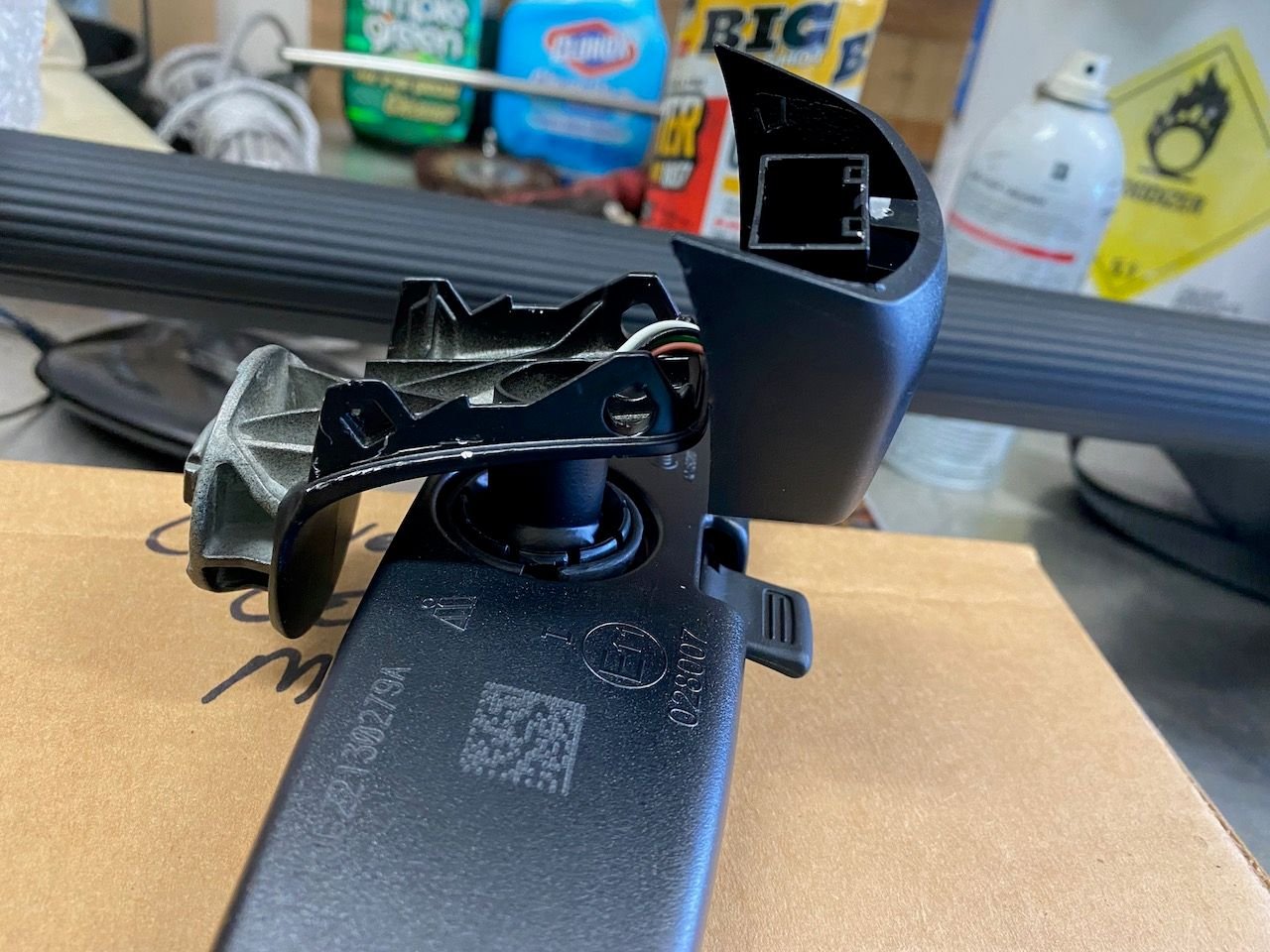

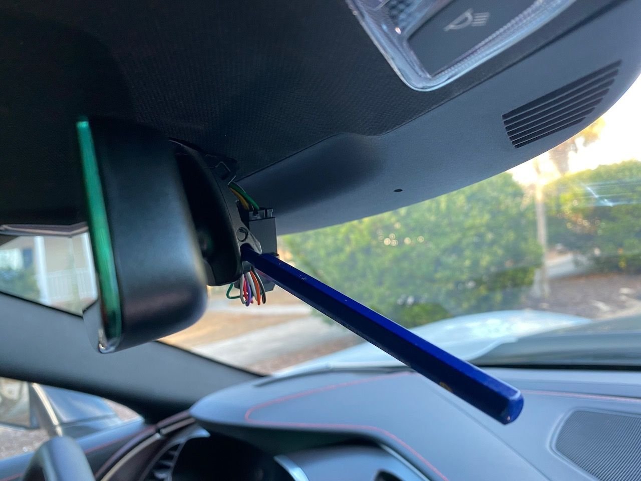

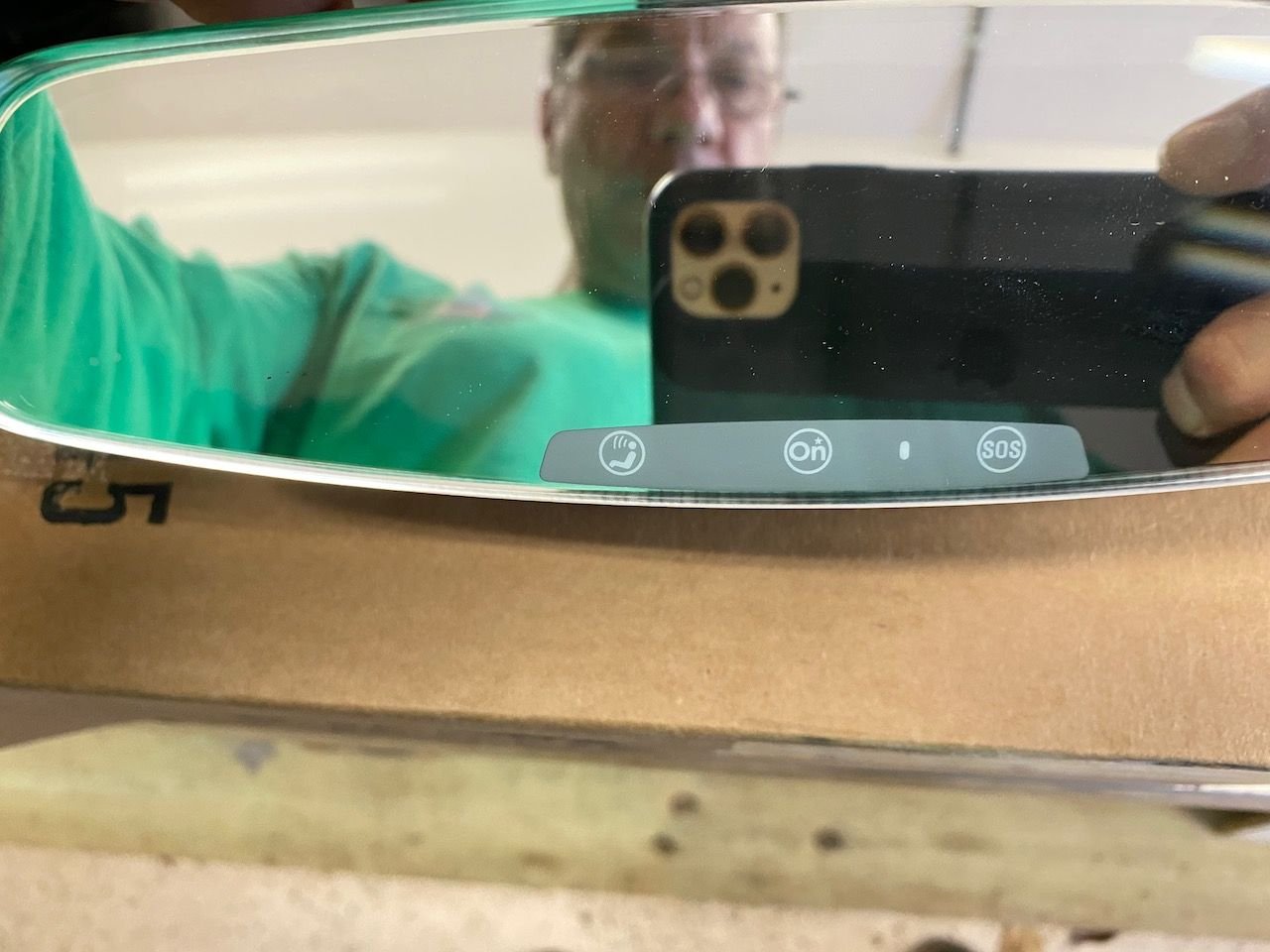

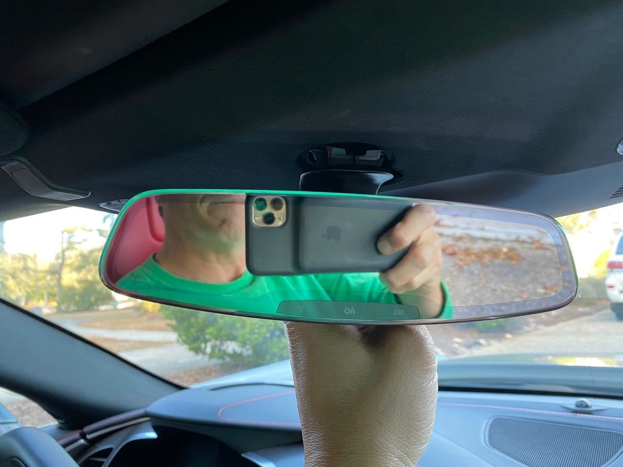

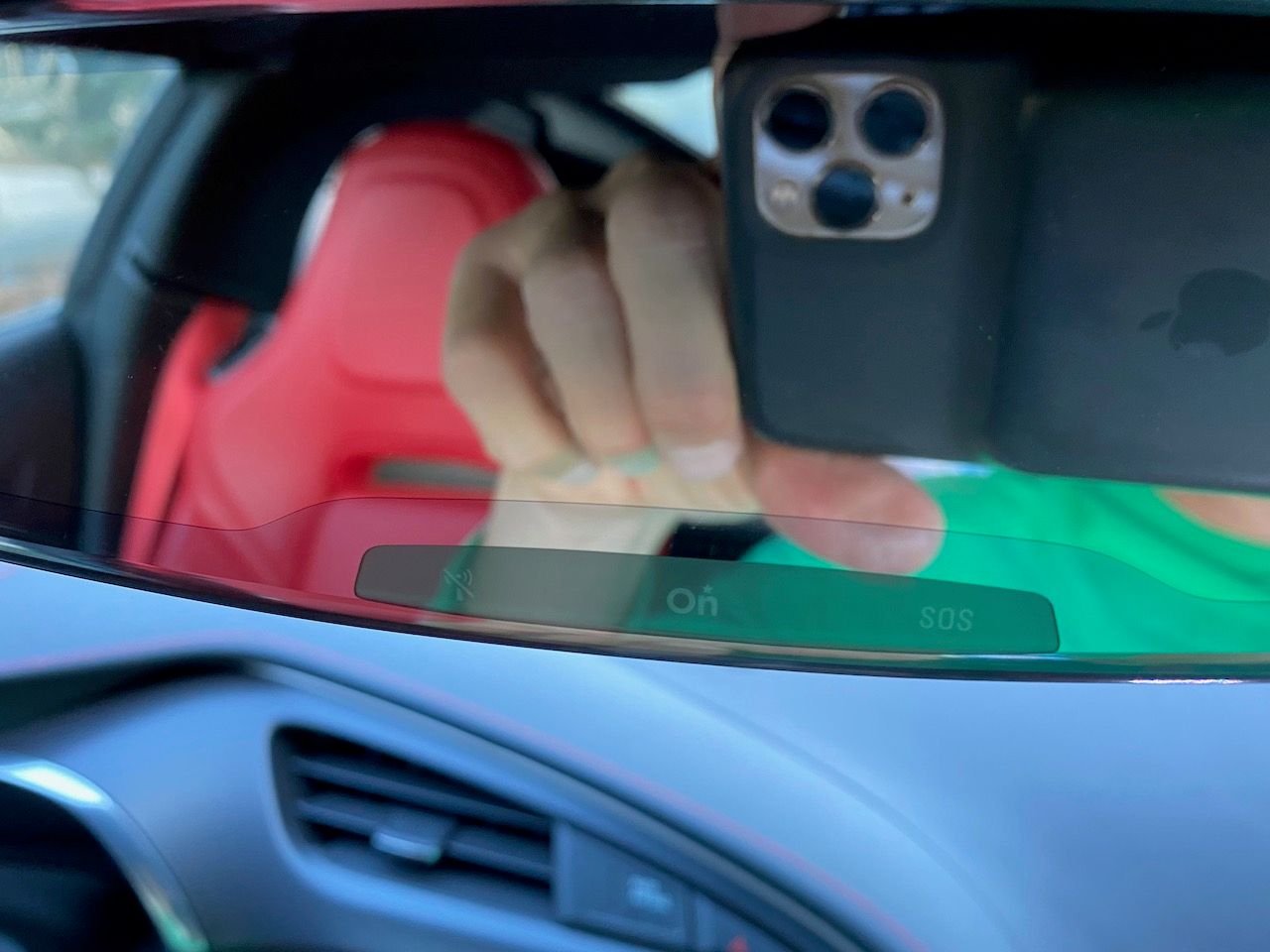

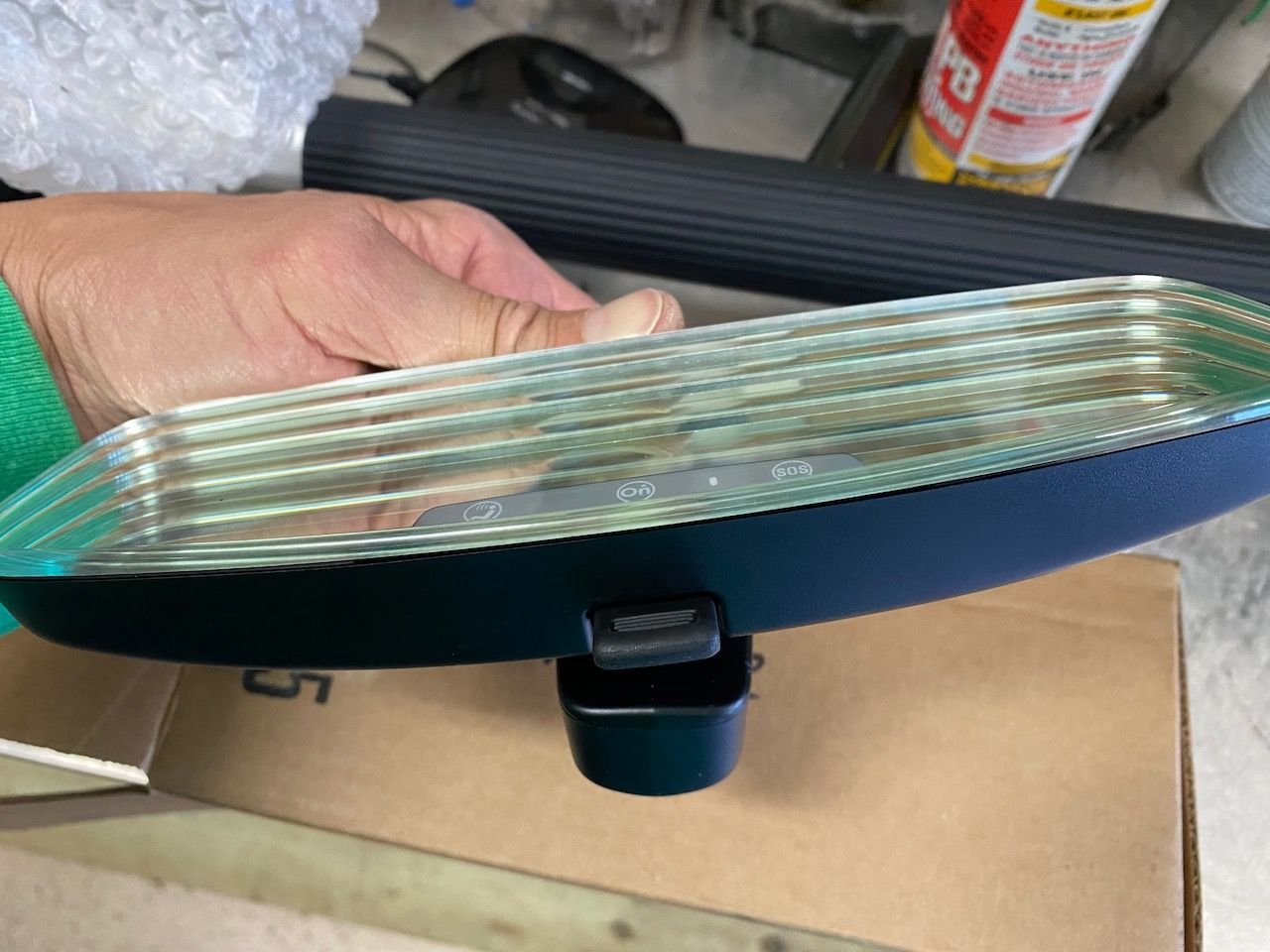

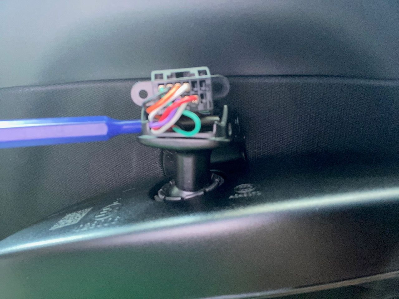

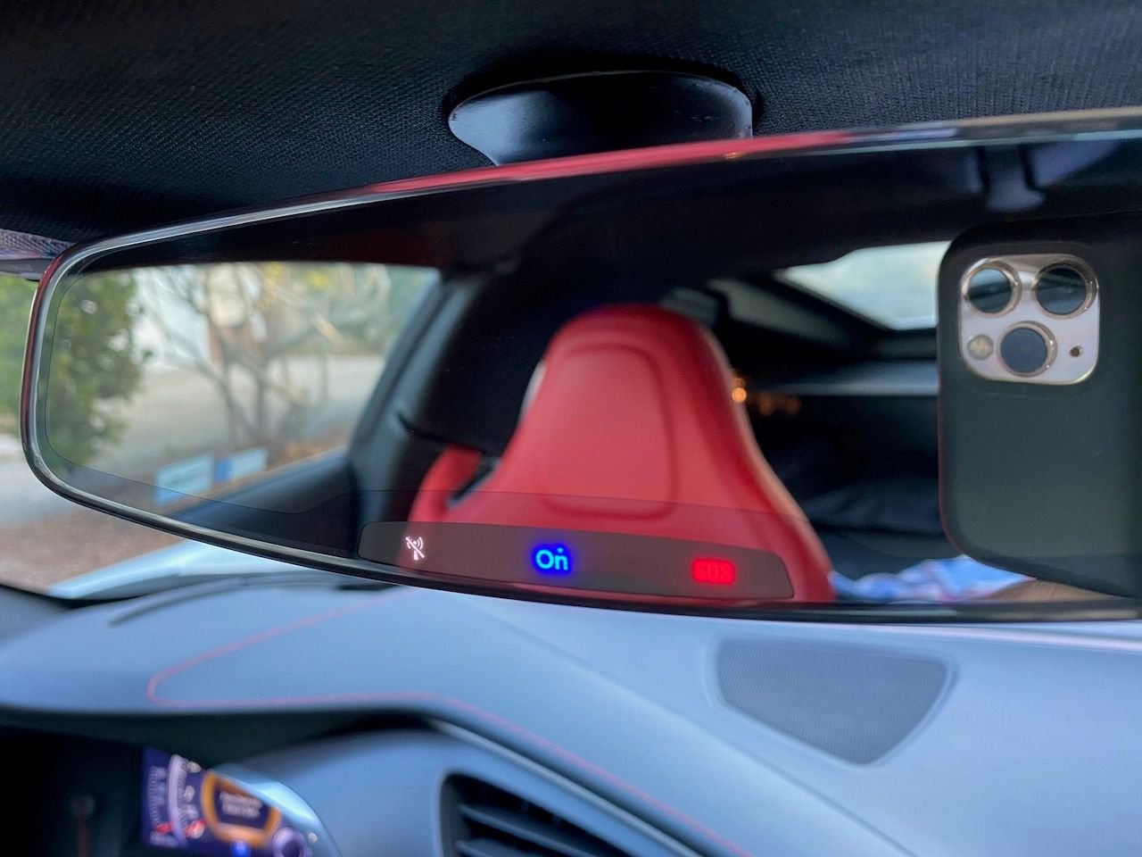

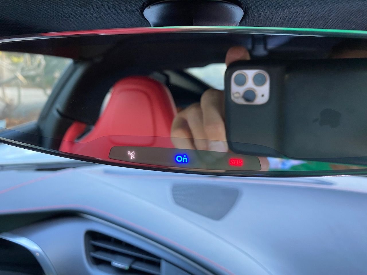

It's frustrating that one can spend $80K plus on a Z06 and still get a 1LZ package. Stuff like the buttons on the sun visor, navigation, and autodimming rear view mirrors should be standard at that price point; right? Well I did change out the sun visor to get the buttons. I did get a replacement mirror and changed it out and am working on the PDR with navigation. I had read all the posts on the mirrors I could find but none were quite all the way there to show me what I needed to do. So I thought I would posts some install pics to help clear the subject up and help others. I took a lot of photos of the old mirror to show the similarity between the new and old mirrors. Also note that you do not need to be 90˚ off to insert the mirror frame into the receptacle on the car. It's more like 45˚. Just make sure its nice and flush before you twist. I used a drift punch pushed through the holes that secure the plastic front cover onto the frame. be careful not to use something so long that you could contact the windshield and scratch it.

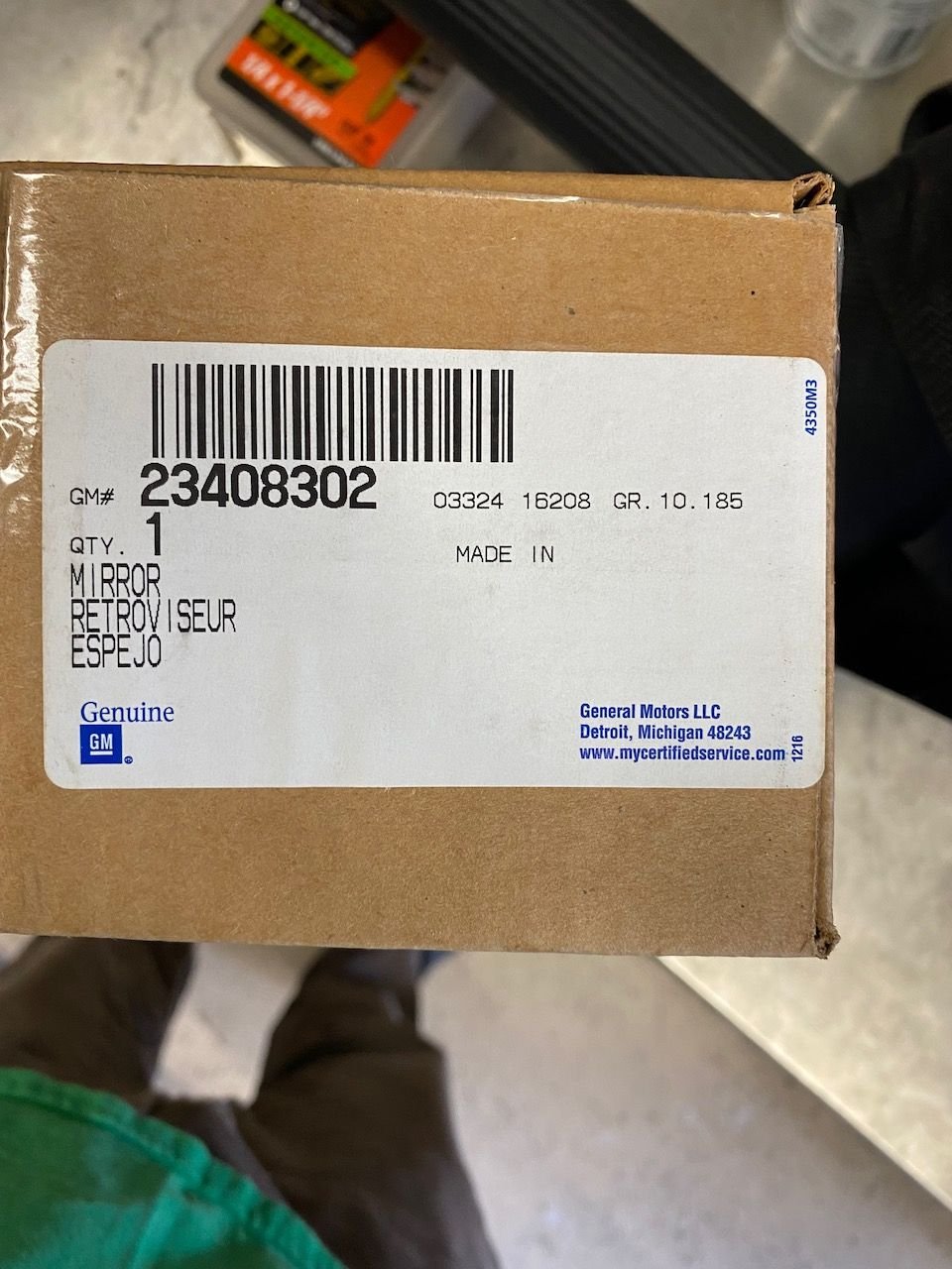

Oh, and I ordered my mirror through Cultrag parts.
This is what you need to order...
Its a lot easier with a little leverage and I used a drift punch.
Ignore the selfie
Happy to see the OnStar buttons work
