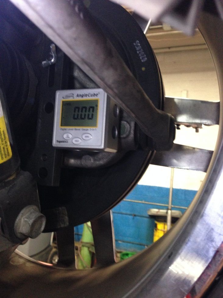

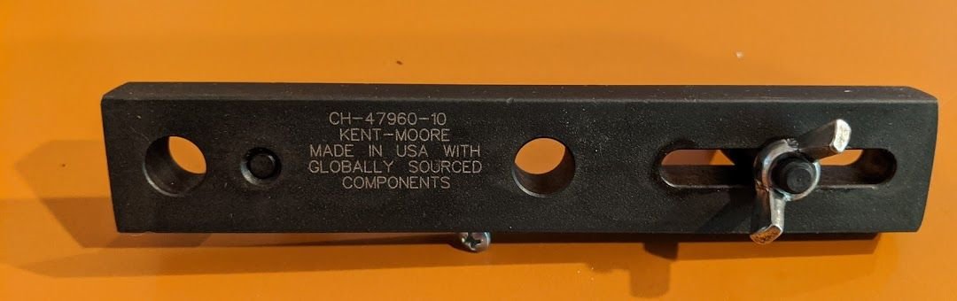

Tools needed for rear caster adjustment.

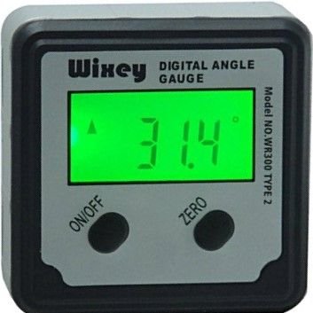

Alignment Machines can not measure rear caster. They need tools to check and adjust rear caster.

^^^^ True. Folks will probably have to get their own pieces to carry to someone willing to spend the time to do it right. Both pieces (two different sources) can be gotten for around $300 or so. Then find someone that is willing. Forget dealers. They just look at you like, "What do you mean rear caster?" Independent shop is best shot. Again, GM leaves their buyers hanging without ensuring we can maintain the vehicles correctly. Of course this is only one issue with GM.
