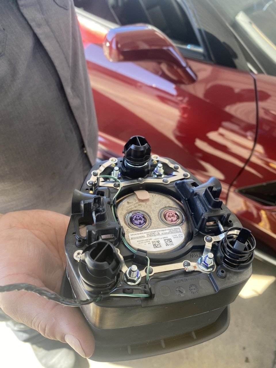

The car is finally fixed. I sent a pic of of the back of my airbag that the dealer sent to me to my tuner. The dealer said it was missing 2 of the 3 springs. I asked the tuner if he had the springs. He didn’t. The dealer wanted to sell me a new airbag for $800.00. Oh hell no. Who knows where the air bag parts went. I’ll figure that one out.

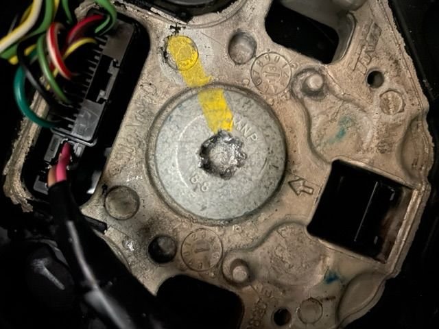

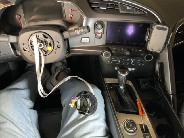

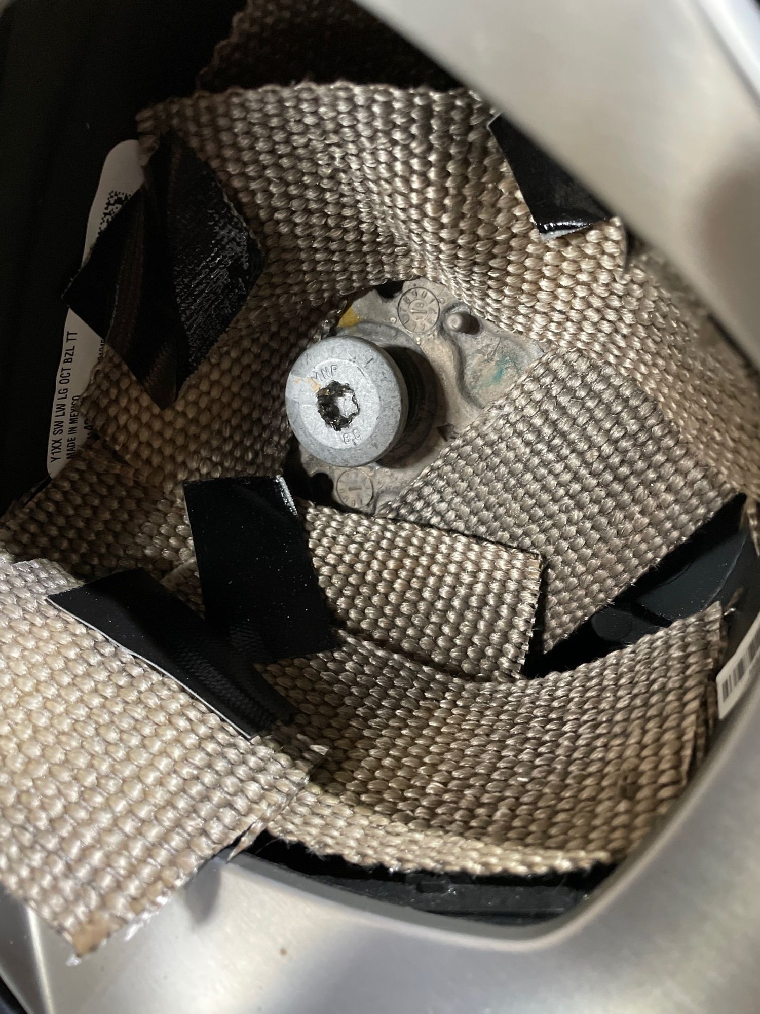

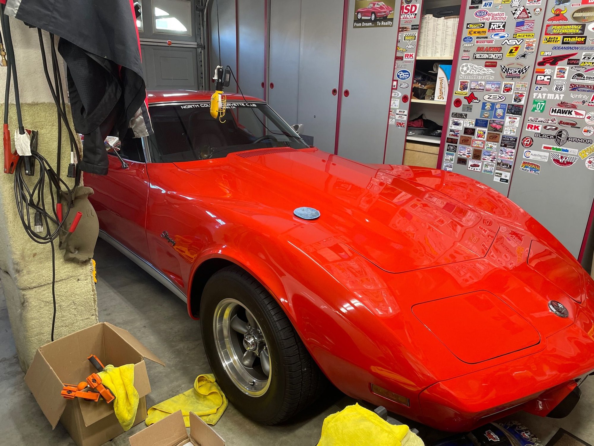

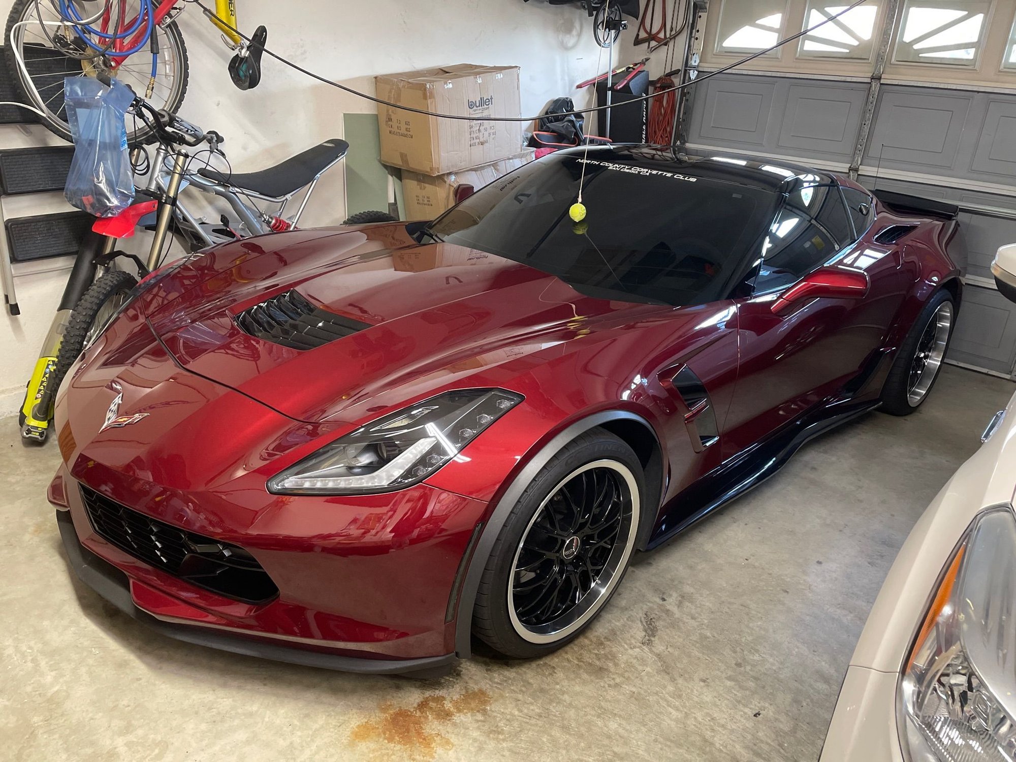

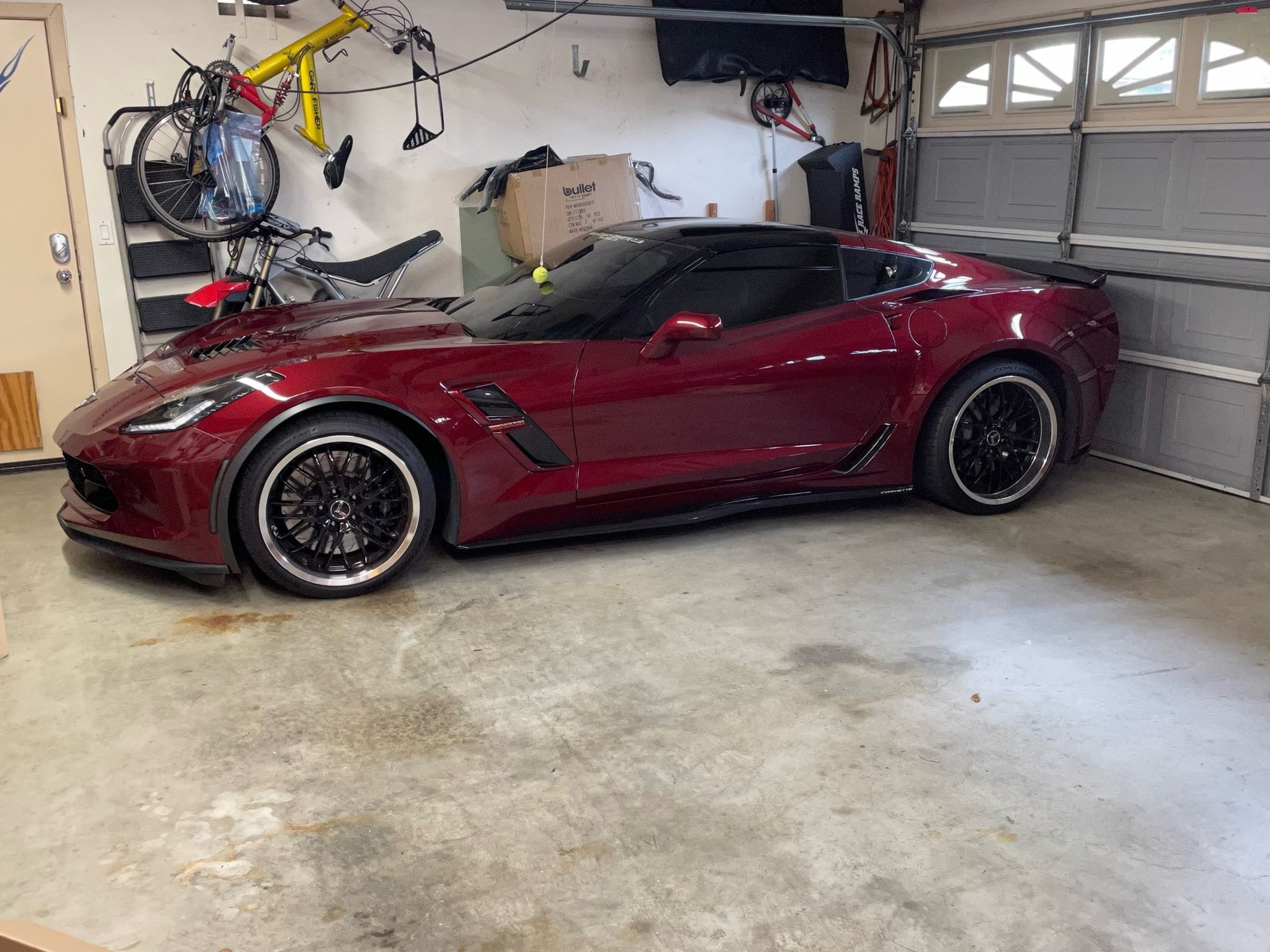

Originally Posted by vetten76
I got blown off by my guy so I’ve no choice than to go to the dealer. God this is fun.
Here’s my mess. All for a $400 steering wheel. Lol.
This is the 19. A/C is the last thing to fix. Might be electrical.
I actually got this bolt out, screwing everything along the way!
Ya can’t put this back together.
They told me there should be 3 springs. I can’t find a picture to verify. Are the springs for the horn or the airbag.
No clock spring on the 76, thank god.

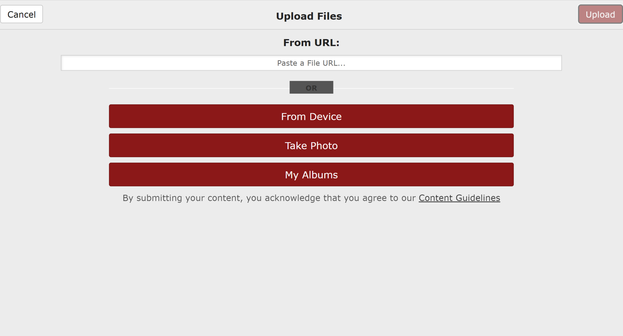

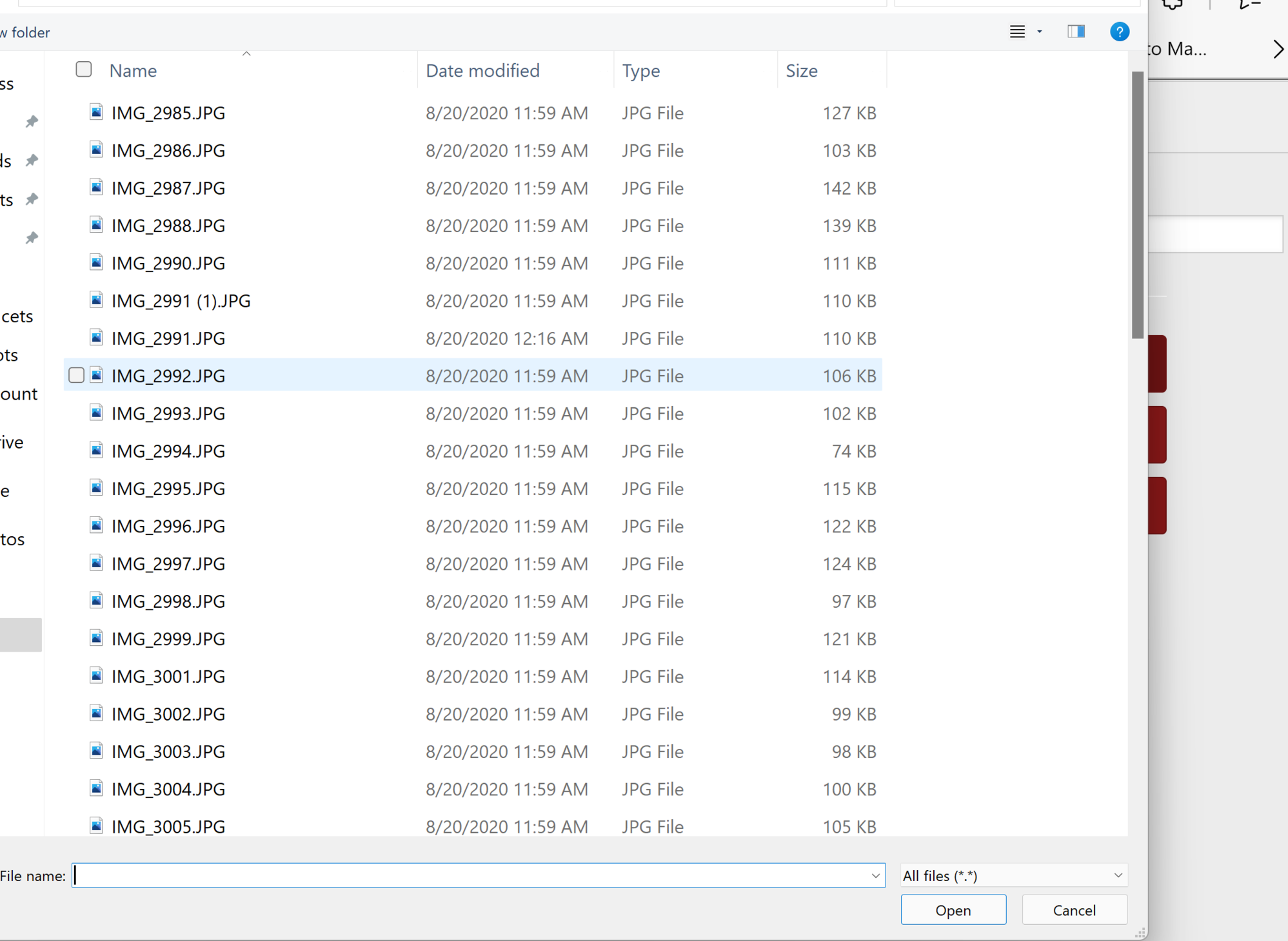

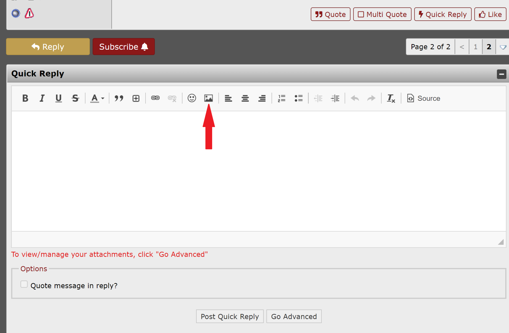

To post pictures from your phone email them or transfer them to your computer and file them somewhere you know where to find them. Then click the landscape icon at the top of the entry box as shown by the red arrow in this picture:
That will get you a display that looks like this:
When you click on device with a windows pc you will be able to go to whatever disk drive or file location you stored the pictures and click on them to upload to the forum:
Clicking on open brings them to the second page where you can rearrange them if you want and then clicking on upload shown on the second page will move them up to the forum. Sometimes the web speed or your wifi can slow the image transfer. If it stops use an editor to reduce the pixel count of the picture.

Here is my original problem. Burn the damn thing. Now they tell me I’ve got two springs missing out of three from the back of my air bag. I’m not sure about that. Does anyone know?
Old Apr 28, 2022 | 03:48 PM
  #33
Dcasole's Avatar
Dcasole
Joined: Oct 2014
Posts: 8,673
Likes: 2,728
From: Atlanta GA
Are they talking about the arming pins ?
