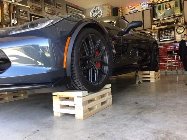

I prefer cribs on all 4...feels "safer" to me
Old Feb 1, 2022 | 10:28 AM
Catfish4818's Avatar
Catfish4818
Joined: Mar 2006
Posts: 4,547
Likes: 5,147
From: Chester VA
Custom-sized for the front and rear...nice!
