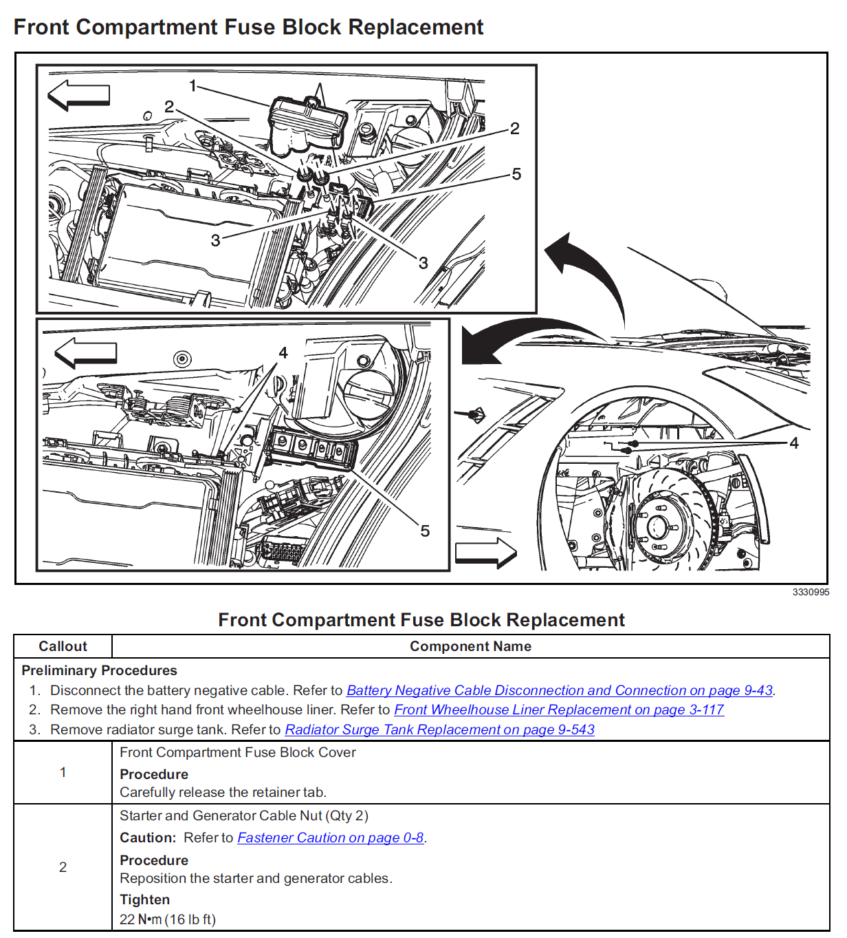

The fuse box looks like it has two handles with swing-release clamps on the front and back ends that would be used to loosen and remove the fuse box, but for what reason, I don't know. Is that clamp and handle setup in place for the the odd occasion when some sort of maintenance requires removal of the box? Maybe there's something mounted below that box that is apt to need repair/replacement at some time?

Access to that side if much easier when removed (headers, sparkplugs, battery connections, etc.).

Clifftrail is correct. If you plan on doing any work on that side of the engine, you will need to remove the fuse box and it's holder. Once removed, you have access to your spark plugs, headers, etc. The back plug,and back header bolts are still a pain if you don't remove/unbolt the expansion tank and lift it up out of the way.but not necessary.

What's involved in removing the fuse box? I have no need to do so; I just like learning how things come apart and go together on my cars.

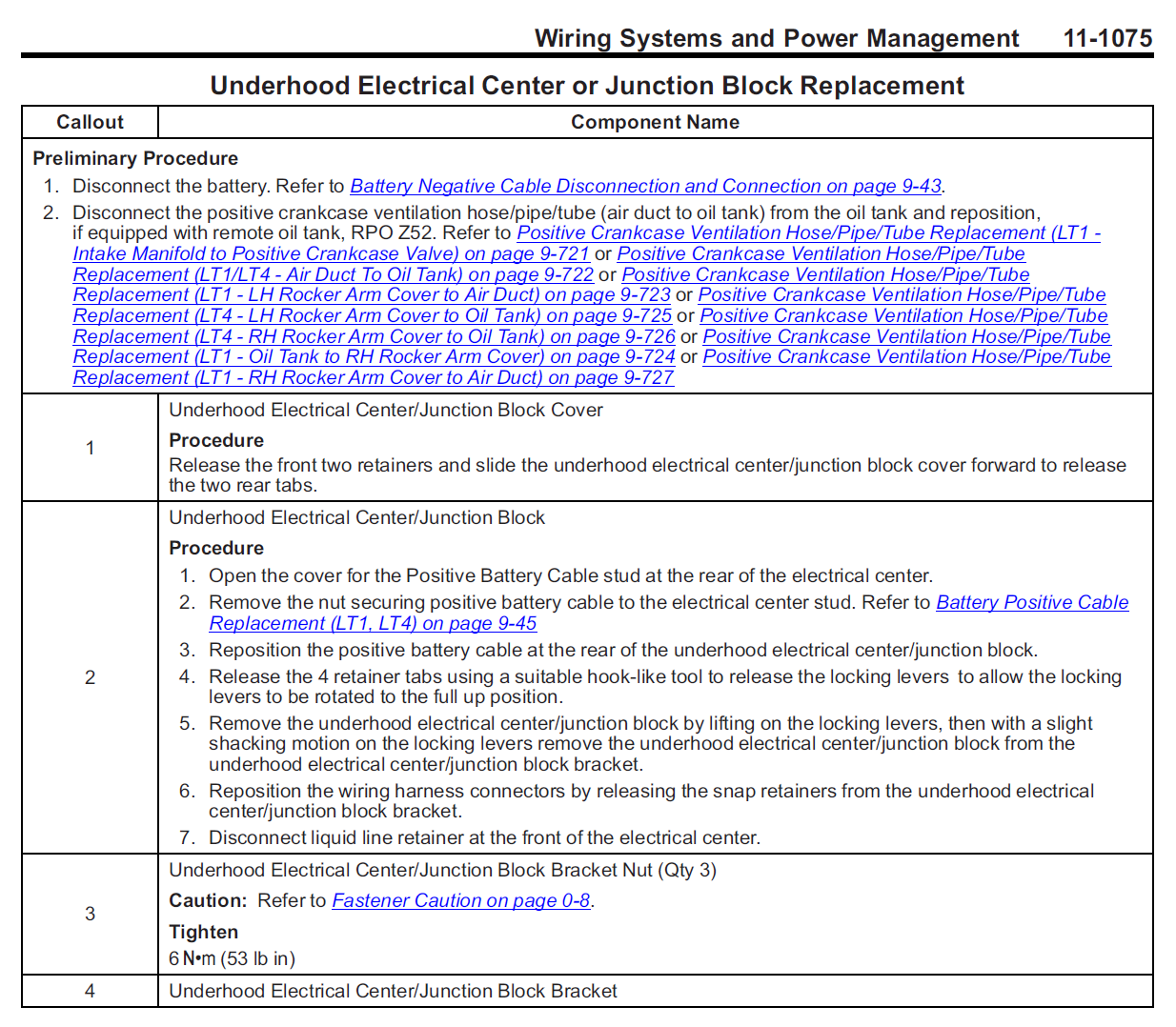

Bill

Well, there I have it; thx! Can't get much more accurate or detailed than the service manual; thx for posting.
That doesn't look like the most straight-forward R&R; glad I have no immediate need to do anything of the sort.
