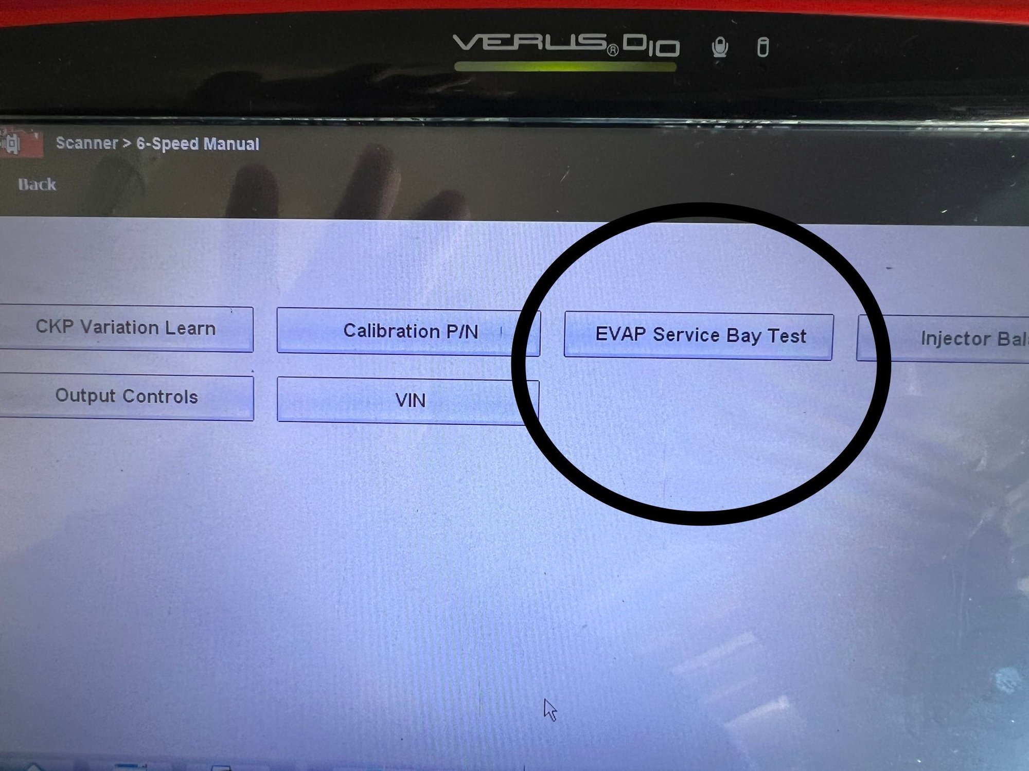

The EVAP monitor is the hardest one to show ready…with a higher level scan tool one can do a “service bay test” which takes about 5 minutes…if not there are a few parameters that have to be adhered to…level of gas in the tank, high or low ambient temps will not make it run, ECT…every time the battery is disconnected all the monitors will have to be run and if some DTC’s are current or pending they will not run also !!

A “service bay test” on a higher level scan tool only requires 2 or 3 parameters for the test to run and “forces” the test to run…the scan tools to do this have been around for 20 years !!

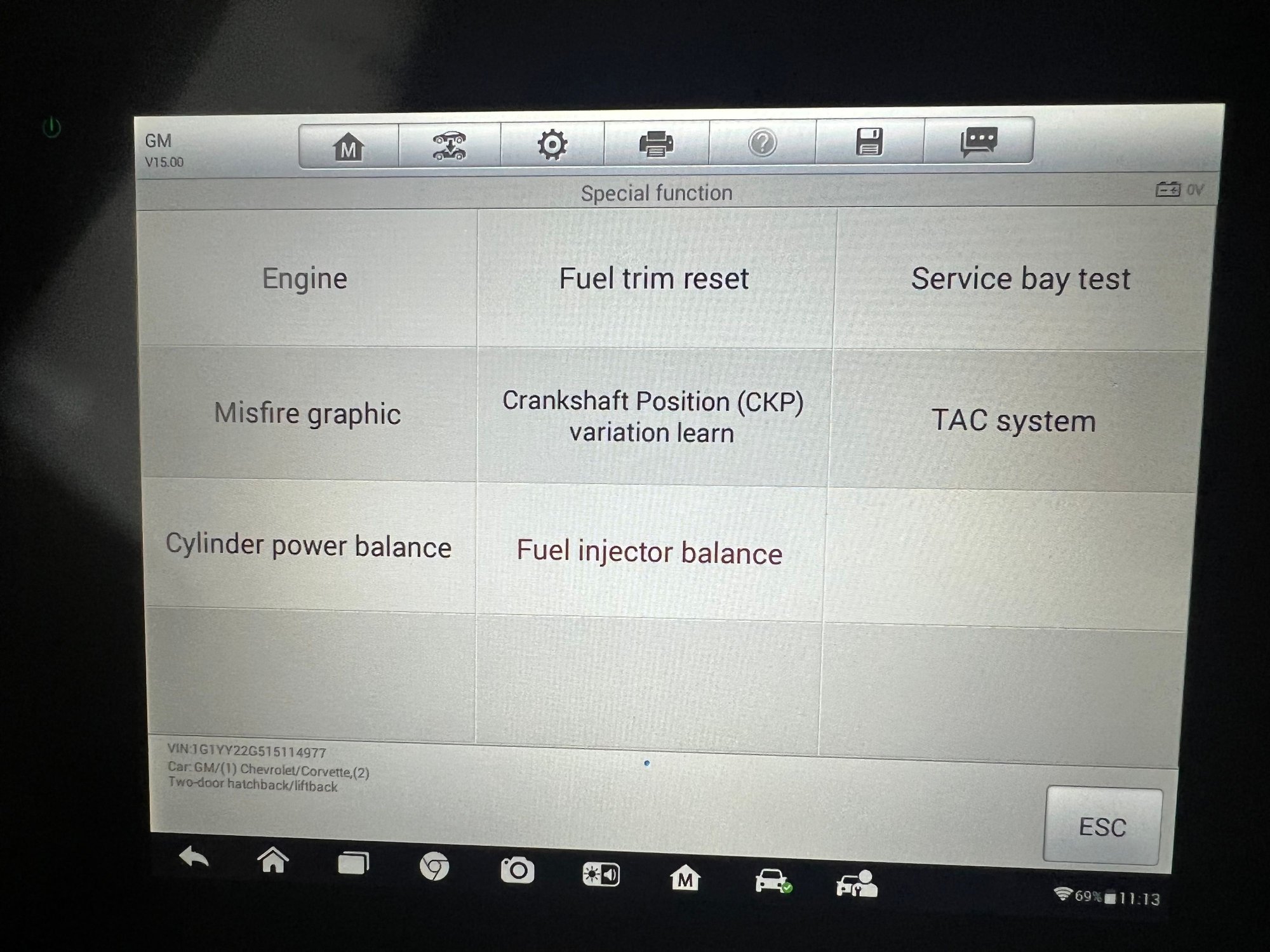

I wish my Autel MX808 had a Service Bay Test feature.
Maybe it does and is just hidden under a different name............

I have an Autel MS906 so I’ll look and see where it is !!

You would go to Powertrain-Special Functions- Service Bay Test !!

No joy.
Either my unit a MX808 does not have this function or it is hidden quite well.
