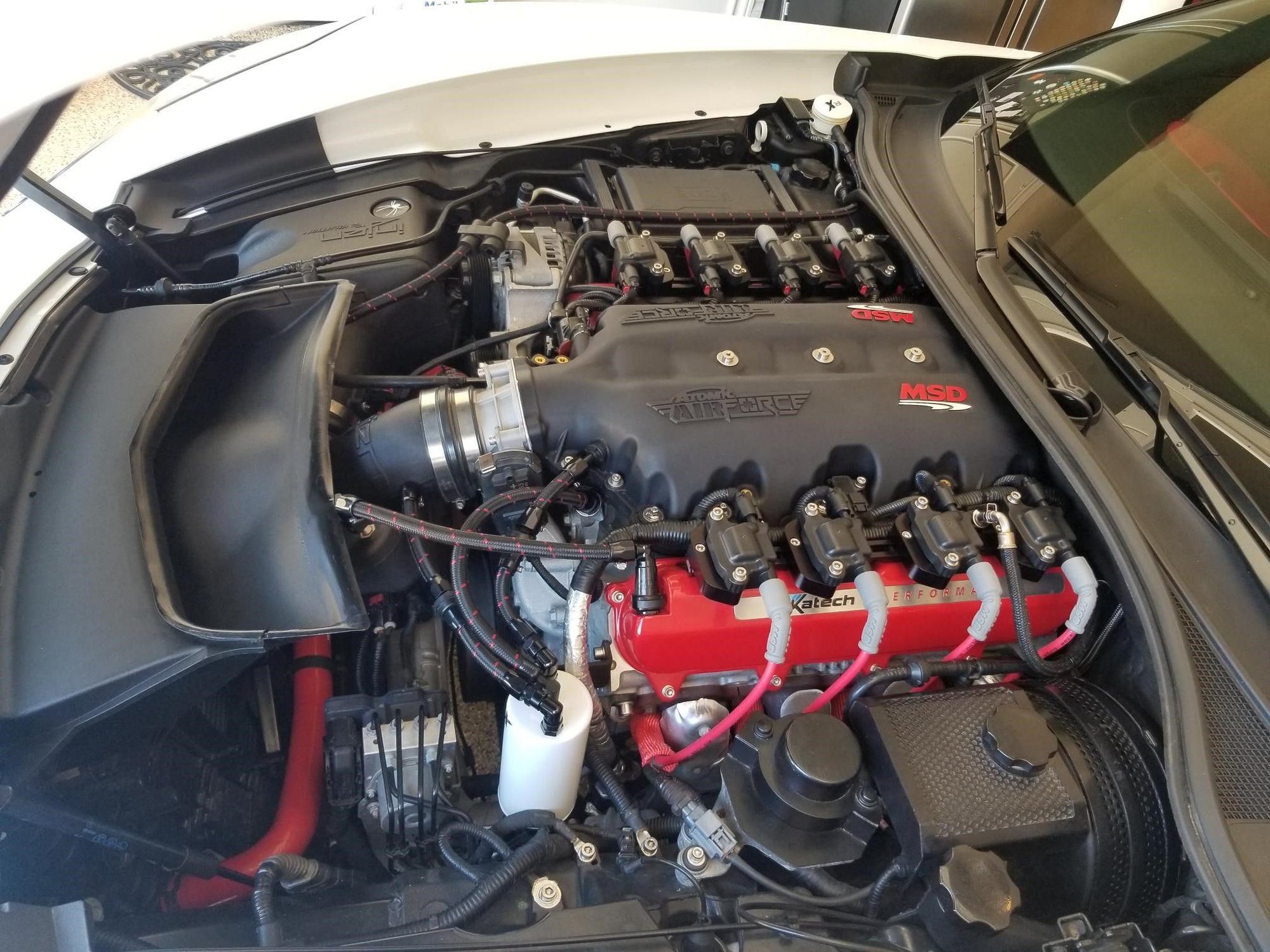

I did the flex fuel sensor on my NA & love it. CAI, ported TB, ported MSD Intake, Kooks 1-7/8 LT's w/ X-pipe & tune added 85+ hp. on e-85. I'm at 486hp at the wheels spinnin' on the dyno. Added a Fuel-It ethanol sensor to monitor the E content & I'm running 70% E pretty consistently. Best $230. for hp gain I ever spent. I did some other stuff, but pretty sure it didn't affect HP gains. (Wires, plugs, coils, etc.)
