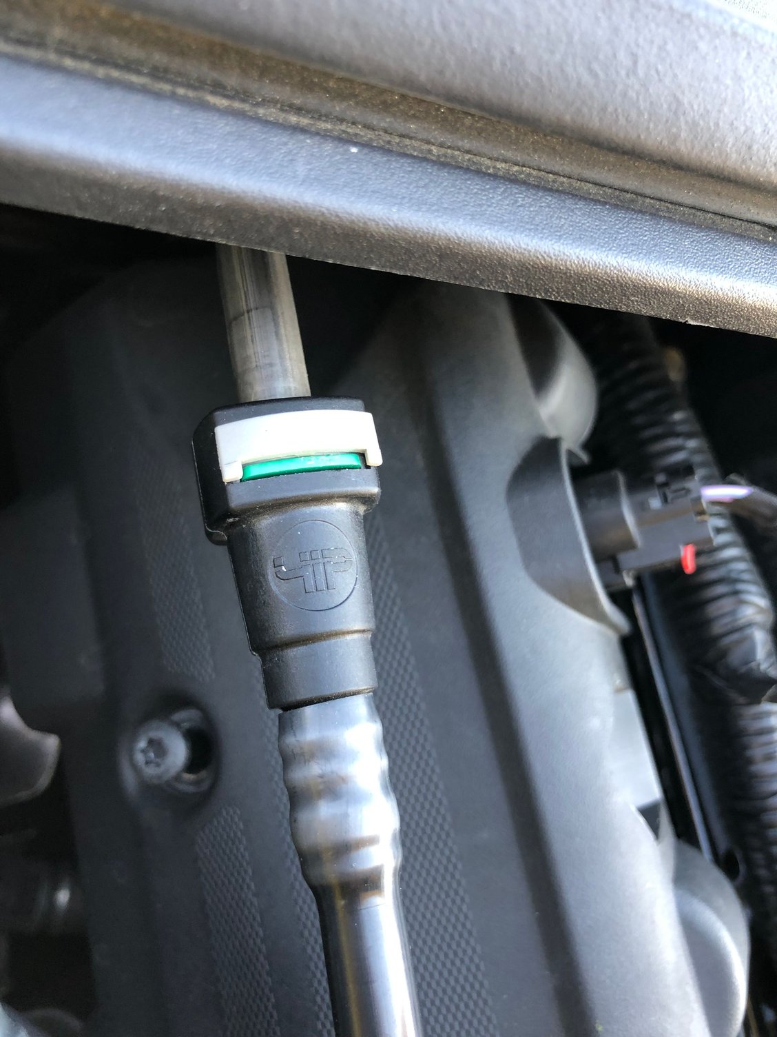

I guess I am an idiot because I can’t get this quick connect off. Seems to go to the throttle body . Tips? Thanks

You push in on the grey piece of the connector and while doing so can pull off the line. Sometimes it gets a little stuck around the oring. You can spray a little wd40 through the backside if you want.
