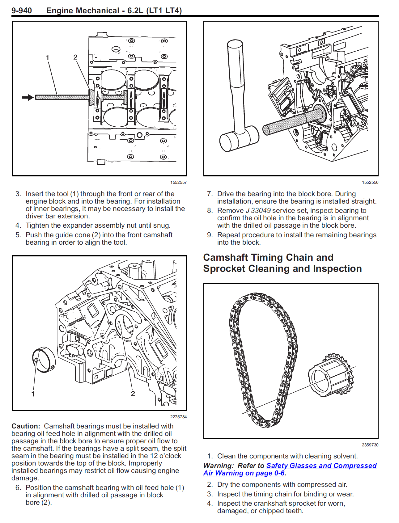

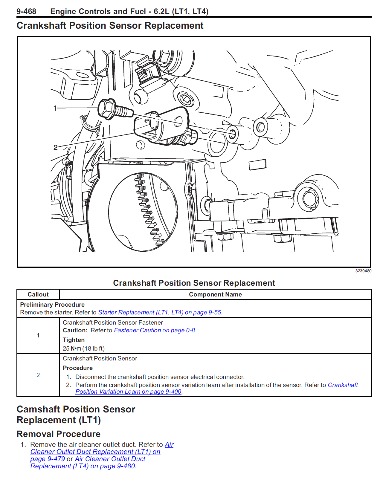

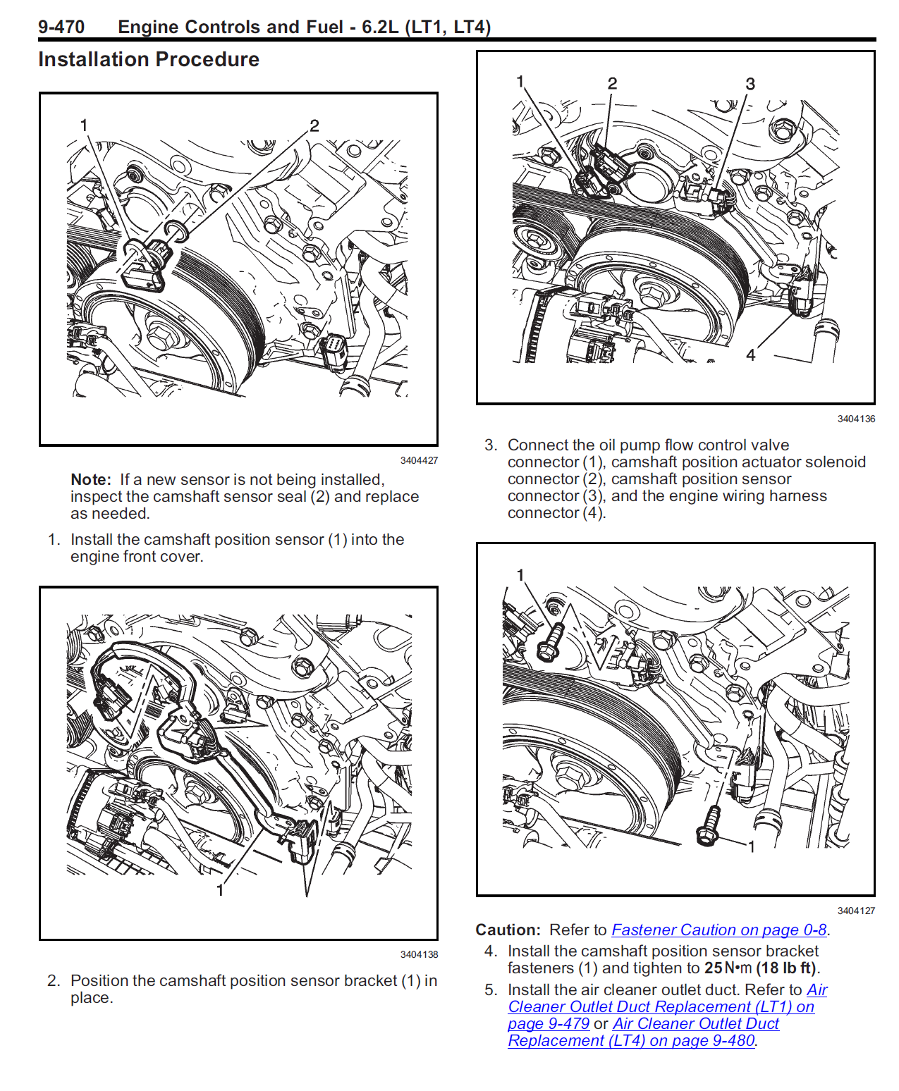

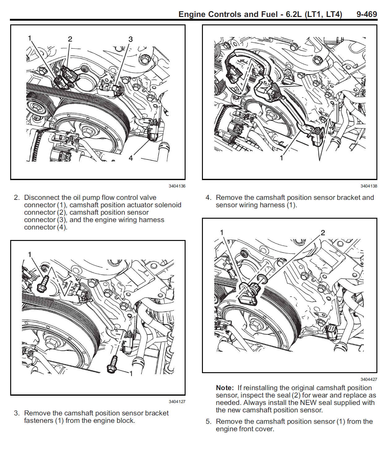

Here are several more pages linked in the diagnostic procedure that people requested:
9-468
9-469
9-470
9-471
9-472
9-940
9-941
9-942
9-943
Bill

Have to pull the starter to get to the crank sensor. But typically I've had more issues with the cam sensor on the front right middle are of the front cover. My tach wasn't responding correctly and the car stumbled and ran like hell. Turns out the bolt wasn't fully seated the cam sensor was out just a bit (like a 1/8") and that's all it took. Course I have an LME front billet cover but the same would apply with factory cover. The cam sensor is easier to replace and cheap. I would go that route first. Easy to swap. Check harnesses also make sure they are seated and no contaminants in or around the connections.
it's a bit weird b/c my codes were pointing to crank sensor issues but again it turned out to be a cam sensor issue. Best of luck to you! Bill good stuff with service manual print outs. I have the USB manual as well if you need more info.
