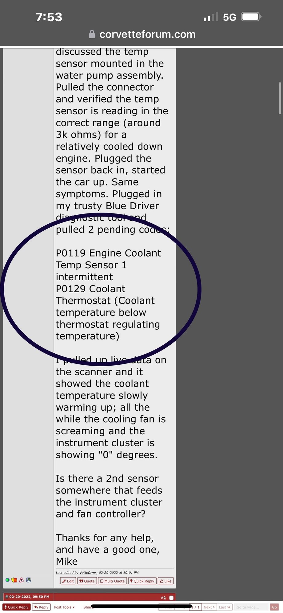

Hey, folks, I need some help. Today while driving home the coolant gauge in my '14 dropped to 0, and the cooling fan came on full speed. Switching to the Tour panel display in Performance mode showed 0 degrees engine coolant temperature. Everything else is normal, including cabin heat. Coolant level is correct. On shutdown the fan continued to run, but I was able to shut it down by starting the engine (which apparently shuts off everything not related to starting the engine), then immediately shutting down.
ETA: I then cleared the codes (engine off), restarted, and the codes immediately reasserted themselves.
I went digging through the CF archives and found threads that discussed the temp sensor mounted in the water pump assembly. Pulled the connector and verified the temp sensor is reading in the correct range (around 3k ohms) for a relatively cooled down engine. Plugged the sensor back in, started the car up. Same symptoms. Plugged in my trusty Blue Driver diagnostic tool and pulled 2 pending codes:
P0119 Engine Coolant Temp Sensor 1 intermittent
P0129 Coolant Thermostat (Coolant temperature below thermostat regulating temperature)
I pulled up live data on the scanner and it showed the coolant temperature slowly warming up; all the while the cooling fan is screaming and the instrument cluster is showing "0" degrees.
Is there a 2nd sensor somewhere that feeds the instrument cluster and fan controller?
Thanks for any help, and have a good one,
Mike

Old Feb 20, 2022 | 09:50 PM
