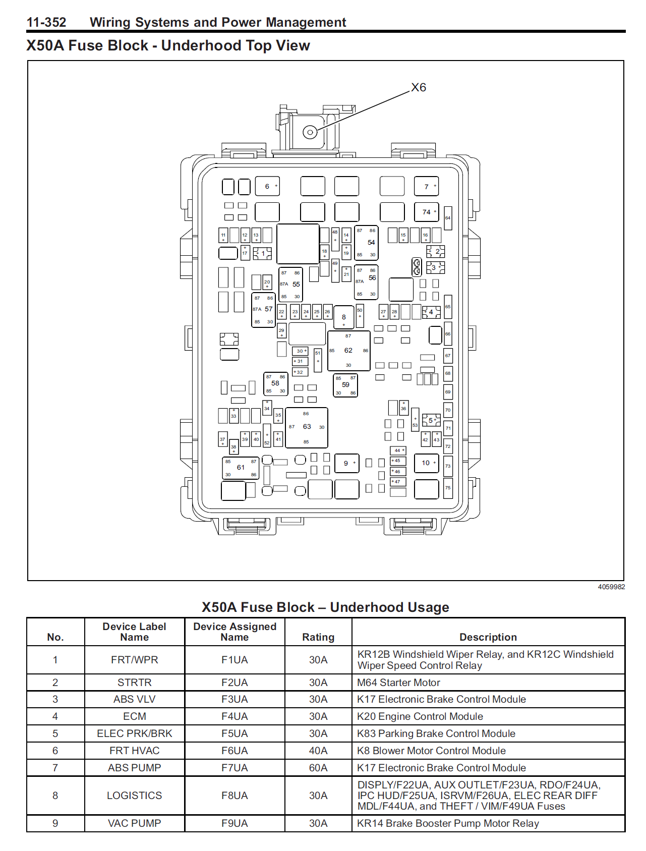

That fuse box is not the same as my 2014 Stingray. Similar but different.

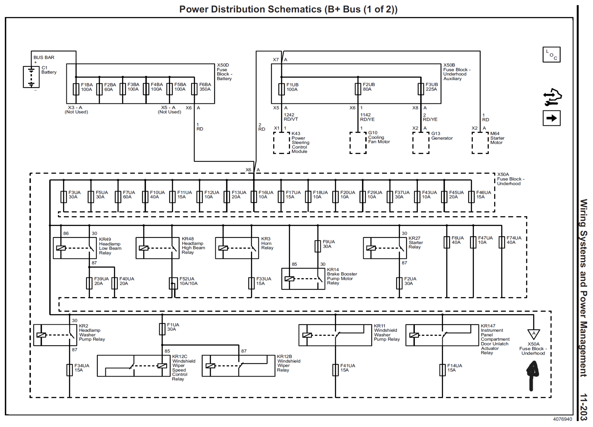

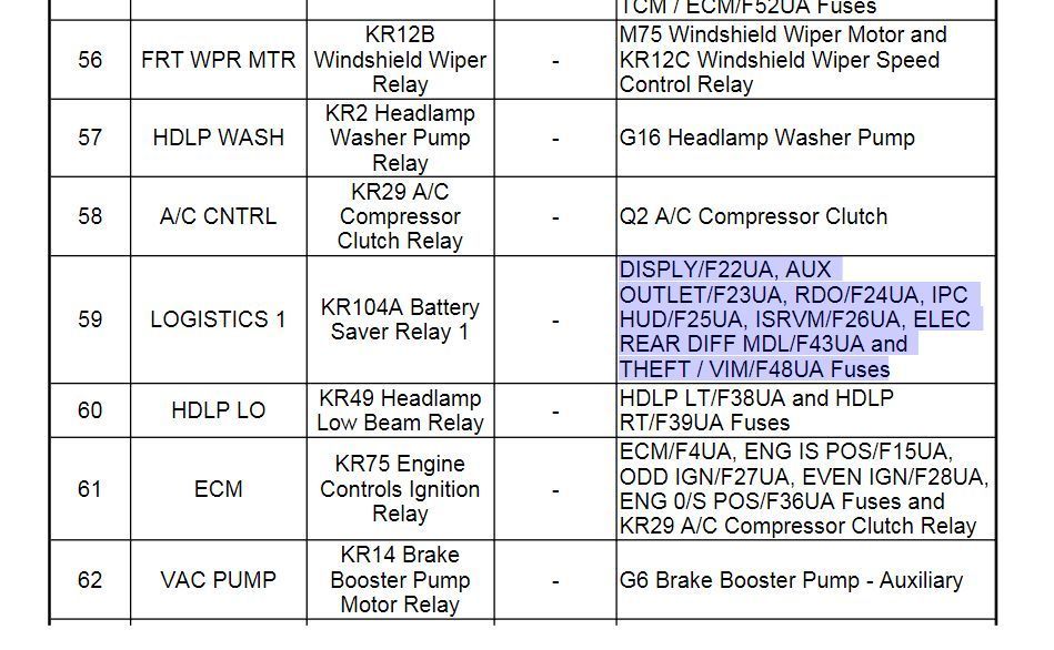

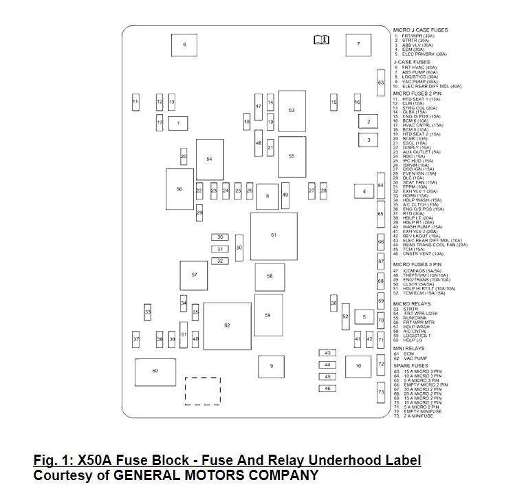

This is my fuse box. #59 Logistics 1 latching relay.

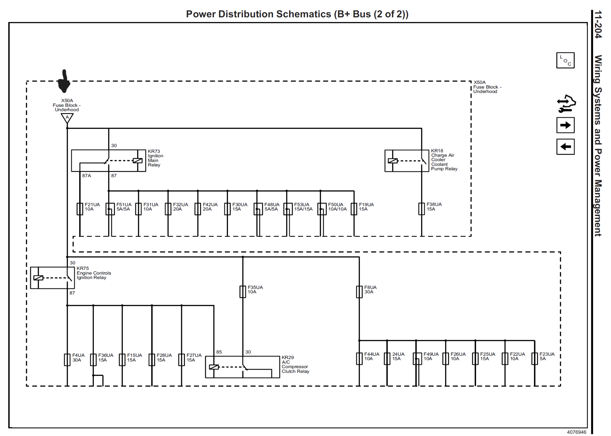

Old Mar 7, 2022 | 10:01 AM

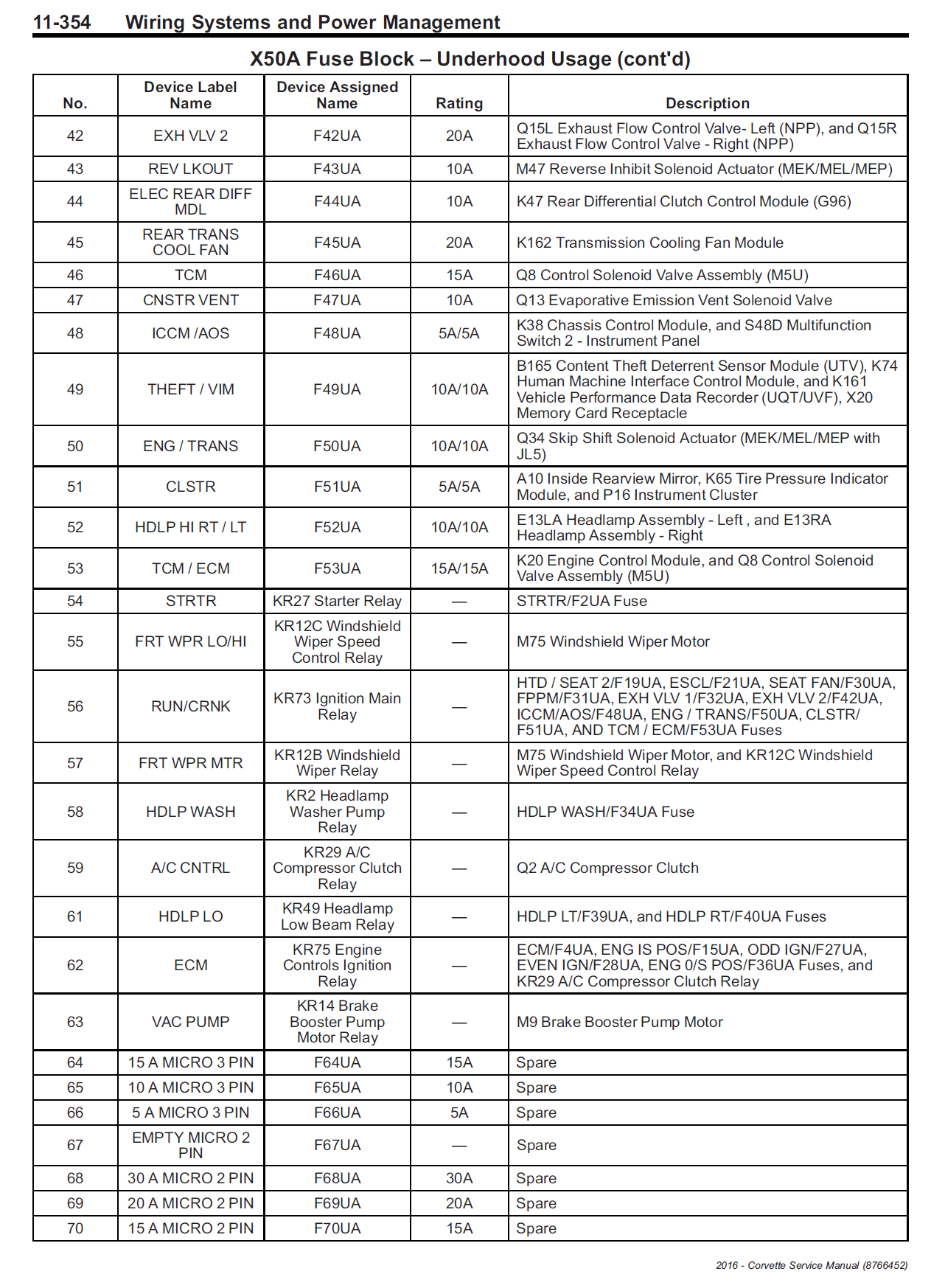

Old Mar 7, 2022 | 10:02 AM
roppa440's Avatar
roppa440
Joined: Jun 2016
Posts: 67
Likes: 7
From: Newcastle Upon Tyne
I have no idea what most what I highlighted there means....
