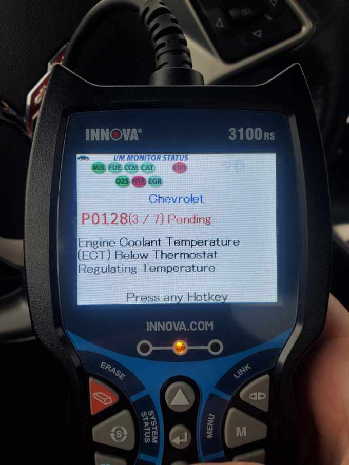

Hello all, and thank you.
A/C isn't working so it goes to the dealership, they claim to fix it. A day later I can hear a hissing from the vent (video linked) compressor is turning but other than visual I can tell it's operating. Today the wife drives it to work and she calls because the radiator fan is constantly running, I have her hook up the code reader and sure enough 7 faults. One is an ignition coil and the other the thermostat. When I get home I mess with it, engine temp is reading 0 but for the first time there's no hissing in the AC vent and you can tell the compressor is kicking on. I hook up code reader and only the coolant temp is there now, I clear the fault and Temps come back online but the hissing noise is back. I've linked a video, if you could please provide your thoughts I would appreciate your time.

It might be helpful if you shared the other six codes.
C2233 (twice), B3E27, C0D70, C2200
Chevy said they're generic codes and theyre gone and not stored. Thanks.

Diagnostic for P0128 says to check the connector at the temp sensor to make sure the contacts are clean and make contact. A low-temperature display can indicate the sensor contacts need cleaning or maybe the sensor is disconnected (The contacts are susceptible to corrosion). It could also indicate a bad sensor but I think there is a good chance that while somebody was under the hood working on the AC something else may have been bumped.
Bill
Thanks Bill, I'll give it a shot. Seems to have been fine sense but I'll check it out to be safe.
