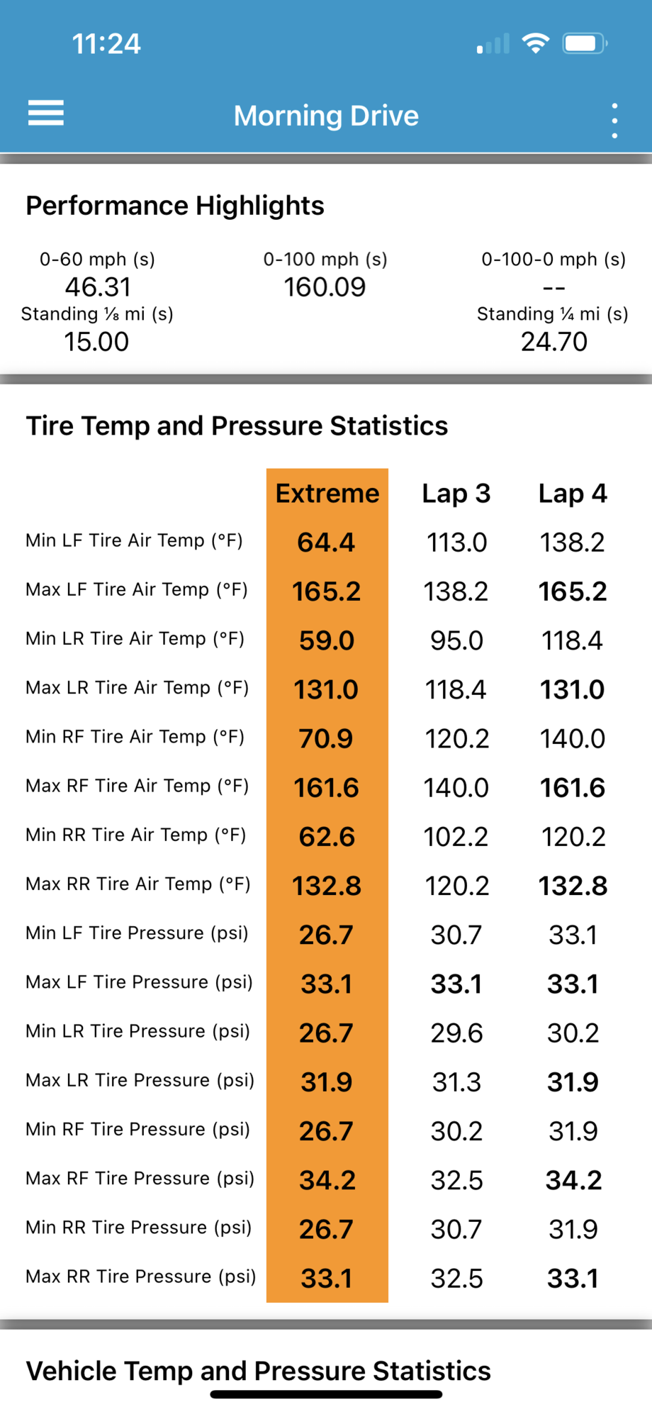

Why are your cold rear pressures so high? Hell all of your pressures are way too high. Try 23-24 all around next time. You probably cooked the tires though. Target hot psi for pirellis is 29-32 depending on fast-but-high-wear or a little more longevity.
I bet the rears were sliding. Check pdr tire air temps on cosworth and see what shows. Rears should be way cooler than fronts.
for time trial type of event here is how mine turned out for a few hot laps. This is about a 10 minute long run . Cold psi this day was 24. But it was a cool day and I needed to get up to speed in 1 lap so I didn’t want too low of pressure. For HPDE I’ll often start at 22-23
