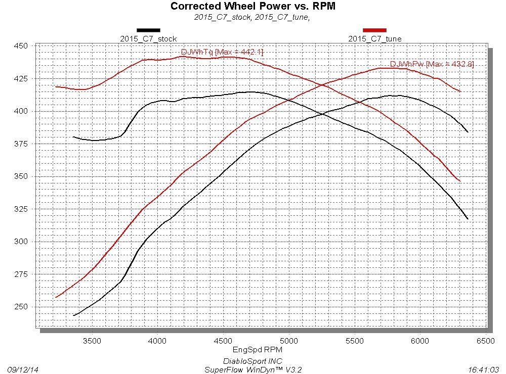

What should I expect to gain with an LT1 that is stock? I would think low to mid range is more important than WOT?

Heres a copy of the dyno chart from a 2015 LT1 we tested here with our 93 octane Diablo tune.

I like how the Diablo tune puts the HP and torque at lower Rpms so you can use it

You will definitely get more low to midrange than peak HP as demonstrated above.
