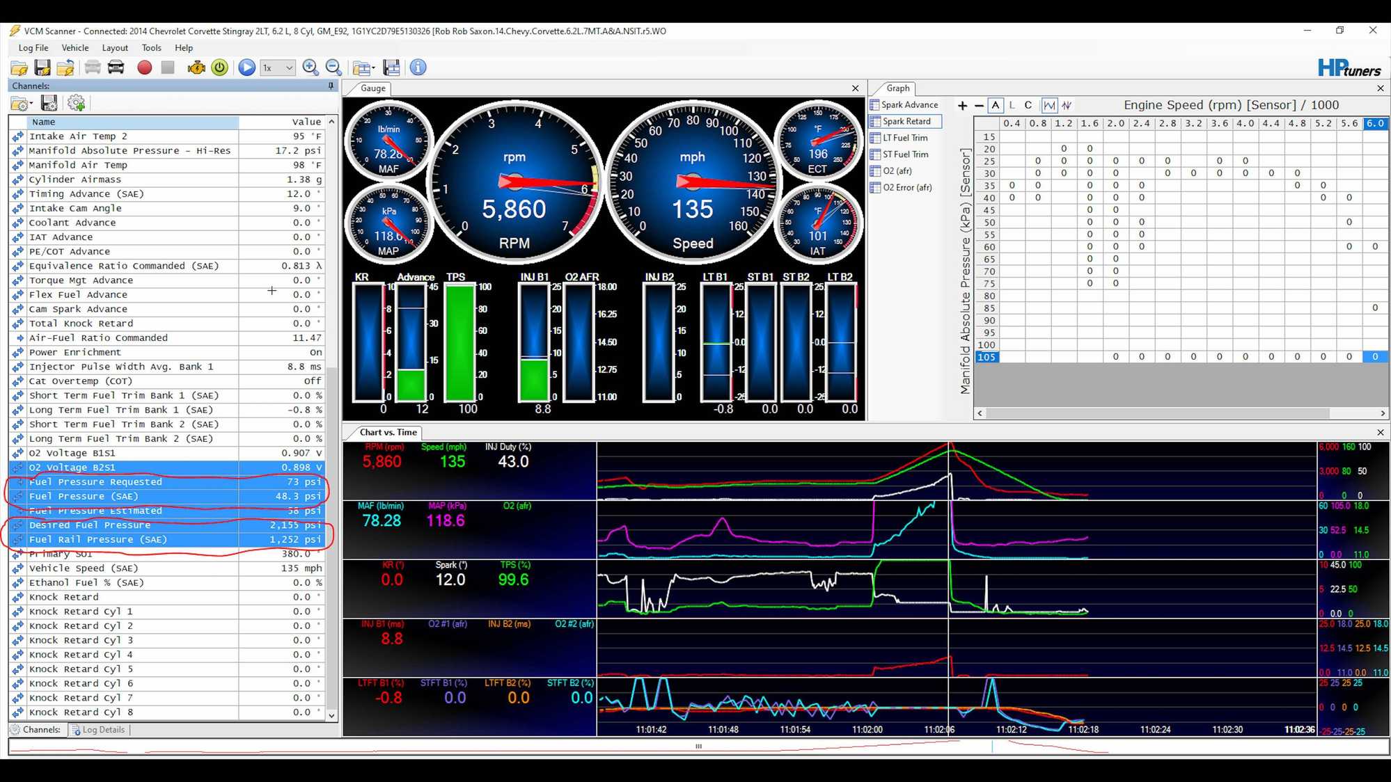

I took the car to the dyno and it was running out of fuel on the top end above 5200 RPM. The car made 598 RWHP and 579 TQ with more in it but the fuel pressure was dropping on the lpfp to around 48psi and the hpfp to 1250psi. They backed the car down to 560/577 and told me i need to upgrade to LT4 fuel system. Does this sound right?

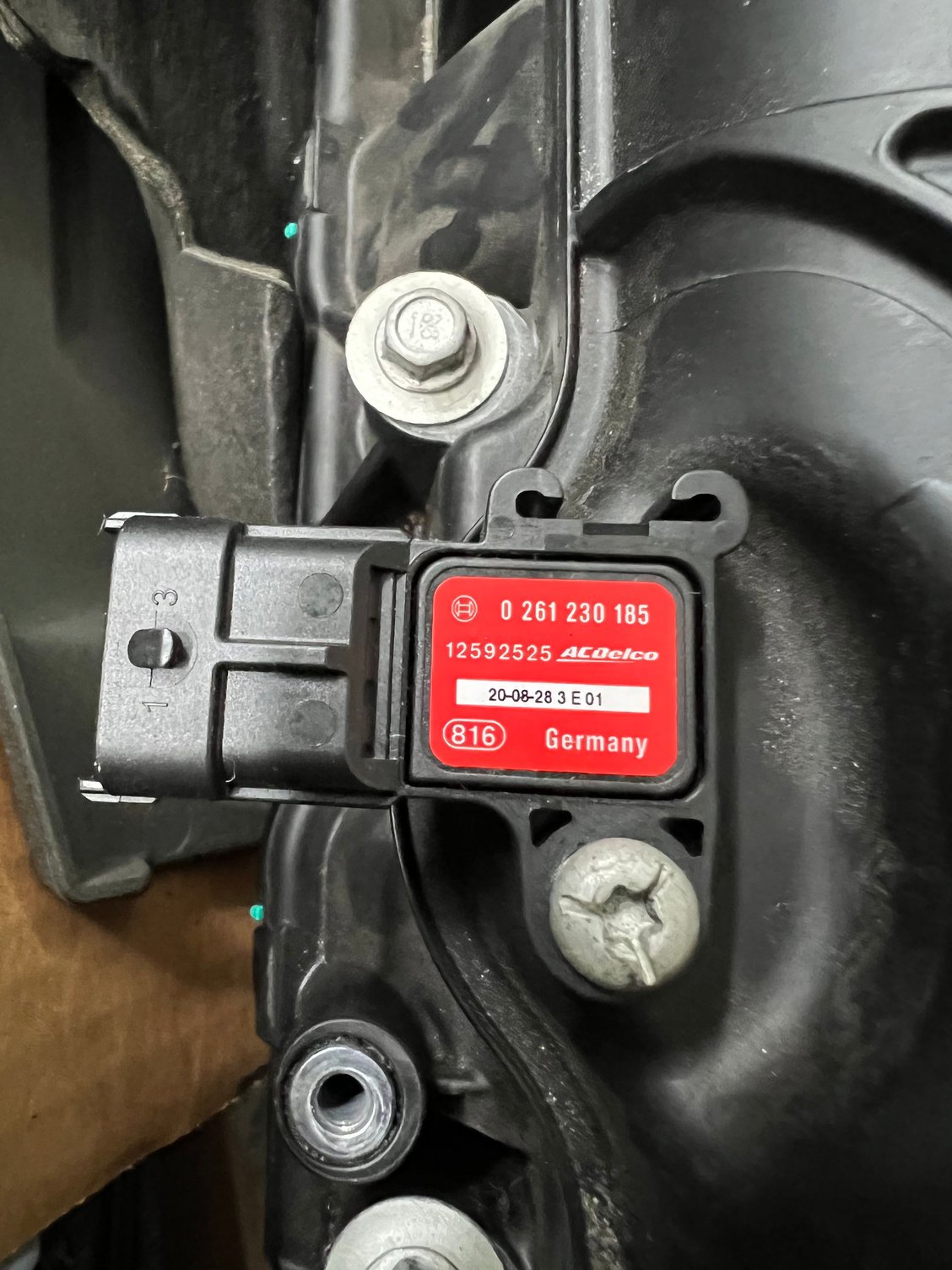

This is the MAP I used. Didn’t replace IAT.
