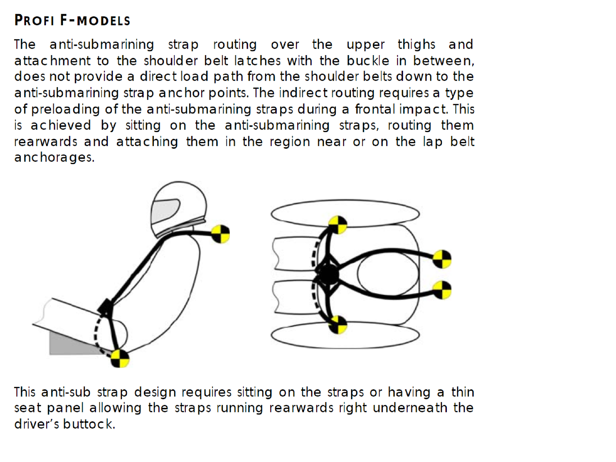

The BK belt anchors for the C7 were originally described as providing sufficient room to attach both lap and sub belt clips thus permitting the Formula Belt Installation that used to be described in the Schroth Competition Instructions. When I had trouble attaching sub belt clips in the mounting holes along with the lap belt snap clips due to the small diameter of the hole I called BK and they told me they didn't support that usage anymore and the description on the website has changed.
I have run my C7 with both the lap and sub belts attached to the BK mount but the snap clips fight with each other and can under certain circumstances pinch the skin on the side of your hips. This usage means you sit on the sub belt and they sort of loop around your legs similar to the way the Team Tech Jet Pilot Harness does.
https://www.sfifoundation.com/wp-con...2006-05-12.pdf
The Schroth Profi F (Formula) Model is a more accurate description of how the belts are mounted using the BK mounts.
