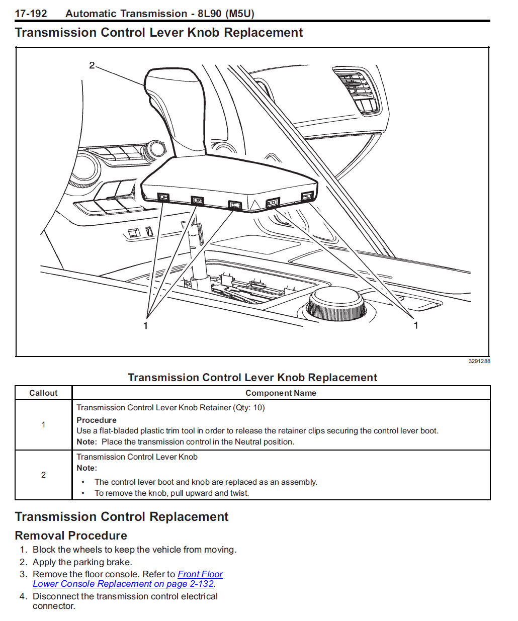

It looks like it is completely replaced as a module. No more signal cancellation cams in the steering column.
Here is the procedure to replace the column turn signal module. It is hard to capture all of the page links from one section of the manuals to another but I think I have all of them for both manual and auto transmissions. PM me if I missed any.
Bill
Do you have these attachedments as a single PDF file? That is good generic info.
Thanks,
Rob
IF you want to save it to your PC, right click on the image and select a way to save the file. I see 16 or so IMG files that he posted to give the information.
