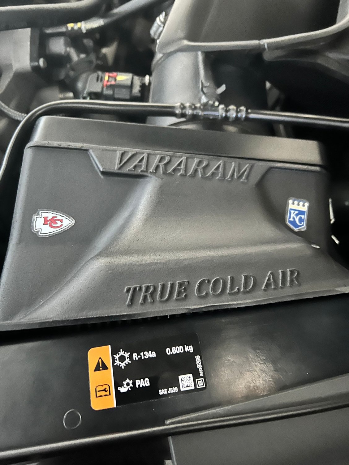

Very similar for me as well. Ported throttle body, Granatelli plug wires, SR-1 x-pipe, Vararam TCR CAI, custom exhaust dumps, Soler TC, untuned right now. Sounds and runs more stout. I’m doing ARH or Hooker mid-length headers (California CARB) and a tune next. At some point I’ll add a supercharger, but I’m not in a hurry. This car is plenty fast for how I use it. Good luck with your build.

Good luck. I don't have a cai as I am not convinced they help on a mostly stock LT1 and I did not want to risk throwing a cel when I am not ready to tune

I have a way I think could change your perspective. Pick up a used Vararam TCR-7. I was not convinced regarding CAI’s either. I’d had one on a previous car. I picked up a used Vararam. Trust me big difference over stock box with aftermarket filter, even on factory tune. I’ve not tuned yet either. No CEL but flows air 1000x better. Less than 30 minutes to install.
