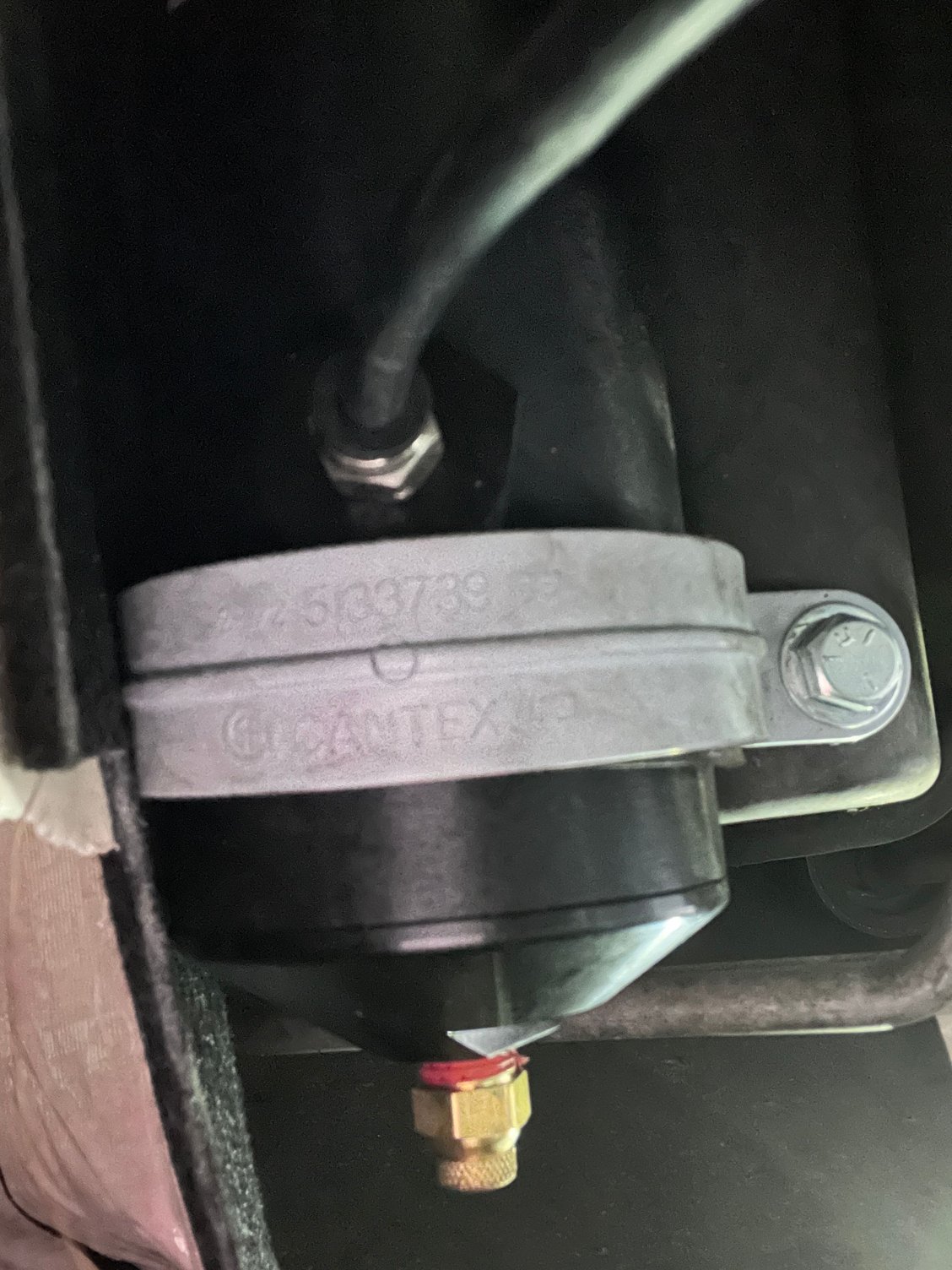

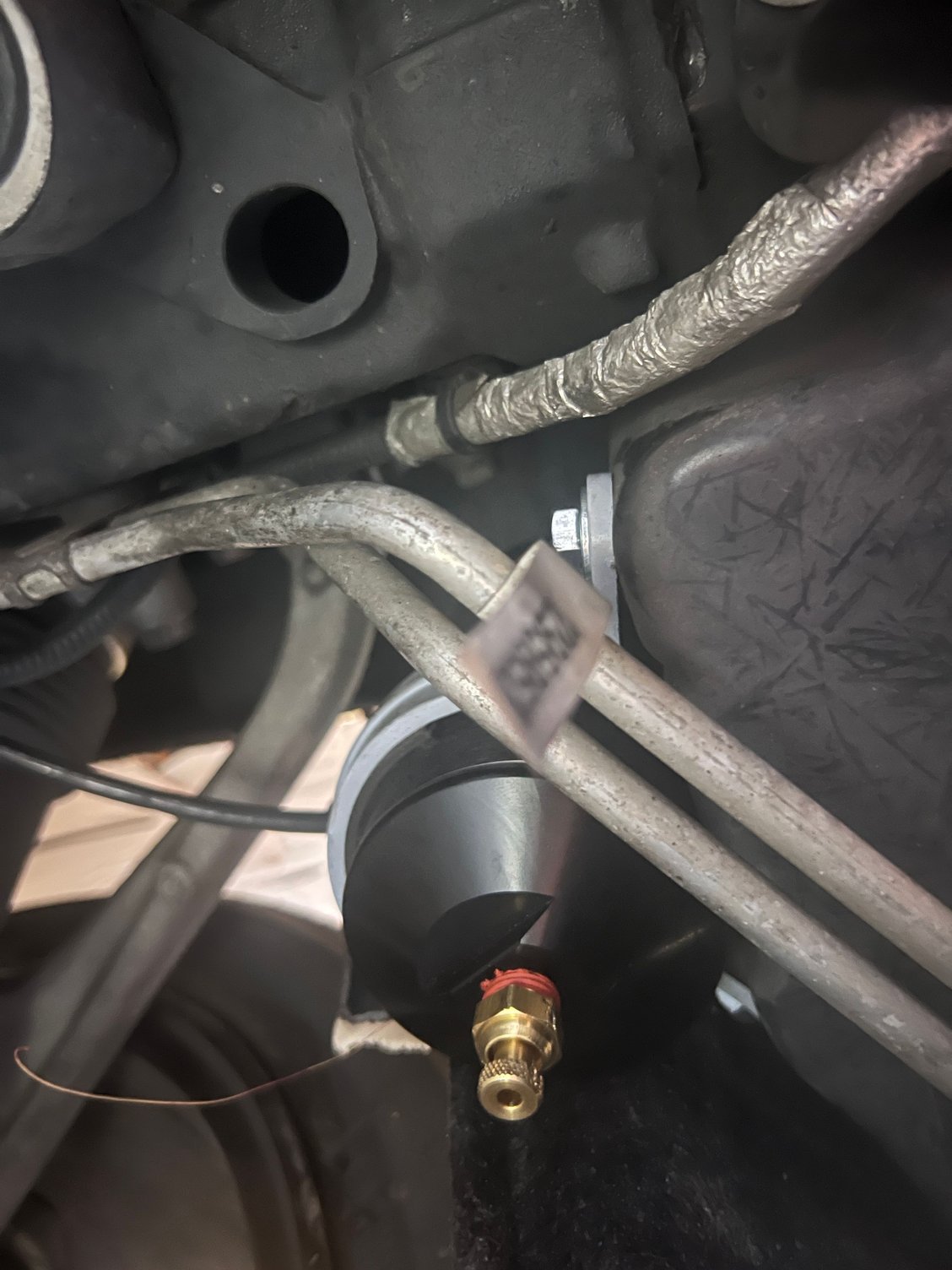

So had a catch can installed by a local Corvette shop. Here's some pictures. Heading out for the track tomorrow so will be interesting to see if there's no more tranny fluid on the garage floor when I get some, or if there's some fluid in the catch can when I go to drain it at my next engine oil change. Will update this thread.
Pictures don't show a lot, but what they did was buy a kit from somewhere, remove the vent from the top of the tranny, drill two holes and tapped them, then installed a metal plate with a 90 degree male fitting on it, then run a hose down to the catch can which they mounted behind the wheel well liner for the right rear wheel. Making it easy to access to drain. The can empties by screwing the knurled nut in clockwise, then back counterclockwise to stop draining.
BTW, the tranny was full when they changed the tranny fluid, so that goes to show that what looks like a lot of oil on the ground, in reality really isn't that much.

Nice detail. However the vent only release when pressure is built up above a certain point I assume? And we don’t know that pressure rating do we? So are you going to be collecting more overflow than needed now that it’s just an open line to the catch can?
