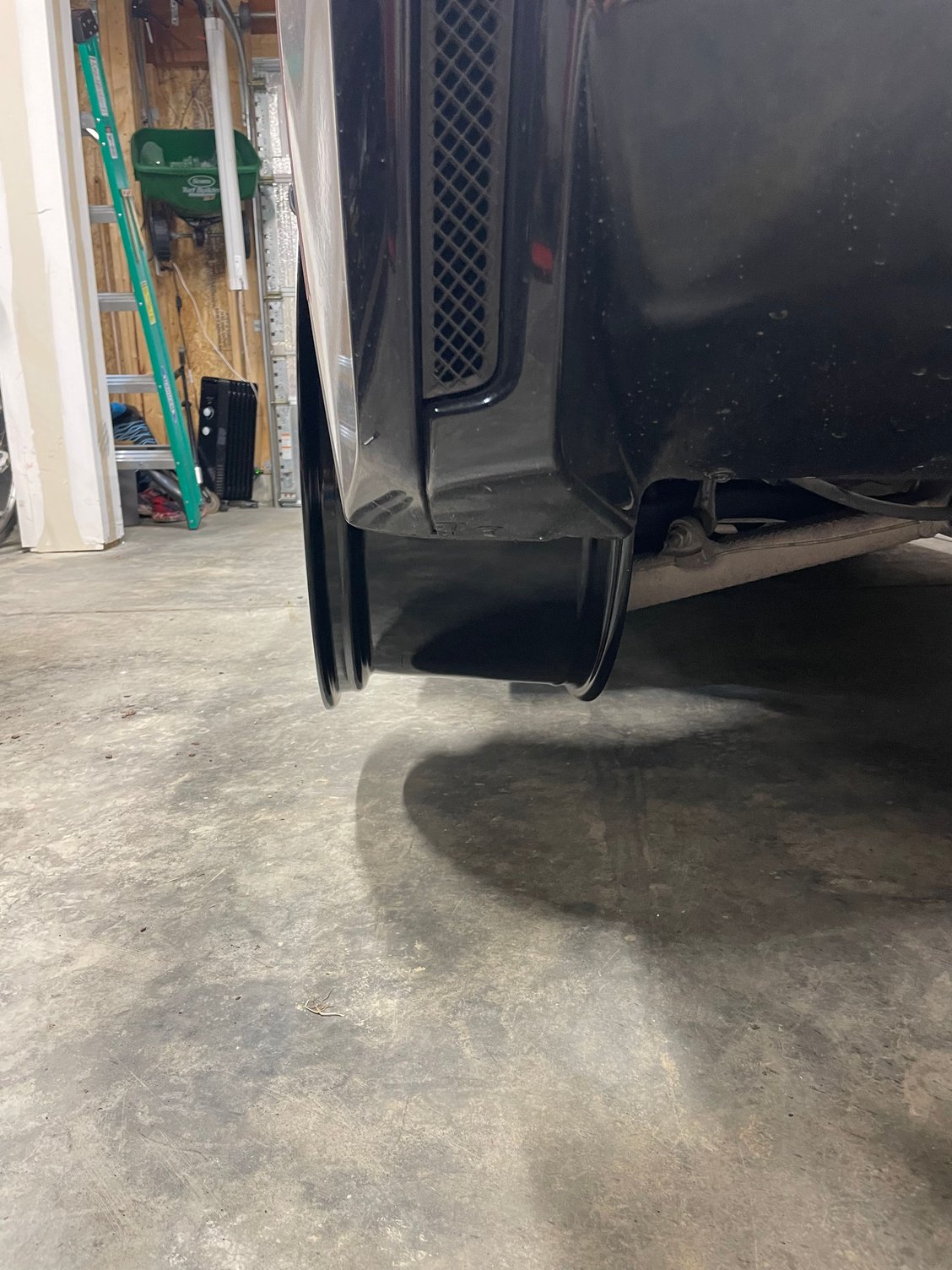

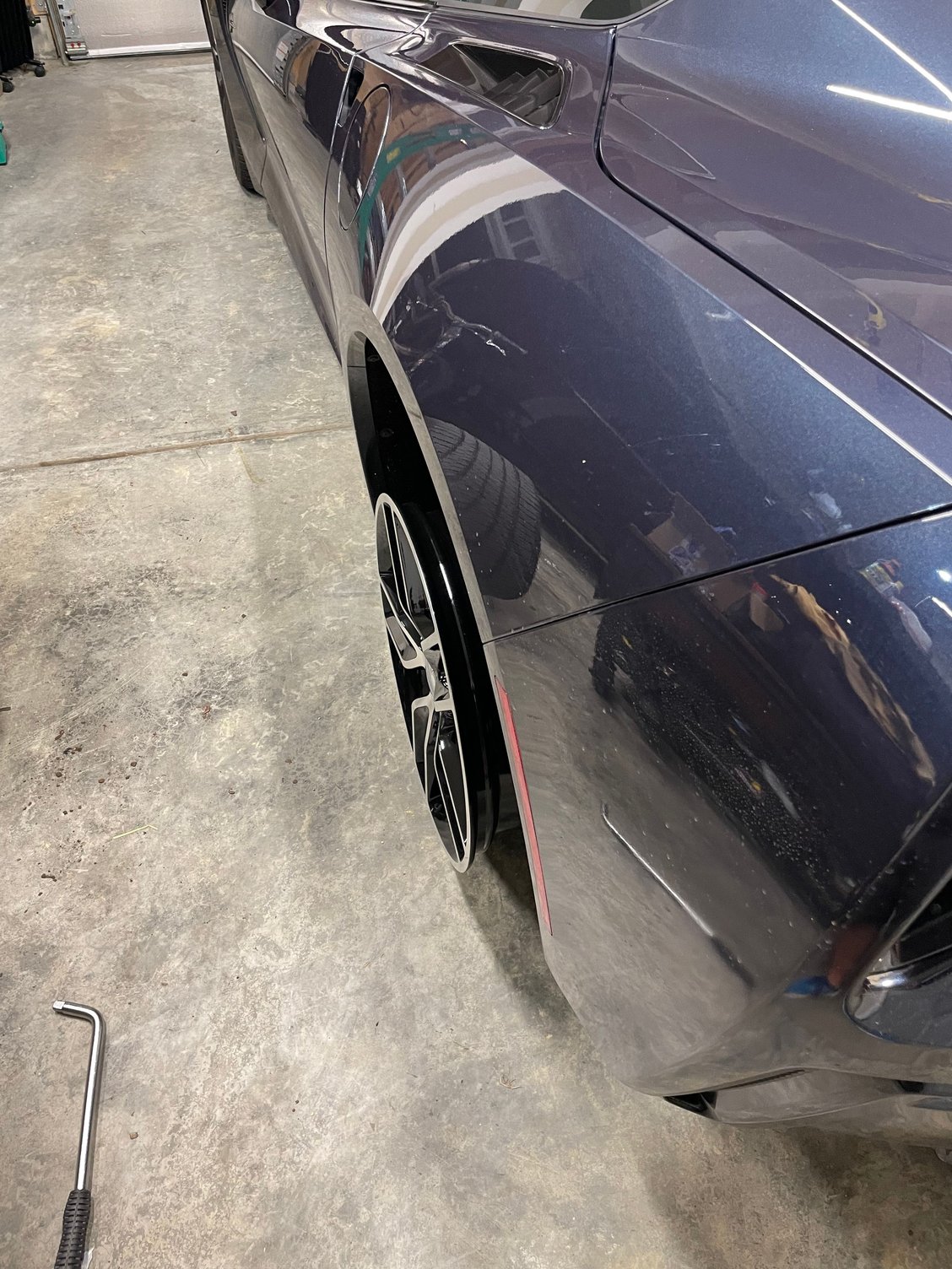

Z51 - Trying to figure out what wheels and tires for a drag set on the rear. I ordered a set of rears but they stick out a little (3/4 inch or so) as they sent me 56 offset, but I need 79 evidently.
Would keeping them cause wheel rubbing issues? I got 19x10 to allow a little more rubber out back- but with then sticking out I’m concerned it’ll squat too far and hit the fender. New to the C7. I don’t want to spend a fortune since I’ll just race it once in a while but just don’t want to tear up my street tires.

If they're stock width then you'll probably be fine without rubbing. I'm running C8 wheels, 20X11 with 64 offset, on my car using the stock width tires (285) and they only rub slightly hitting larger bumps.

Are you just wanting a set for drag racing that you'll take off when not going to the track? If so, why not buy some Factory reproductions in 19x10 with the stock offset and put drag radials on them? Or guy the American Racing 19x10's they offer with 75mm offset. They are decently priced and give you the option to run a 19" drag radial which are cheaper and have more sizes available that would fit.
I would not run those wheels you have now. They will rub no matter what magnaride setting you are in. I have 20x11 -71mm offset Forgestarts and my 2915/30-20 Pilot Sport 4S rub in Sport mode when hitting larger bumps. I suspect they rubbed when I took the car to the drag strip on the 1-2 shift, too running in Sport mode.

Tall and wide wheels with wide tires are not good choices for straight line racing. Go with the smallest diameter wheel in about a 9 or 9.5 width and a tall sidewall tire. Run the highest air pressure that will stick the launch (probably 24 if you have no or minimal mods) and drop pressure 2 lbs at a time if you continue to spin. Don't be afraid to do a serious burnout after the waterbox.

Looks like they sent you the fitment for widebody C6/7. You should get it replaced in my opinion.
