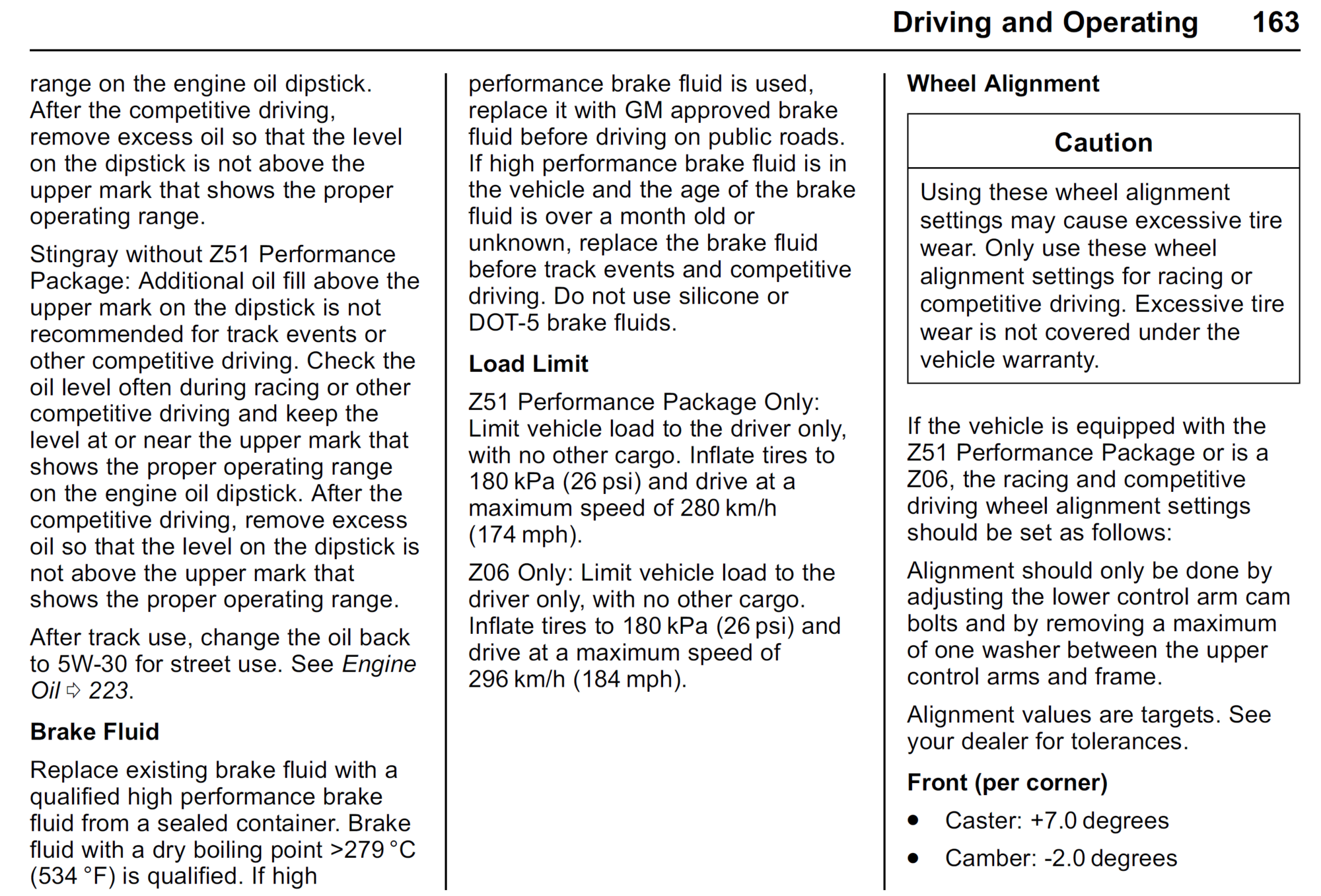

Think the owners manual is 26 or 27 PSI Cold Might refer to it.

The OM states the TP should be set to 26 psi when taking the car on track. From the 2016 OM section on Track Prep:
Tire pressure is defined in load limit paragraph. This is the same tire pressure the folks at Spring Mountain told us to use when we were attending the C7 New Owner's school. Reset pressure to 30 psi when driving on the street.
