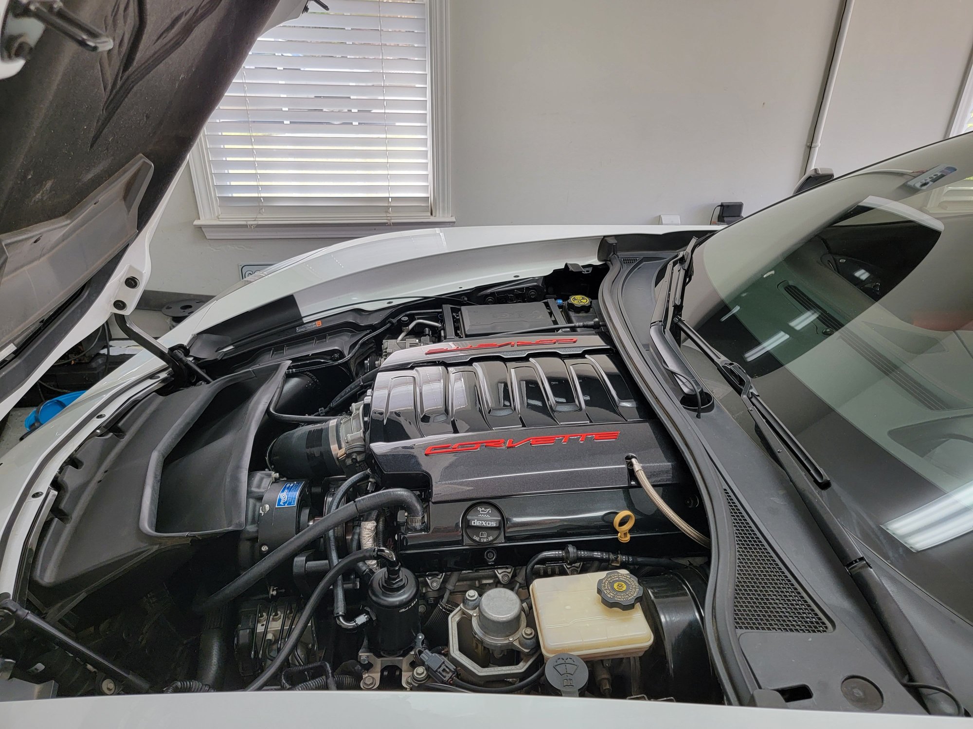

Originally Posted by mcspeed
No catch can ?
@mcspeed take a look at the picture I posted , yes I have a Mighty Mouse catch can ....
Dave

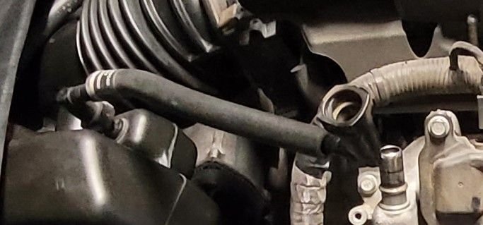

Just picked up a 2017 Stingray. Noticed the connector on the left side of this picture must have broke prior, was glued, now I've re-glued for a temporary solution. What is the name of the item on the left where it connects, Looks like the primary air. I probably need to replace that, but being a newbie, just can't figure out what that is called. Thanks, Eric.
Eric left side of what , need more detail on what you are talking about , are u talking about the connector on the air inlet to the throttle body ?
Dave
This line where it connects on the left of this picture. Sorry for the lack of detail.

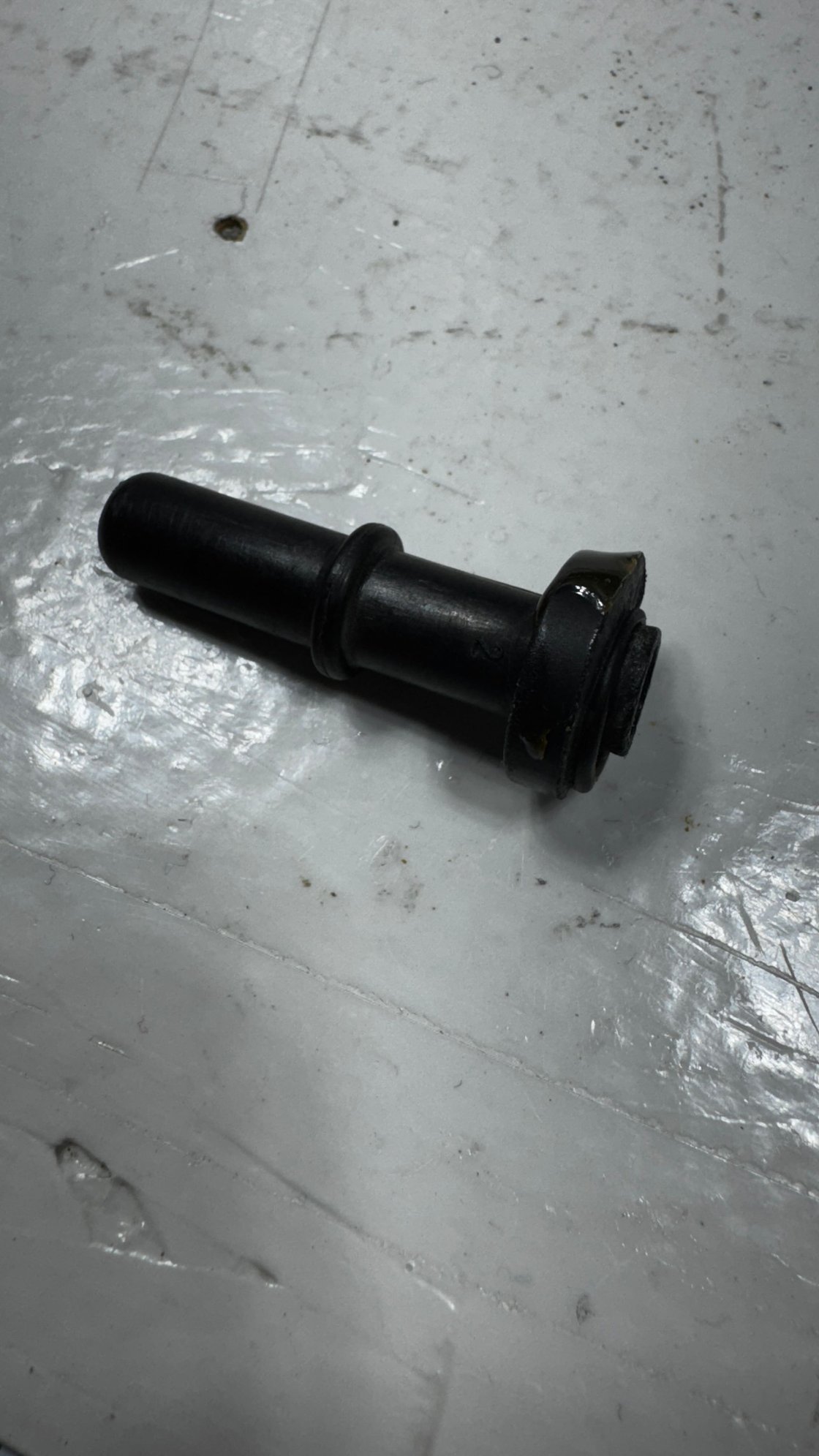

You can tell this was glued previously. I have temp glued it back, but just a matter of time. Thanks.
@eze.lasvegas
Eric , that's part of the air cleaner assembly, you can find them on Ebay or online if the dealer does not have ot . They are easy to replace
