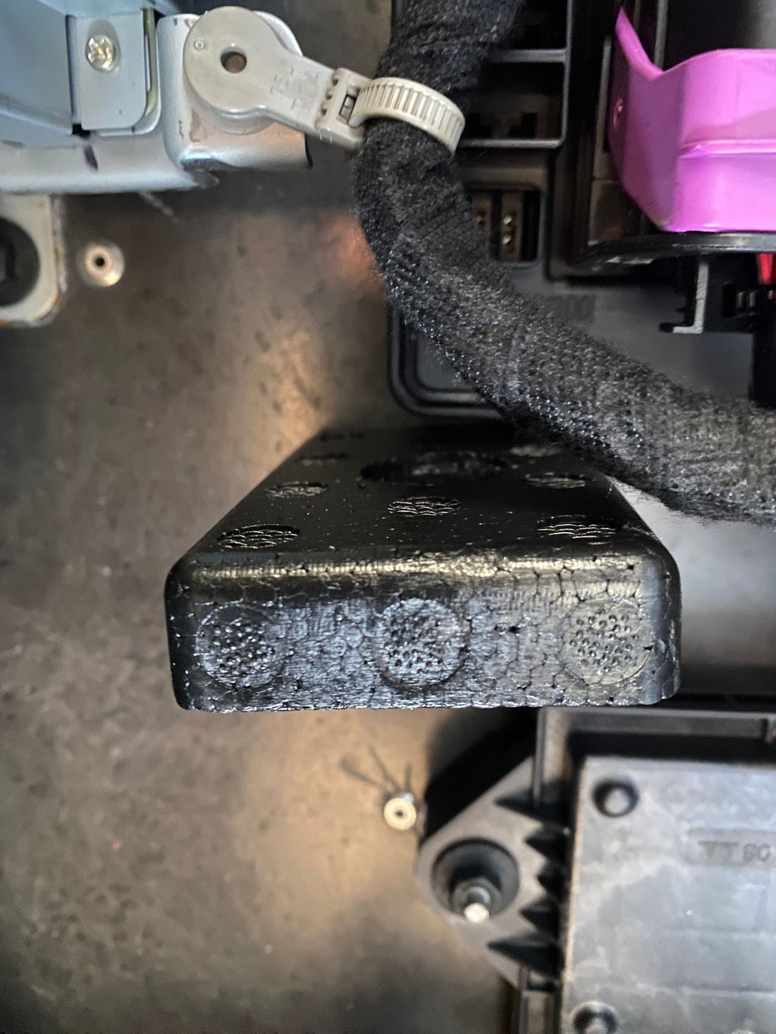

Not sure what this does.
yet. Callers can hear me and the navigation instructions through Waze seem to be playing just can’t hear them. Not sure if that might not have anything to do with a small little square module that is attached on the floor, which I have no clue what it does. As it being so low, it probably got wet also when water got into the trunk.
