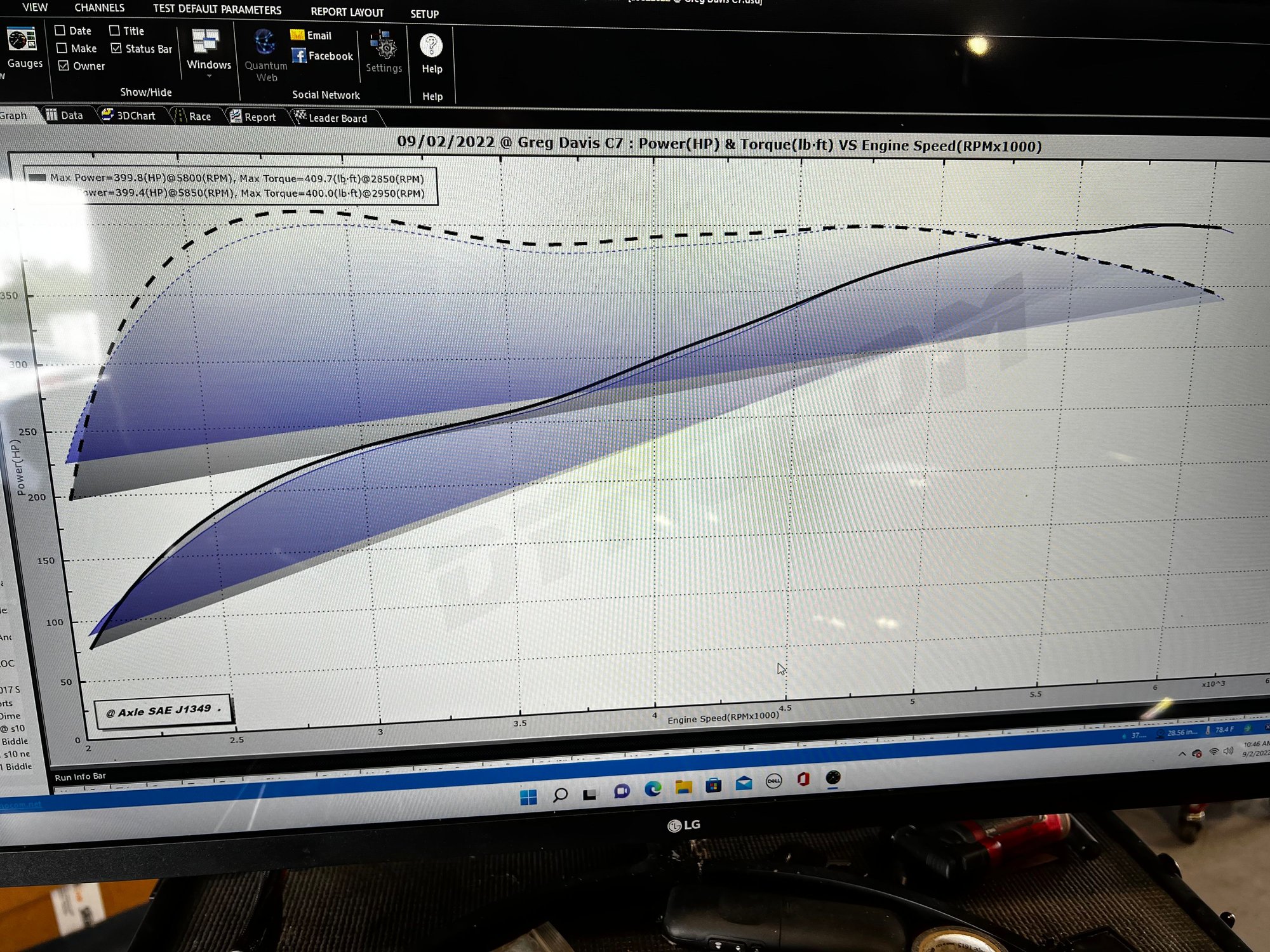

Before dyno run results. This was on a Dynocom chassis dyno so it's about what I expected given the minor mods and no tune.
Ran 116mph back in March setup this way on a fairly warm and humid day at 900 altitude.
