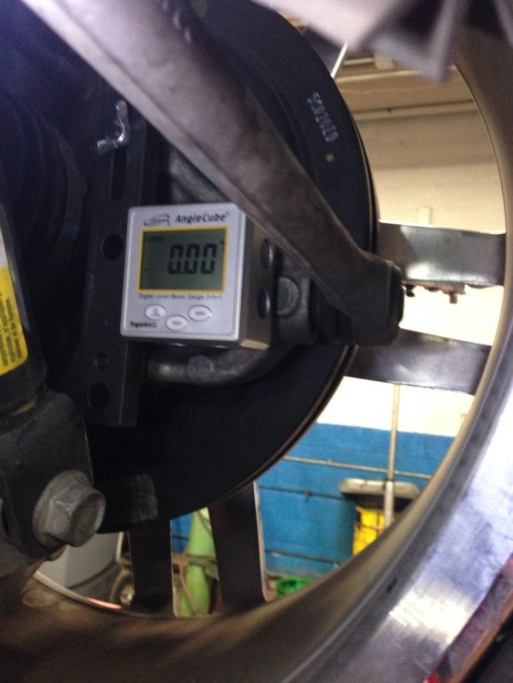

If the Rear Camber is adjusted it will change the Rear Caster so they will have to adjusted together. Alignment Machines cannot Measure or Display Rear Caster. You will need to find a shop that Rear Caster Tool.
