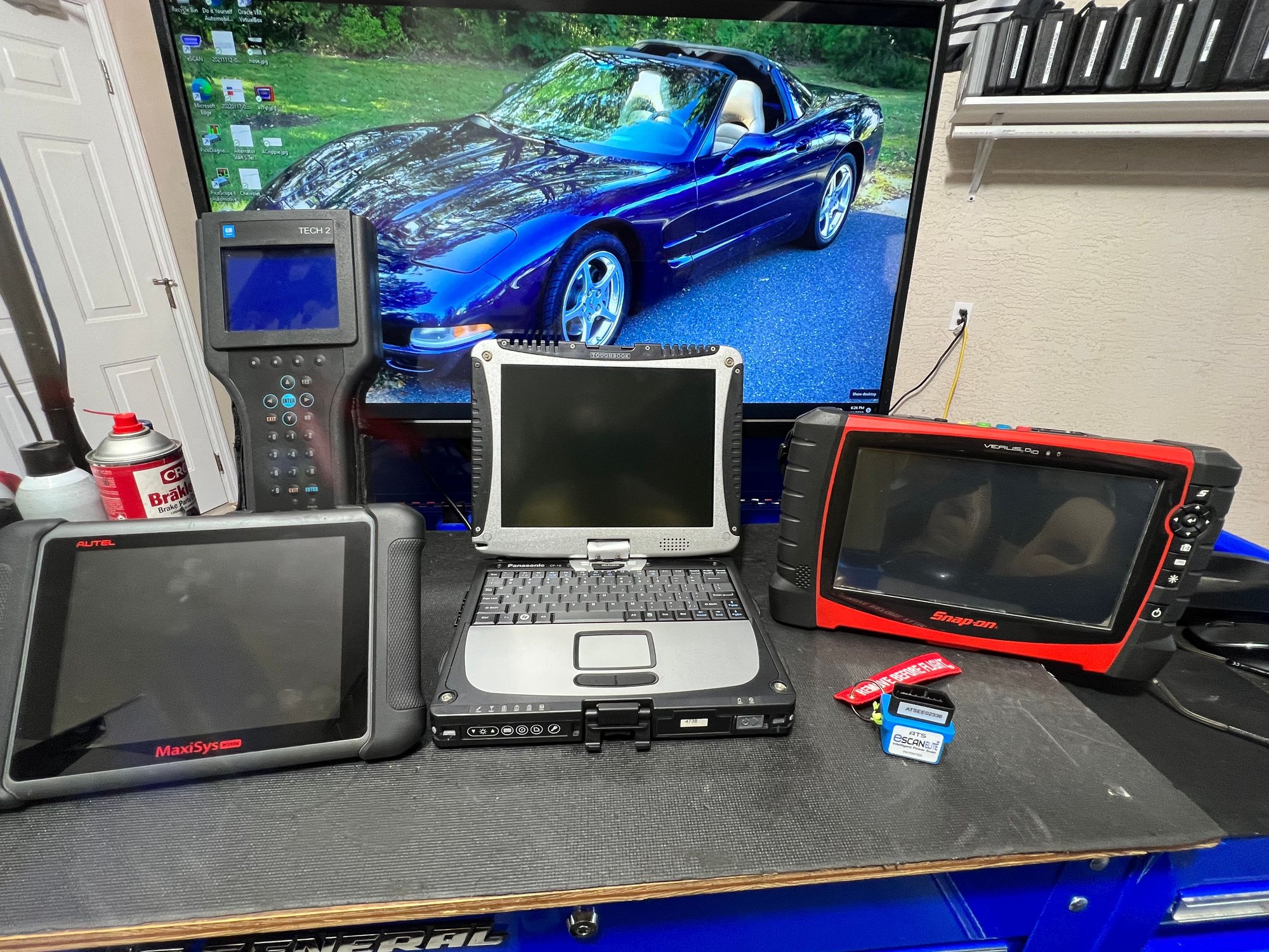

I’m in Cape Coral on the Gulf…if you want to take a trip over this way I have 5 scan tools…LOL !!…the Autel MK808 is a good buy right now …think they just updated the software to make it bidirectional…for a six pack I’ll scan and diagnose it for you !!
…what’s the concern with your car ??…you can’t just read a code and replace a part…a lot MORE involved than that !!…that is what 99.99 % of dealerships and general repair shops do !!…I also use a labscope which 99.99% of dealerships and repair shops don’t use either…essential these days to diagnose a car.
