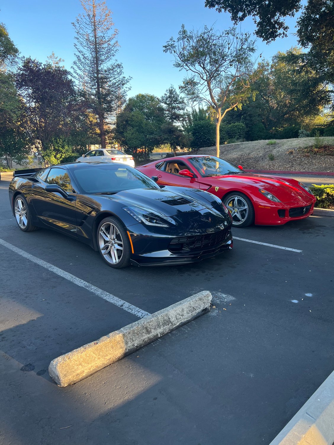

Default 2016 C7 stacked mods underpowered HP?
My 2016 C7 stingray Z51 with a C7 carbon fiber wicker bill and front splitter,
has
long tube American racing headers
borla atak exhaust black ceramic tips
afe cold air intake
atomic air force intake
and dyno tuning
that's taken my stock 455HR to 511HR
so 56 horse power increase on less than twenty thousand miles, and after parts and labor it was easily ten grand.
in speaking with friends of other vette owners it's been suggested with my modification stack I'm running severely under my HP potential. Please advise

How are you making that assessment? Even if you had dyno runs you don't know for sure unless you actually drive the car and find out what it can do. I notice you have Stage 2 front aero on the car and Stage 3 Rear Aero. That adds a lot of drag and the differences between no aero to Stage 1 to Stage 2 and Stage 3 can be felt even on a Z06 once you are in triple-digit speed territory. A GS running its stock Stage 2 front aero with Stage 2 rear aero can run with a Z06 configured with complete Stage 3 Aero. Both have a hard time with a Z51 not running much of any aero once speeds get over 120.

Bill,
Honestly the assessment came from a viral YouTube video of this guy configuring a dyno tune to a c7 can’t remember if it’s a a Z06 , with the arh and got some crazy 100 or more hp not to the wheels off a stock stingray that then added the arh long heads and tune only, none of the other three mods I have, also one of the friends of one of the shops mechanics said his borla exhaust plus borla xpipe with tune only was ahead of my dyno and that was prior to any of the C7carbon fiber additions.
I just picked what I thought looked the coolest I even had c7carbon gran turismo side skirts that cracked in the shipping box, I didn’t think to look at wind drag and performance sadly. But I already chipped the front splitter lol, so if I replace I pair with the correct aero line up? Appreciate the reply brother
