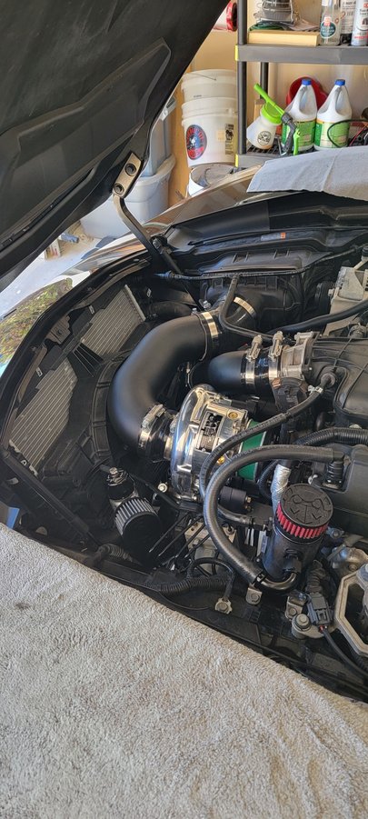

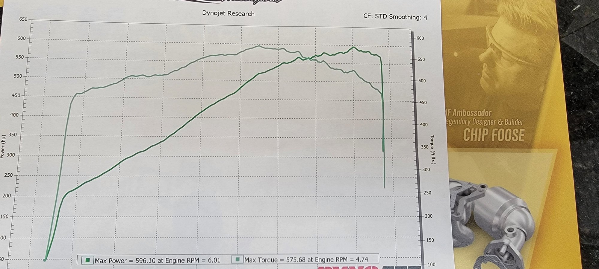

Just wrapped up installing an A&A setup with a 3.8 pulley on my 2016 stingray. The only supporting mods that I have done are a Mighty Mouse catch can, catless x-pipe and a Lt4 pump. Now I am at the 600 mark and wondering what I should do next. Any Ideas? Also please post your setup/numbers.
