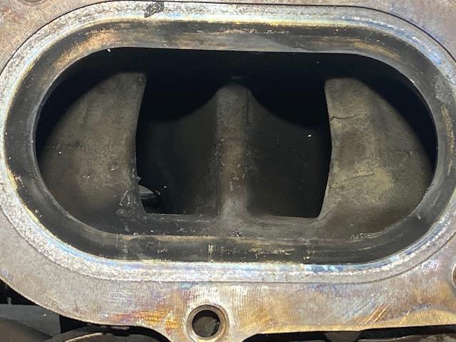

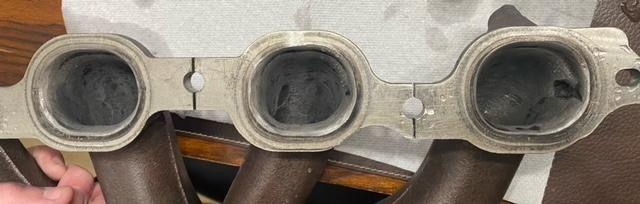

Picked up a set of Z06 Exhaust manifolds, decided to port them... 1) they will look better than the rusty stock ones and 2)Hopefully picked up a few ponies. Gasket matched at the flange and then opened up the center runners. I finished by using a 1 3/4 flex hone first 80 then 120 grit to smooth the inside of the runners slightly. Still need some clean up, then a coat of VHT Flameproof.

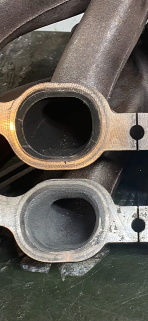

Before comparisons

Did you see any gains? Doing mine now and copying socal portings's work as close as I can. Thanks!

Are you removing a significant amount of material?
