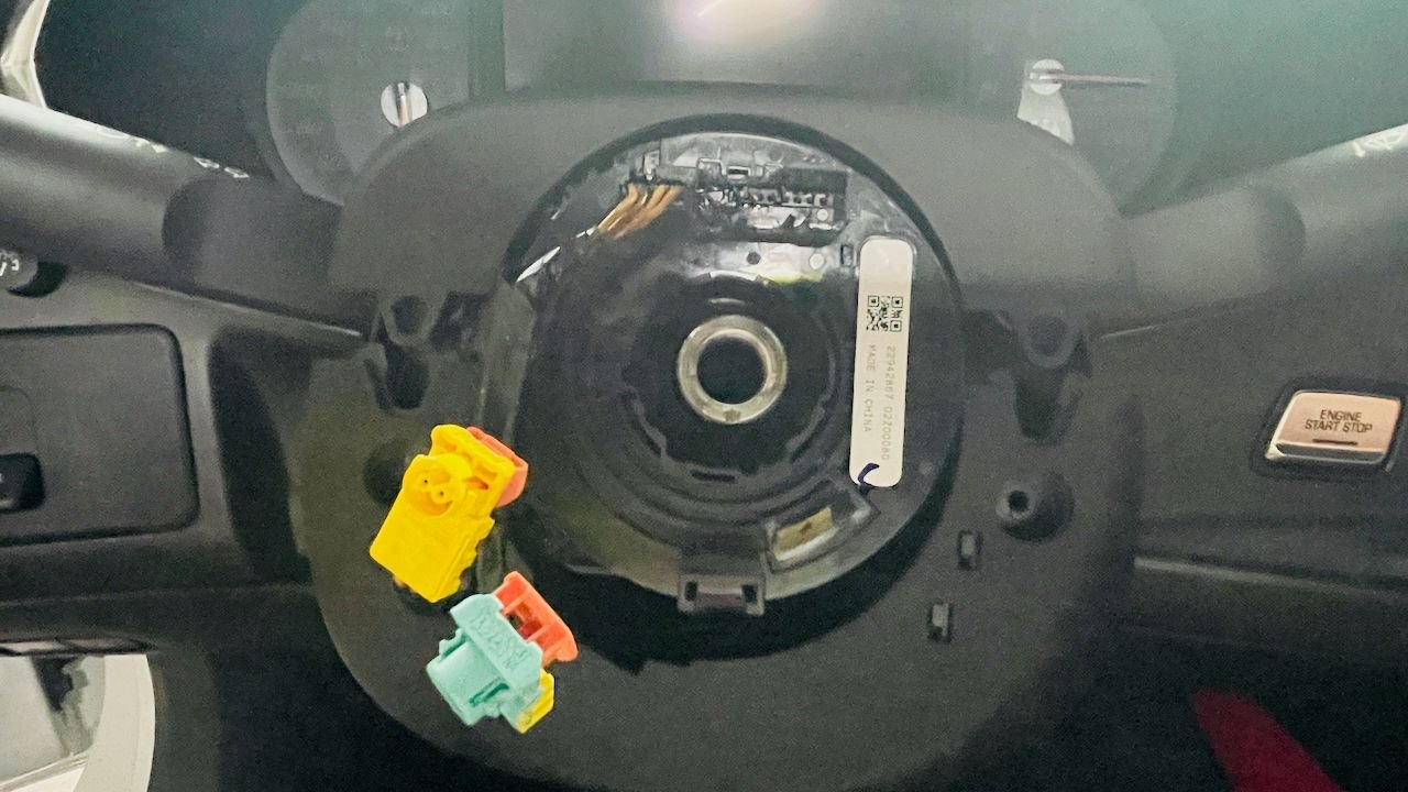

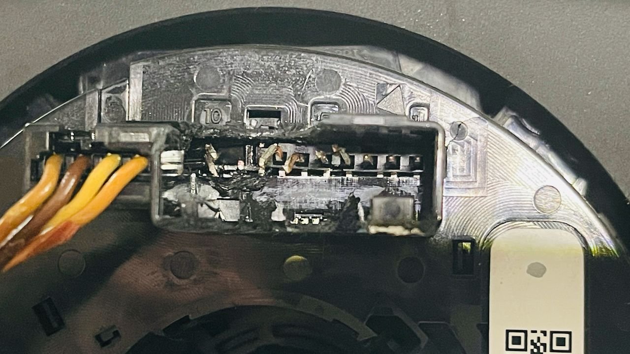

I went to remove and replace my steering wheel for a new one. I read through most the steering wheel threads and started the project as I'm pretty mechanically inclined and have taken on much more difficult automotive projects. I was one of those where the steering wheel bolt was an absolute bitch - it would not come loose even with heating. I went to use my impact gun as some have and my Torx bit broke. When it broke the bit socket spun up and hit the airbag clock spring electrical tabs/connectors. So, I know I need a new clock spring module (not a huge deal) and, of course I removed the battery cable before I removed the airbag as specified in AllData and in most posts regarding the procedure.
My problem is, the steering column is completely retracted and it needs to be fully extended to be able to remove the steering column trim covers to get to the airbag clock spring connectors. My question is, can I re-attach the battery connections momentarily to extend the steering column, or will that result in some code or error I would need the dealer to reprogram/fix? Is there a manual way to extend the column? I would disconnect the battery once the column is extended. I would also be sure none of the connectors on that tab are touching as I can't imagine that would be a good thing either.
I'm ticked this dumb mistake happened and it goes right into the what can go wrong will go wrong column.
Here is a pic of the destruction:

You'll get an airbag light, but it should clear on its own once you get the car fully reassembled.

Wanted to update, I was able to disconnect the large harness behind the clock spring by reaching back there with a pick. I was confident that harness was for the steering wheel controls as there is another small harness I figured was for the airbag. I really wanted to remove the wheel control harness before attaching the battery cable because the connectors on the front side were so mangled. I was pretty worried about a hidden short that might cause some really expensive problems. I reconnected the negative battery cable and I was able to extend the steering wheel without activating the ignition and therefore no dash lights or codes. Removed the trim covers and now I wait for the new clock spring to arrive later this week. This whole thing should have been a half hour job, hour max...
I'm crossing my fingers the steering angle sensor doesn't give me any hassles after I remove and replace it on the new clock spring.
I'll find out next weekend and will report back either way.

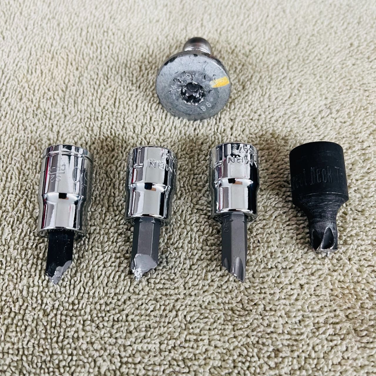

In addition to another carnage pic, I'm going to add my experience to the existing steering wheel threads that I would NEVER recommend an impact driver for the removal of the steering wheel bolt. It's just too difficult to control if the bolt comes off too fast or if it seizes up and the Torx socket fails. Ironically, when I first tried the impact, the bolt started to come out. It's only when I slowed with the impact in fear that the bolt would come out and fly off is when it got stuck. Just when I was at my wits end with the stuck bolt, I went back with the 1/2" breaker bar and the constant pressure worked great to remove the bolt where the impact wouldn't budge it.
Three hours and four broken Torx bits later, finally success. I'm so lucky the bolt didn't strip - I was really worried.
