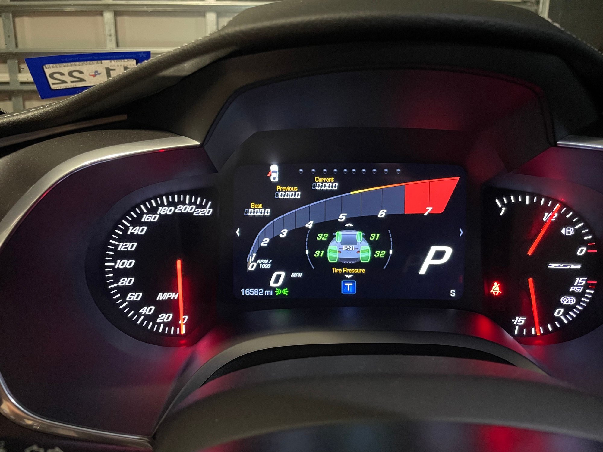

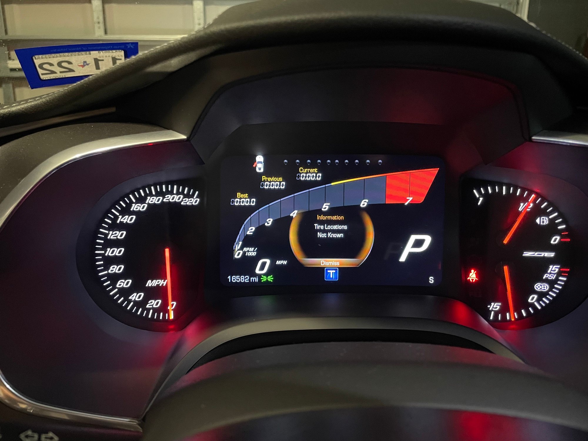

Has anyone encountered this problem? All tires are pressured up which should satisfy the sensors but still have this problem. Any advise is appreciated, thank you.

Do you have aftermarket LED lighting?

Disconnect the LEDs and see if the TPMS starts working again. If it does that is a sure indicator the LEDs interfered with the TPMS system which communicates through the door lock receiver. The fact that it didn't bother things for two years may be due to the batteries in the sensors losing their charge and not sending out a sufficiently strong signal to override interference from the LEDs.
How old is your car? 2017 build dates were from about the end of June 2016 to the beginning of June 2018.
TPMS sensors usually last 7 to 10 years so if your car is an early build it might need new sensors if they are not lasting quite as long as others.
If new sensors are required there is no need to visit a dealership. Almost any tire store can replace them. You don't even need a tool to reprogram the car to recognize them as the car will learn new sensors while you are driving (see OM).
