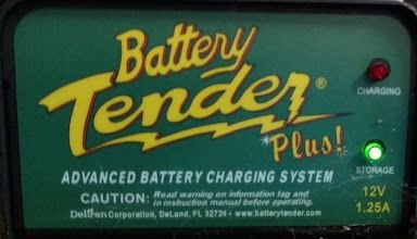

Deltran Battery Tenders are #1 !! Started using them back in in 1987 with my first 1987 C4 Corvette and Never Let Me Down and have Batteries Last 10 years.

Ive had a Deltron on my motorcycle for the past 15 years and its been great. Great also because I dont ride a lot so its been "on" nearly the whole time.
