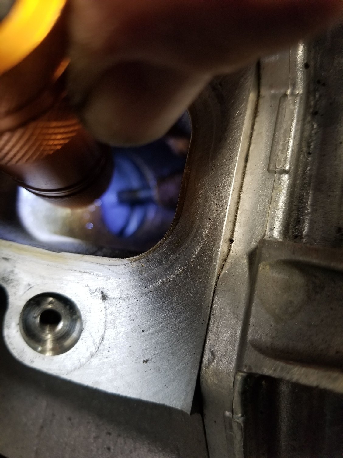

Originally Posted by charsiuboar
Curious how we got to the conclusion that ‘GM does not have the DI issues that BMW or Volkswagen have’ — are there articles or videos I can watch to educate myself? I am curious about walnut blasting too and when it’s appropriate on a C7 Z06…
There are many posts with pictures proving that most GM DI motors do not have problems with carbon buildup . Occasionally you will see a picture of a bad one but I am a firm believer that they are the outlier and probably caused by other problems just think of how many GM di motors are on the street , don't you think we would have heard something by now . 😉 Heck my BMW did not make it to 30,000 before I had to get it walnut blasted Below is a picture of my valves at 37,000 miles ... I am not worried how about u ... Dave ​​​​​​​

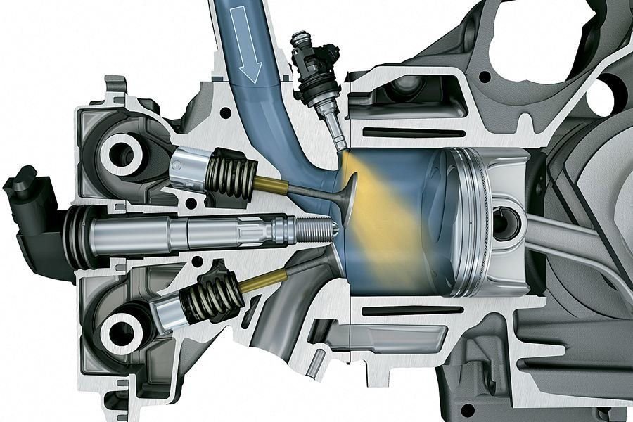

Originally Posted by Jeff V.
You can't position DI injectors to "hit the valves". The entire point of direct injection is that it injects fuel directly into the cylinder. Well after the valves.
lol, yes you can. See below.

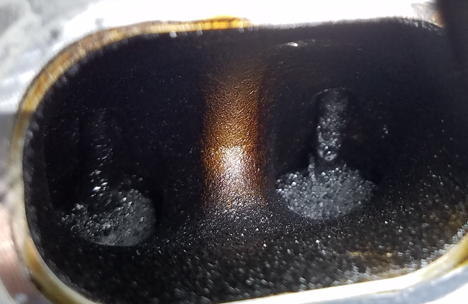

This was my BMW at 48k:
Now that I htink about it ... the N54 was particularly bad because of the way the PCV system worked. It sucked off the crankcase gases and fed it back through the intake right before the charge pipe. Also, there were ports from the intake tracts into the valve area to pressurize the PCV system (and had a nasty habit of blowing out valve cover gaskets), but when boost dropped it sucked more vapors in over the valves. I tried to mitigate it with a catch can and blocking those ports, but at 60k miles I realized I was spending more to repair it every month than a new car payment would be so i traded it.
I don't think the Corvettes does anything fancy/stupid like that, perhaps that's why there's so little buildup.

This was my BMW at 48k:  Now that I htink about it ... the N54 was particularly bad because of the way the PCV system worked. It sucked off the crankcase gases and fed it back through the intake right before the charge pipe. Also, there were ports from the intake tracts into the valve area to pressurize the PCV system (and had a nasty habit of blowing out valve cover gaskets), but when boost dropped it sucked more vapors in over the valves. I tried to mitigate it with a catch can and blocking those ports, but at 60k miles I realized I was spending more to repair it every month than a new car payment would be so i traded it. I don't think the Corvettes does anything fancy/stupid like that, perhaps that's why there's so little buildup.
yeah that's about how bad my BMW looked lol lol Dave
That design kinda defeats the purpose of DI as it is not an ideal position to spray the fuel , plus it would not provide nearly the cleaning that having fuel flow over the valve and stem from behind provides.
If it was that easy I am sure that the automakers would be doing it
Bottom line is , having a properly designed PVC like the LT motors system eliminates almost all the problems
The only reason I added a catch can recently was because I installed a procharger, having a blower changes things a bit and I did feel the need to add the can but so far I only have a ounce or two of oil vapor condensing in the can .
Guess where the fuel goes if you inject it at 2100 psi (2900 for LT4) while the valve is open?
all over the cylinder
