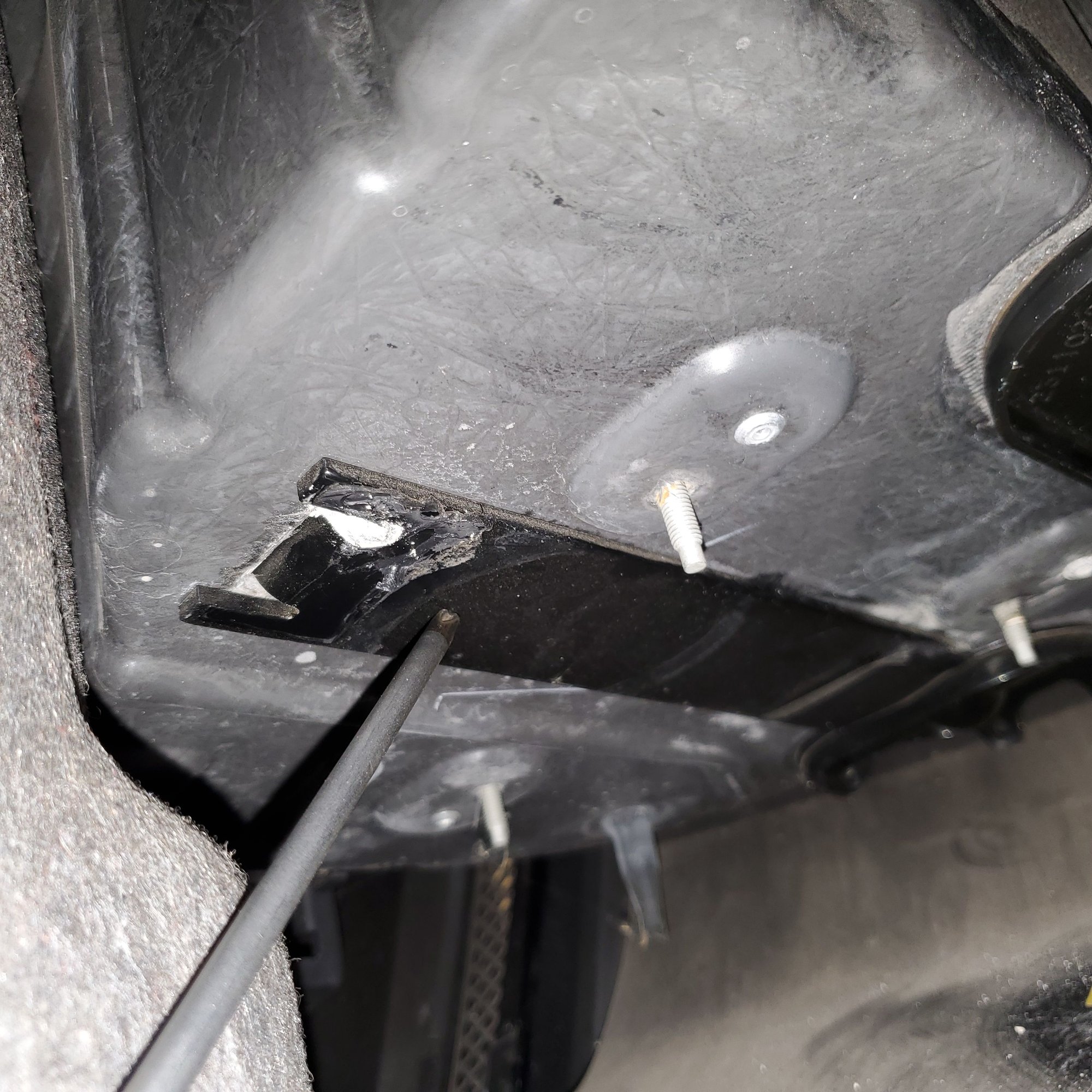

Battery leaked a bit and set up corrosion on the battery hold down bracket. Not sure but looks like its glued to the bottom of the tray. Needs to be removed to clean it properly. Anyone out there ever remove this bracket? Tray is fiberglass and the bracket is steel. Don't want to crack out the tray.

Its not the tray, its taking the battery hold down bracket. I'll send pictures.

Using a thin puddy knife I managed to pry the bracket loose, it was glued to the bottom of the battery tray. Attached is a pic of the lower side, under the car with the screwdriver pointing the hold down bracket. You can see the white powder corrosion on the bracket, its made of aluminum. Better check for leaking batteries if they are lead acid. there is a bracket under the tray that can be damaged.

Old man here is having trouble locating said pic attachment?

This old man forgot to attach it, but its there now.
