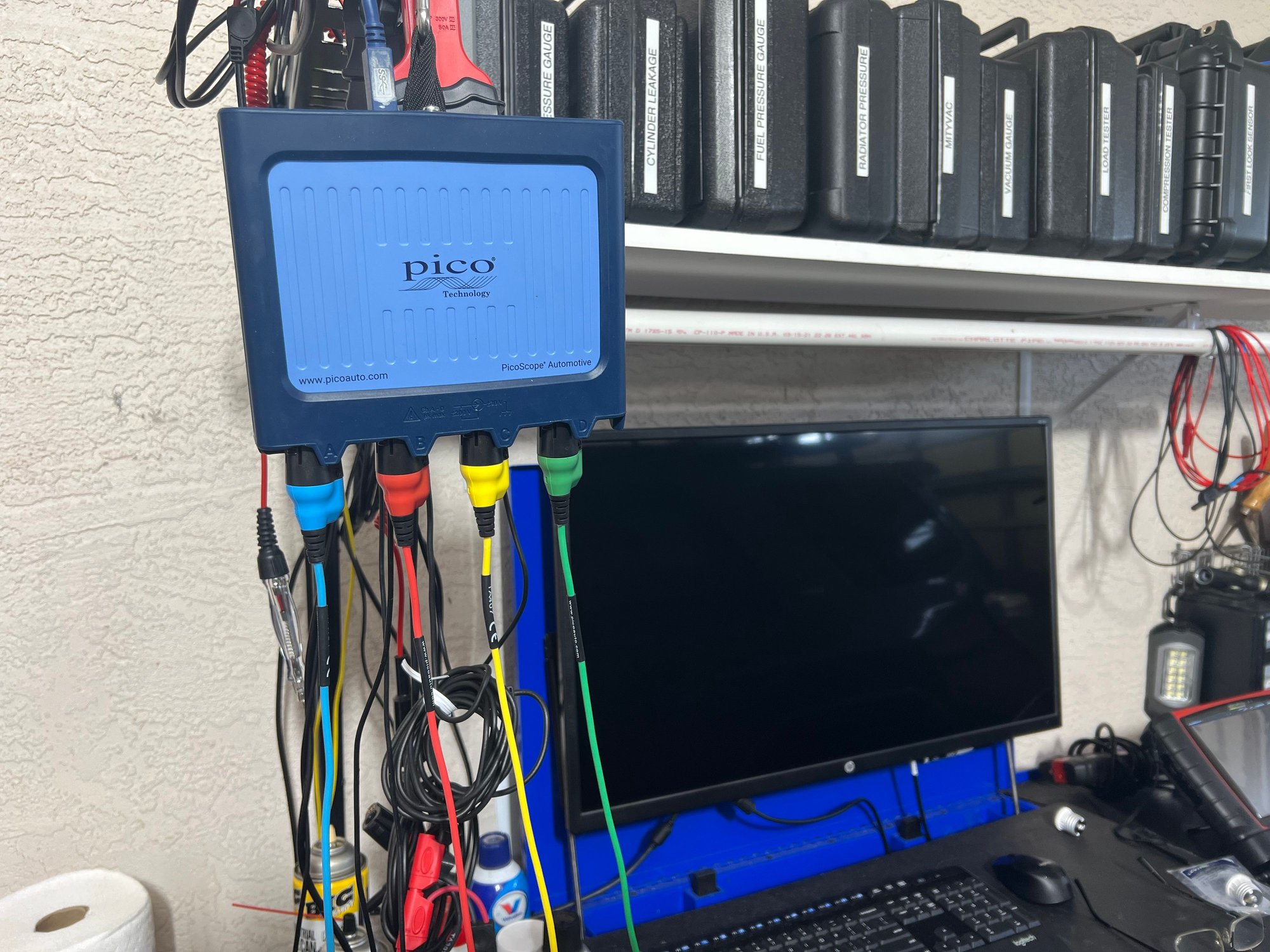

No vibration is “inherent” in ANY car…the dealership should have a Picoscope (labscope pictured below) which they should be using for NVH (noise, vibration, harshness) issues…tell them to use it and find the vibration and quit trying to blow smoke up you know where…you have that extended warranty so let them handle it…if not I’d elevate your concern.

Thank you very much for the advice. I am waiting to hear back from the service manager today. I will see what he says, and address your remedy with him. Thanks again. I will let you know how it works out.

I feel it through the seat bottom, and if anything is in the cupholder you can see it and the shifter both vibrate at the same rate as zi feel through the seat….alignment was checked…they are going to use a picoscope to see if that helps locate the cause…thank you for your advice….sincerely, Gary

Interesting video, I will review some of the others, we use similar technology in aviation to dynamic balance propellers and rotor system. Not as advanced as this though. The service manager said they would put it on the picoscope, they do have one. The dealership is working with me to try and resolve this, he did not flinch when I asked about the picoscope, said they would run the diagnostic. Thanks again!
