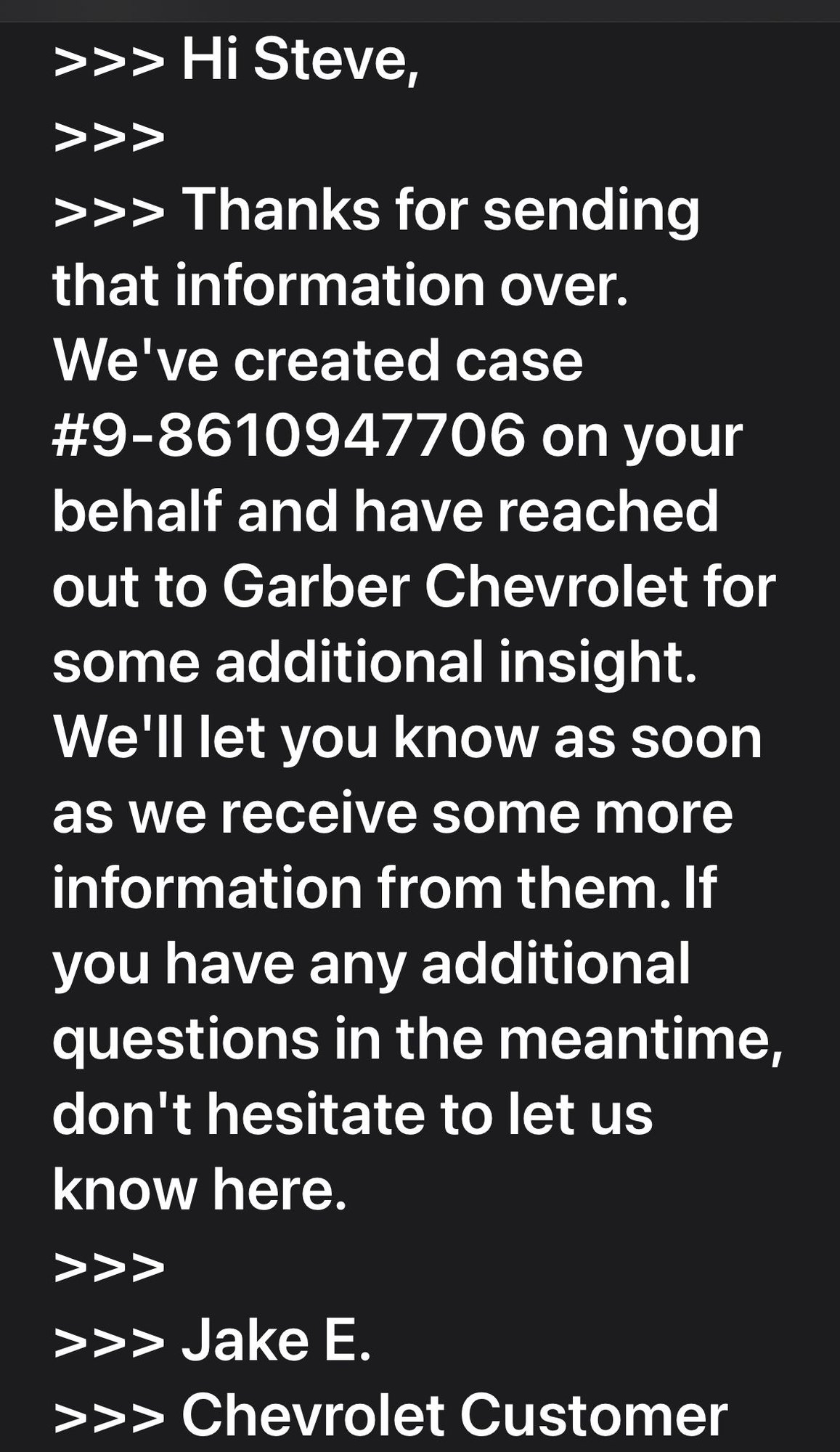

I really appreciate the response. I already have a case number for other problems with my car. Can you amend the current one instead of creating a new one? By the way, this next trip in for service is going to be VERY expensive! I know my ‘15 with 70k miles is not new, but you’d really expect a car of this cost to last longer than it has without breaking down.
Very disheartening!
Here’s the current case I have open.
