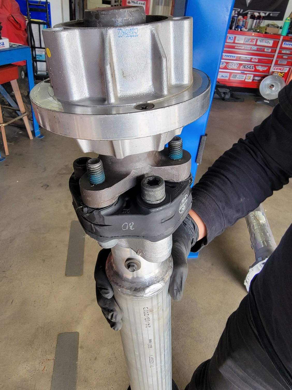

I took the car to the American Heritage Performance in Southern California to diagnose the vibration problem. The shop owner Kohle drove my C7 and told it was most definitely the torque tube causing this vibration and that he could rebuild the unit. Here are some photos of the tube after it was removed from underneath the car. I will also include a link to a youtube video showing the play inside the torque tube:
. While everything was out, I inspected the clutch, which looked great for 50k miles or was recently replaced. They rebuilt the tube with 2 new TT bearings, 1 new pilot bearing, and 2 couplers which came out to about $3700. I drove home feeling great but still noticed the vibration, only much more muffled. I climbed underneath the car and spent some time digging around only to find my driver's rear CV axle boot was loose and grease has been spraying everywhere. I got the CV axle replaced, diff fluid changed, and both of the axle nuts torqued (just for good measure) for $1k. After all that, the vibration is now gone and my C7 cruises on the highway buttery smooth.
Overall, I am glad I had the torque tube checked and rebuilt because I would be paying for way more in damages if I waited any longer. I hope the community finds this data useful.
