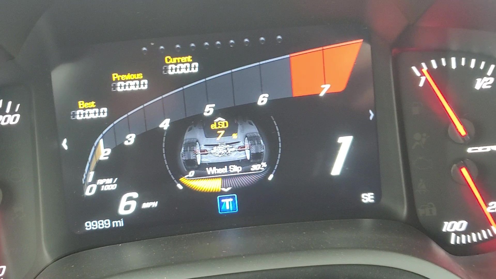

Thanks! I got to try something new today. I've never really watched the eLSD display while driving.
OK, let's make sure we're on the same page:
2019 GS M7, 48 F, Michelin A/S tires, tires all COOL at 32 psig.
The upper number on the display is the % the eLSD is locked - 0 = no locking, 100% = fully locked (solid axle).
The bottom scale is % wheel slip from 0 to 30%.
At a stop, cruising, or coasting eLSD lockup was between 2 and 12% and the % wheel slip was 0%.
I was able to get some wheel slip when accelerating from a stop. I did not "feel" any tire slippage, no tire chirp or wheel spin. Normal acceleration showed green increasing to amber.
Quicker acceleration went directly to almost 30% slip then dropped off. This was all during the period before the clutch was fully engaged and lasted about 4 sec. (Screen shots from a quick video).
Ron

Here's the explanation on what the display means and more on how the eLSD works. Apparently what I see just starting out is not real meaningful and is due to calculations with the small numbers when just starting out.
https://www.corvetteforum.com/forums...d-display.html
The linked article notes that the clutch percentage runs at 10 - 15% or so at highway speeds, but can increase with higher speeds, more throttle, or extreme lane changes.
So - why are you getting 24% lockup? Some input is off that either indicates high speed, large throttle position, or steering angle.
The slip calculation comes down to the wheel rpm front / rear being somehow out of whack. This could be due to wheel spin, non-OEM tire diameters (sizes or pressures) or some error measuring wheel speeds such as the wheel speed sensor for each wheel. Your tire pressures match, you are at a steady speed (no wheel spin), so I would look at the speed sensors. If the calculation has gone wacky by itself there is nothing you can do except get a good diagnosis.
