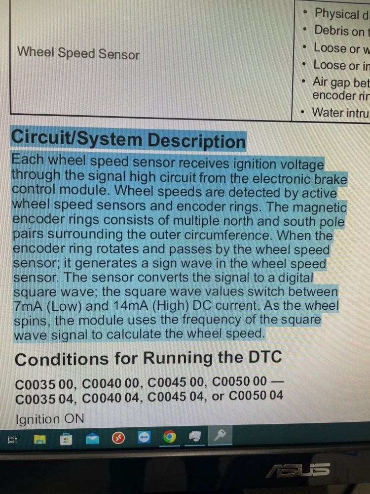

Are the C7 ABS sensors active or passive ? active as in being powered like the 09-13 C6`s

Here you go
Old Jan 22, 2023 | 09:31 AM
Bigbrake's Avatar
Bigbrake
Joined: Dec 2022
Posts: 115
Likes: 59
From: Metamora MI
Originally Posted by ErnieN85
Here you go
Thank you, thats even better ! Now reason I was asking this- maybe you can help further?....are the same values used on the 09-13 C6`s ?
Old Jan 22, 2023 | 09:49 AM
ErnieN85's Avatar
ErnieN85
Joined: Feb 2002
Posts: 3,726
Likes: 368
From: Montoursville Pa
Probably as it is a digital output

Thank you for the help and fast reply, I did track it down just now looking around...for anyone looking in the future
2009-13 C6 ABS hub signal values
The typical reading will be 4-8 ma for the "low" reading and 11-14 ma for the "high" reading.

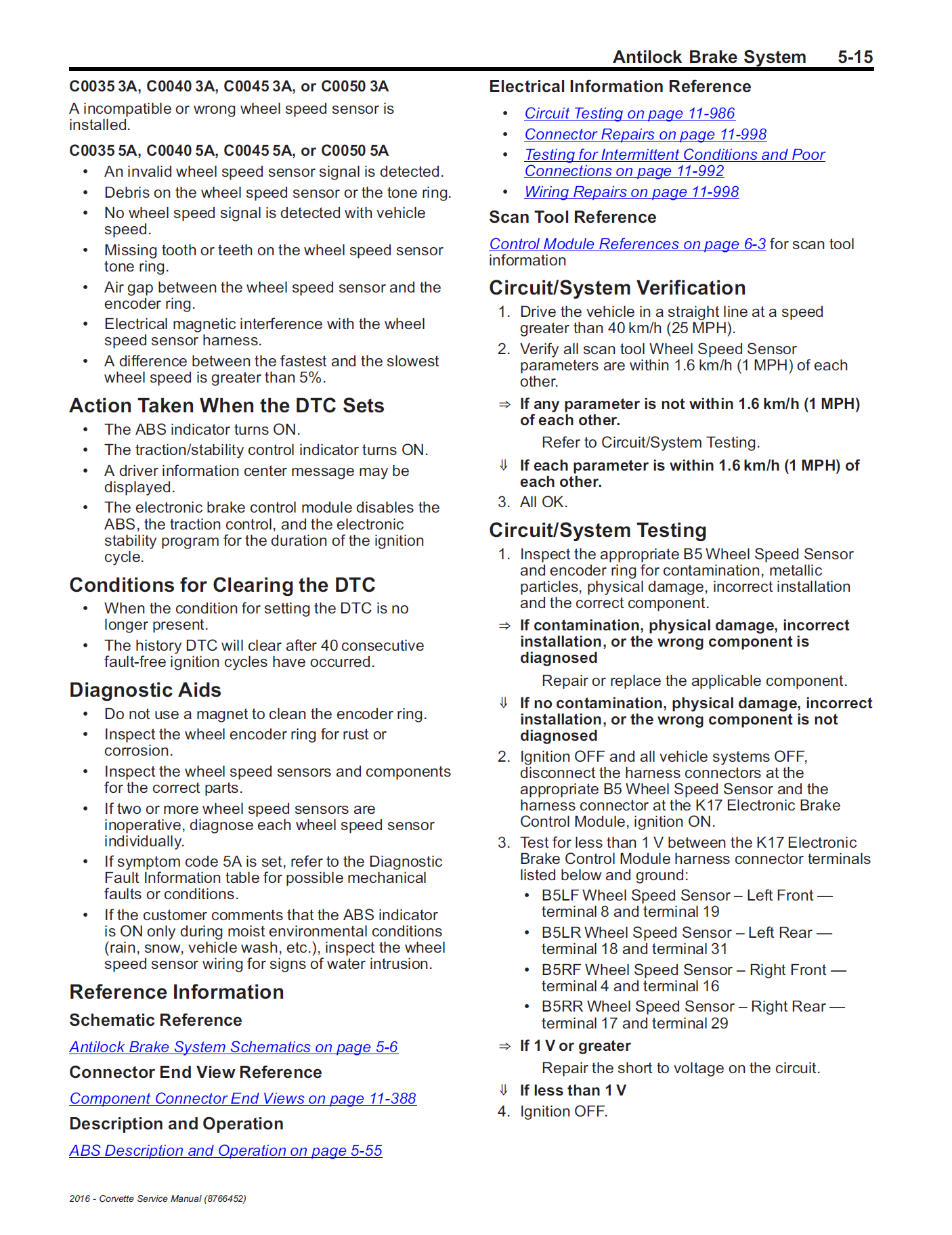

Hey, I know it's a pretty old post, but I got a C0050 5A error code, I have checked everything and everything looks ok, including the rear right abs sensor, but how can I check the "wheel encoder ring" ? And how can I identify it, What does it look like?

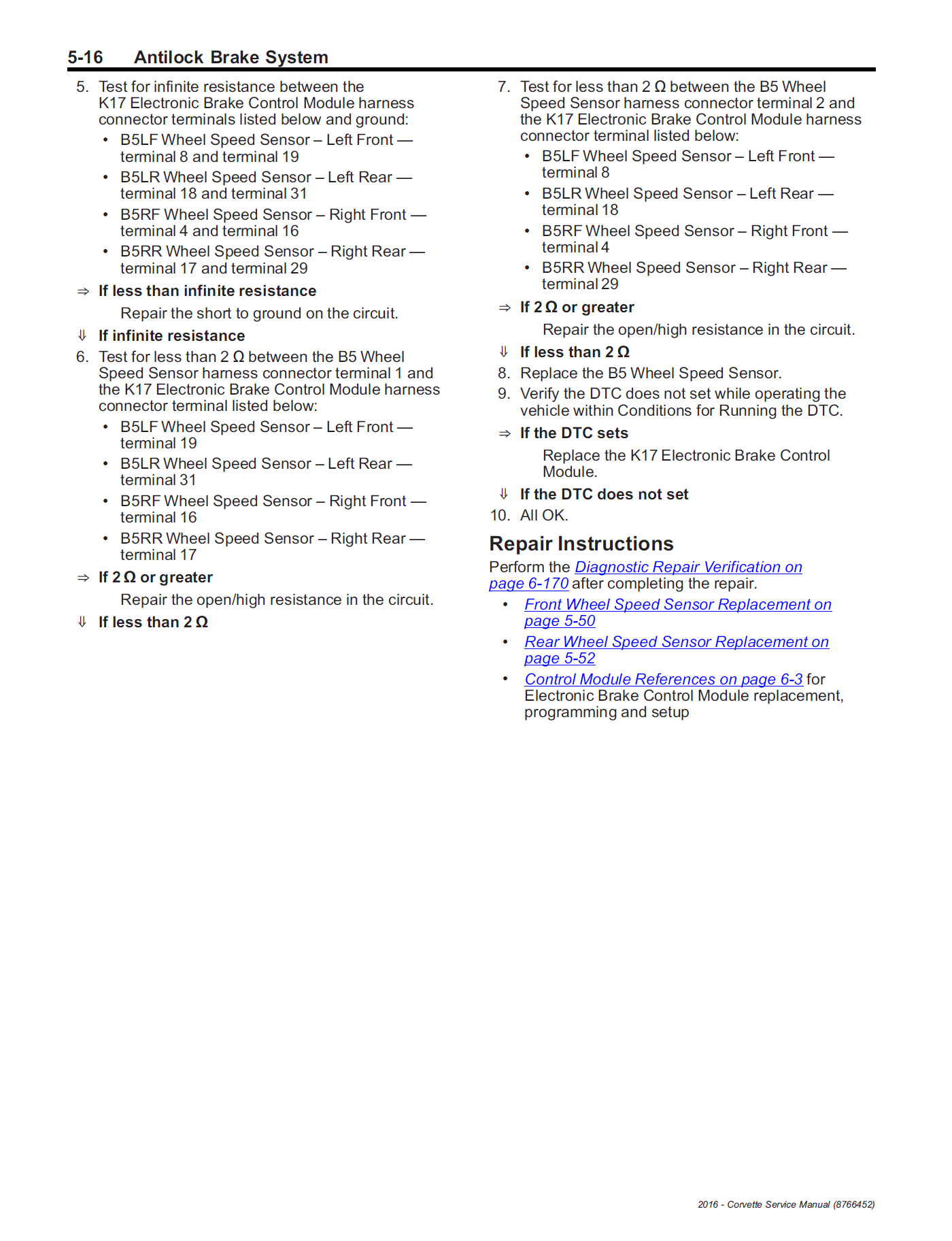

Here is what the FSM indicates should be checked when trying to analyze C0050 5A DTC:
Although not mentioned in the diagnostic procedure one thing I would check is the runout in the rear wheel bearing. With the old sealed hubs that had the ABS sensor built into the hub loose wheel bearings could cause the ABS light to come on. With the sensor now being plugged into the hub the distance between the sensor and the tone ring is still small. Put the car up in the air, release the parking brake and with your hands at the 12 and 6 positions rock the wheel up and down to see if you get any movement.
If a wheel bearing isn't causing the issue it may well be dirt/corrosion. My Tahoe has pluggable sensors and dirt/corrosion build up around the spot where the sensor plugs into the knuckle cause problems for me about every two years.
I have seen tone rings go bad on vehicles that have lots of use on salty roads. A Chrysler minivan that a neighbor had had the tone ring corrode away until there wasn't enough left to trigger the sensor.
Bill
Bill
Thanks Bill! Yeap, thats exactly what happened, I have removed the hub and found it to be corroded with a lot of dirt, cleaned it and on the way replaced abs sensor. Everything works as expected now
