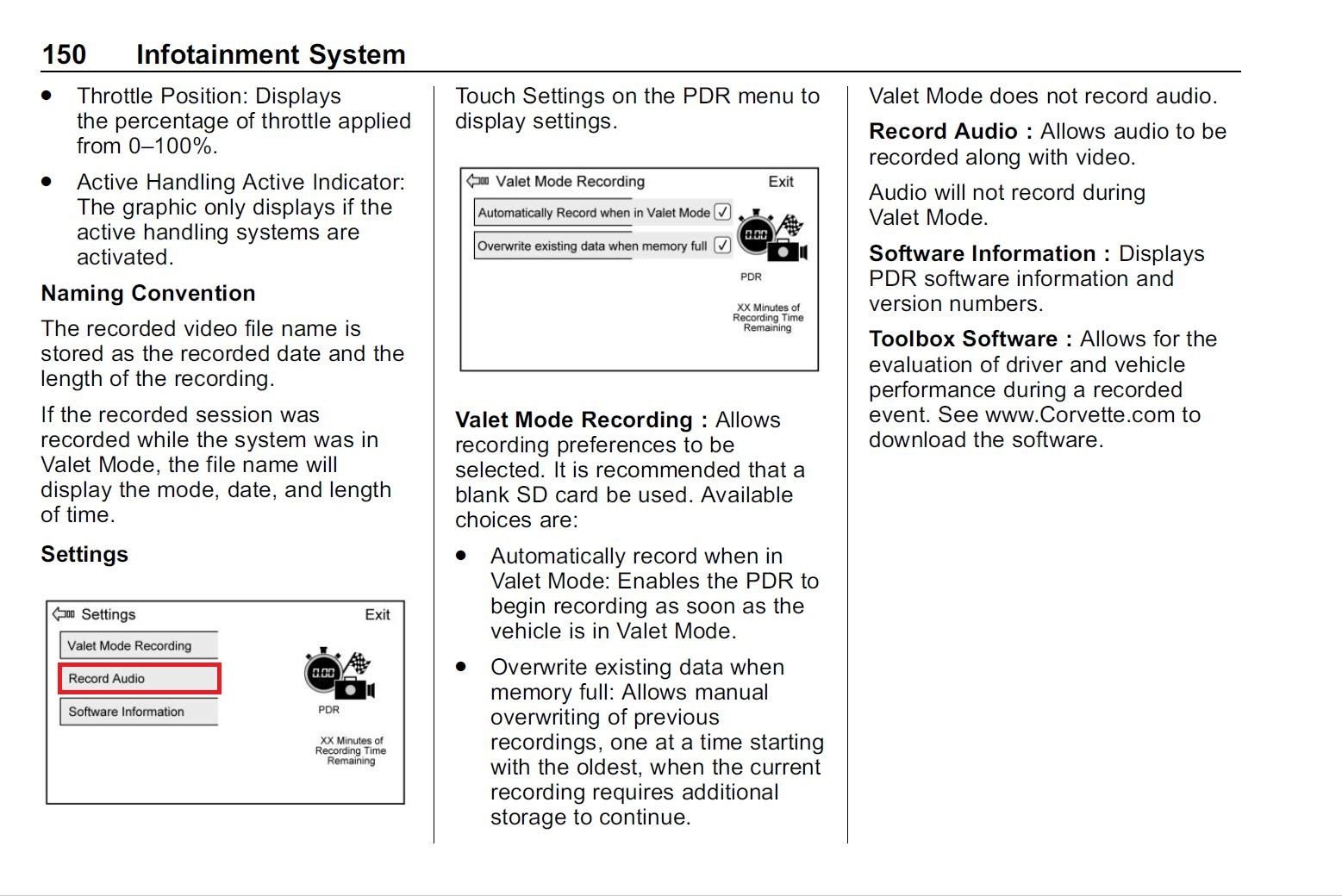

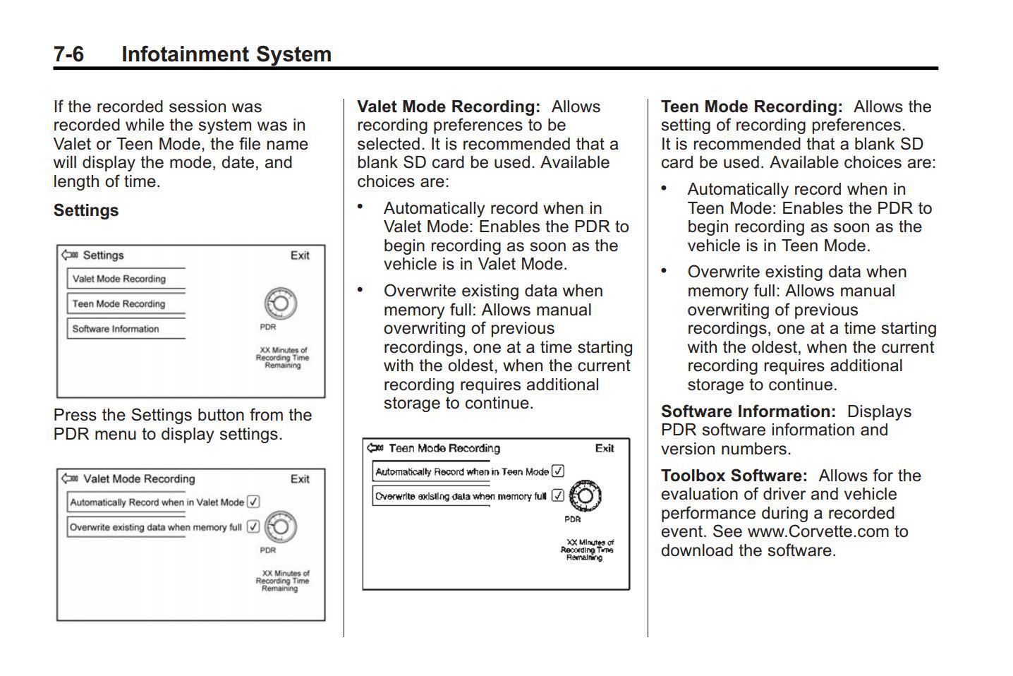

Yes, but the capability may have been added along the way.
Recording Audio (or not) is one of the PDR Settings shown in my 2019 Owner's Manual...
I don't see it in the 2015 OM....
