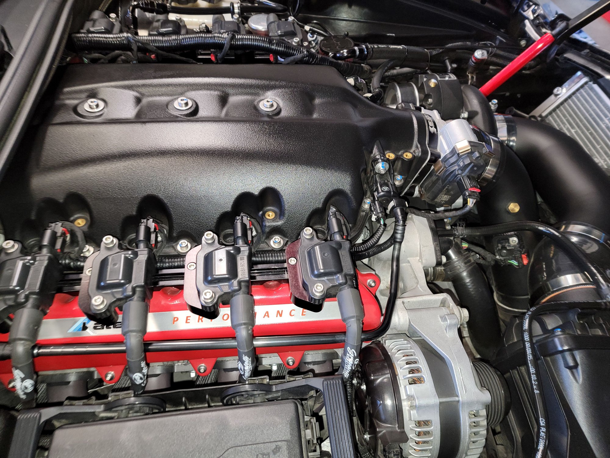

I hear you! I currently have the Snow Performance Single nozzle. Throttle Body Spacer injection. Absoluetly love it. Notice the pic, right after the Throttle Body. Not sure if I will keep Meth, depends on the Tuner's advice.
Nice I like the throttle body spacer setup looks clean. Might see if I can use this with the Alky Kit.
