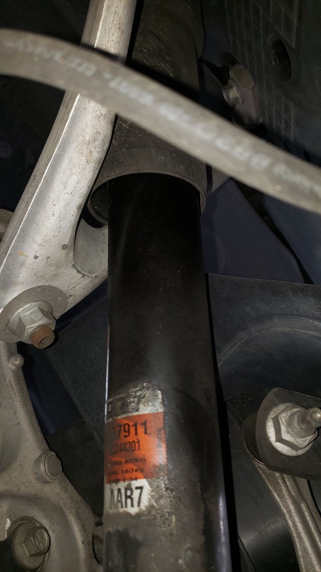

Need some suspension advice on my '16 Z51, M7 with MRC, approaching 100K miles with 1500 track miles. My trusted service dealer says my right frt shock is leaking and should be replaced. Looks to me to be an oily film with road grit rather than a heavier grease I've seen on the internet. They did also find a very small coolant leak from block fitting to heater hose on same side. I'm thinking this could be the source of the oily film attracting dirt onto the shock body. See attached:
Right side to be replaced?
left side supposed to be OK?
To those with experience with MR shocks: Do either of these look to be leaking to you? and should i replace both?

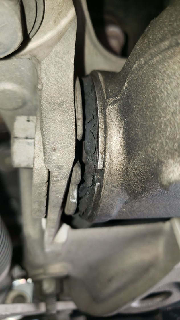

While under the car investigating the above situation, I looked at the
LCA bushings and I'm wondering if i should replace them before track season"

shocks are a wear item just like brake pads. at 100k change them especially since you track the car. and yes bushings are toast

I’d clean the shocks up, drive it for a bit, and see how they look after 100 miles.
bushings have some cracking but if you’re not hearing any noises then I think they’re fine.

That amount of oil on the outside is normal. It does not indicate need for replacement. That said on mileage alone I would have changed them long ago.

An "Advanced search" across the C7 sections of the Forum will show that GM called some leakage "normal," at least when they were still under warranty.

I agree the amount of oil on the shock seems normal. How does the car ride and how does it perform when on track? The MRC shocks wear somewhat differently than standard shocks so I don't know if 100K miles is too long on them or not. I would go with the first suggestion, clean the shock, and drive the car and see how it acts. If the car passes a bounce test (with the engine running so shocks are powered) and drives well over bumps and heaves then don't spend the cash to replace them. MRC shocks dampening changes with the application of an electrical current from the suspension controller. Magnetic particles in the fluid react to the current and change the fluid viscosity thus changing dampening.
I am attaching the GM Service Bulletin sent to dealers to guide them on how much seepage is considered normal.

Good thoughts here. I cleaned off the shocks and will check in a week or so for leaks. The service bulletin Bill attached (thanks) indicates that I may be looking at normal seepage.

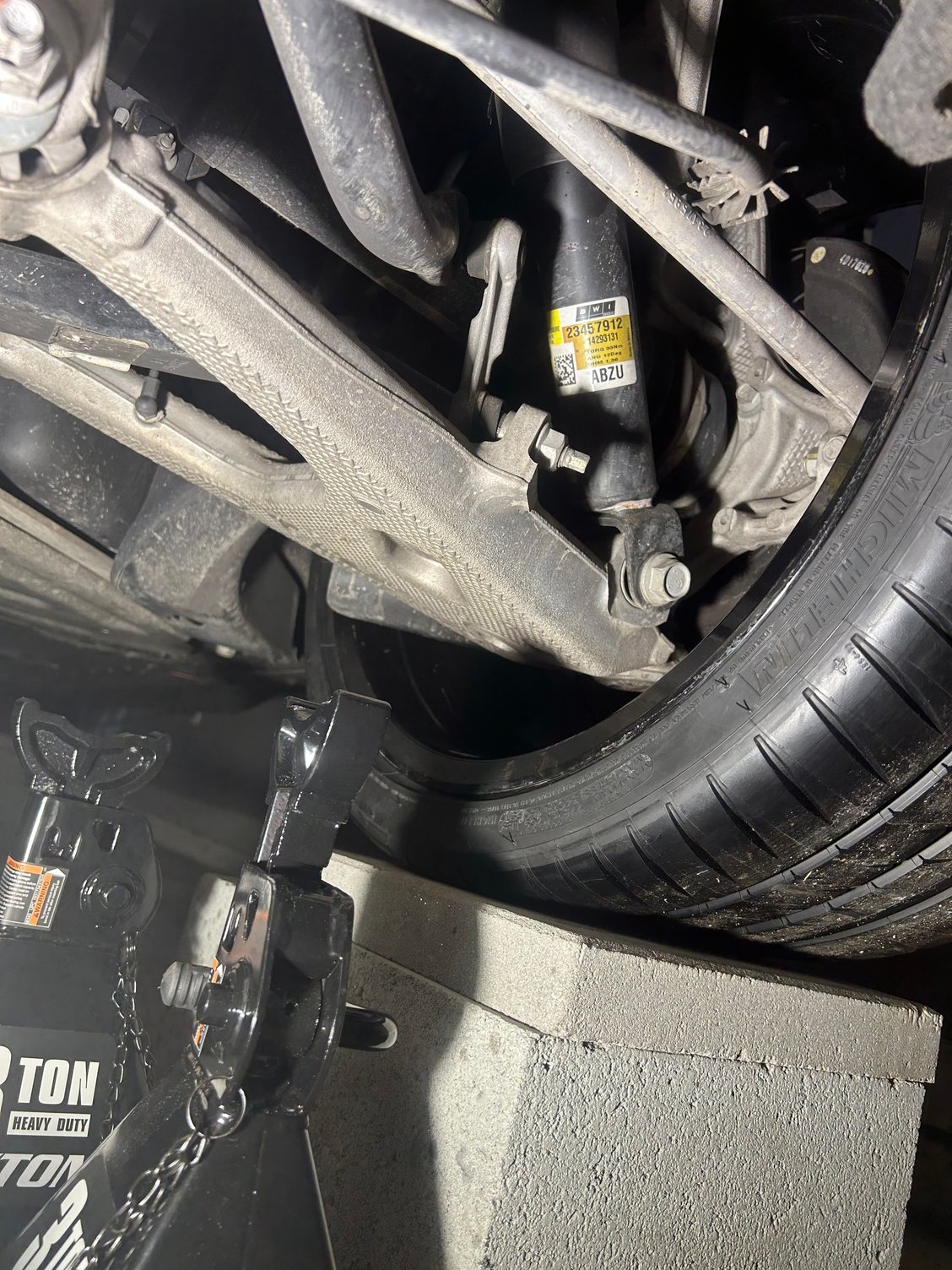

Noticed one of control arms was dark while changing diff and trans fluid. Is it time to replace? I have a Z51 could I use Z06/GS shocks?

I have no idea if you could upgrade to GS shocks, but I can tell you that I was quite surprised at how really noticeable the improvement in ride quality actually was. Probably should have done it 25,000 miles ago.
