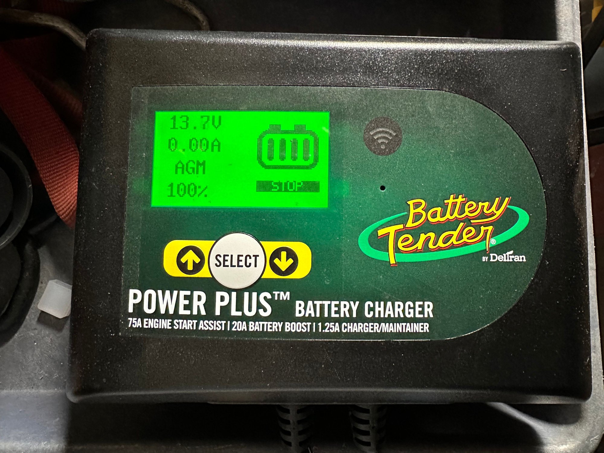

If you have a battery that becomes fully discharged for whatever reason, the little Corvette charger/maintainer they will not recharge the battery, at least not in any reasonable time. They simply do not have the capacity. They are maintainers, not chargers.
My charger below is for AGM service; however, it is fully capable for starter assist and battery boost. The downside is the price; it was about 150 bucks last year when I made the purchase. But when you need a powerful charger, this one is capable to provide the power needed for the electronics and for the starter to get the engine running.
