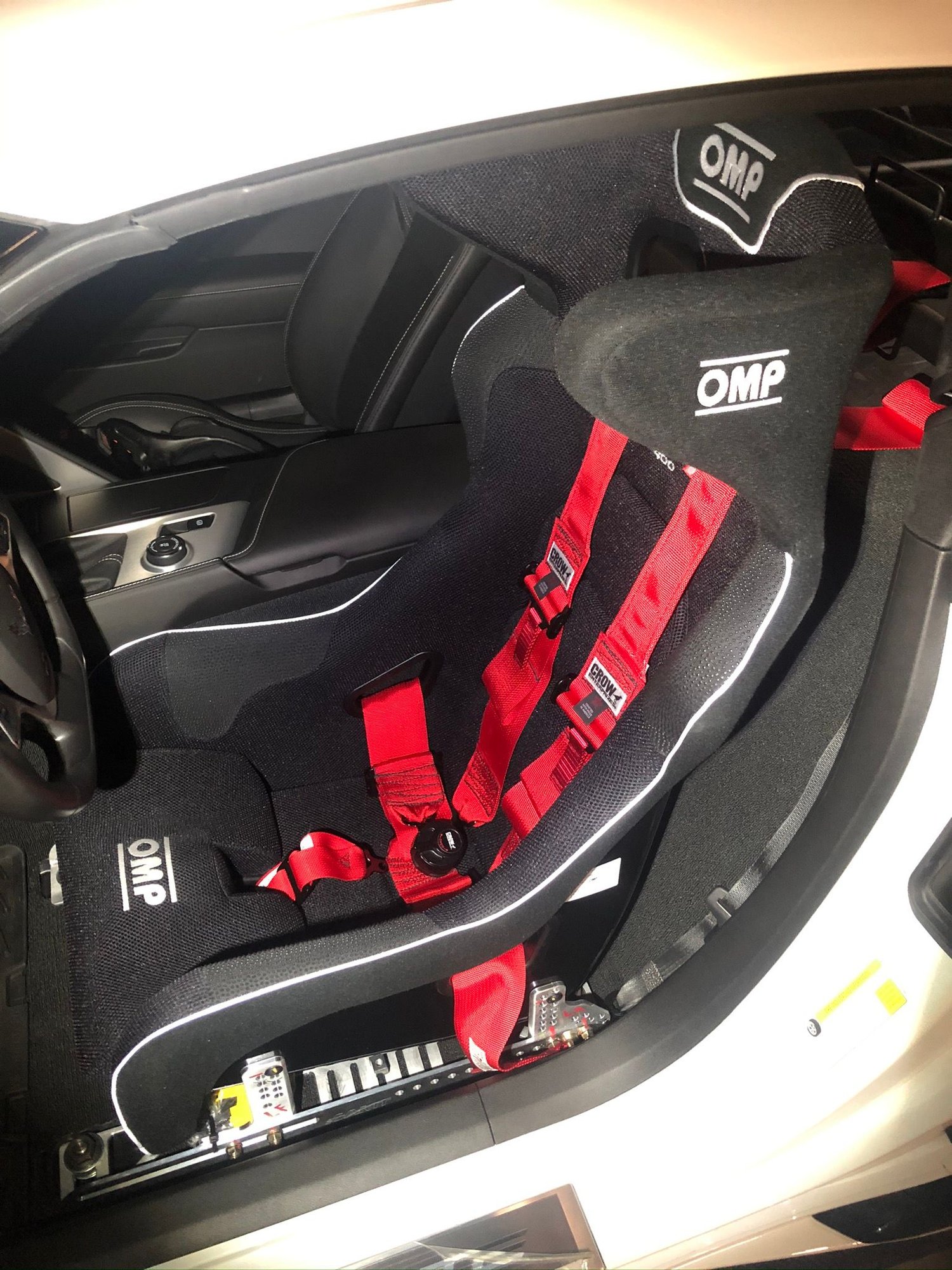

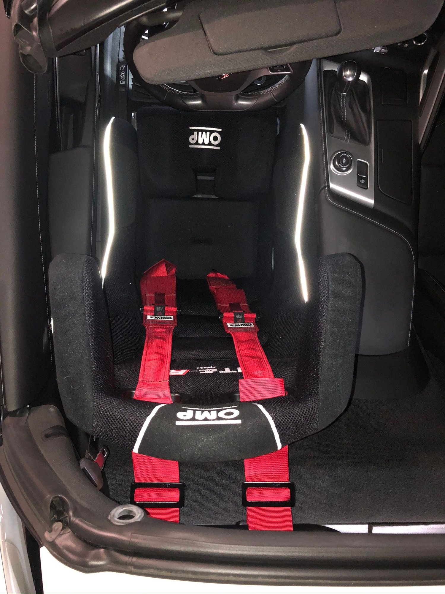

You mention harness so I'll assume by "primary use" you mean track. OMP HTE-R 400 Never have to worry about trying to hold myself in. There's a thread in the Auto-X / Road Racing section called "Will This Seat Fit My Car" (or something like that) with all sorts of pics, notes, etc

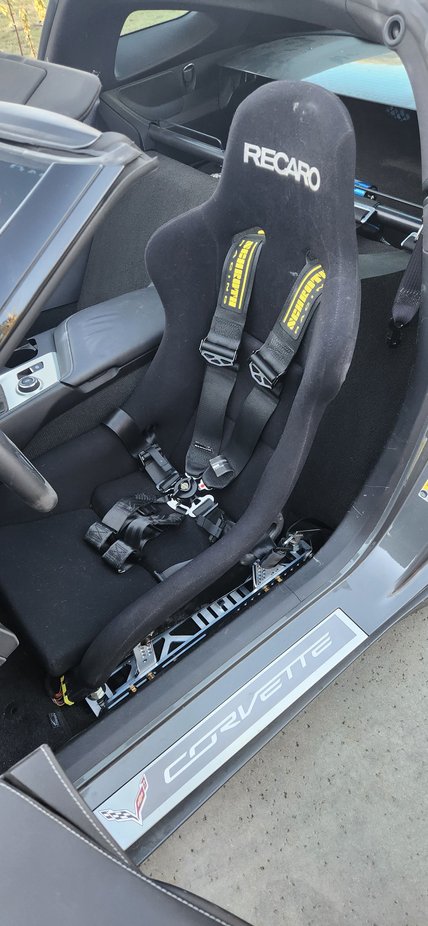

AMT Motorsports seat mount is a must with whichever seat you end up going with, I used their mount with a Recaro Pole Position.

I've always had good experiences with Recaro, but never in a C7. However, if I were looking for a replacement in mine, that's where I'd start. All the best.
