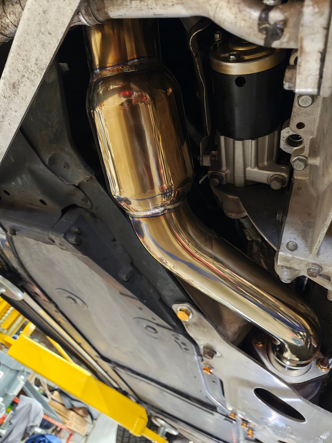

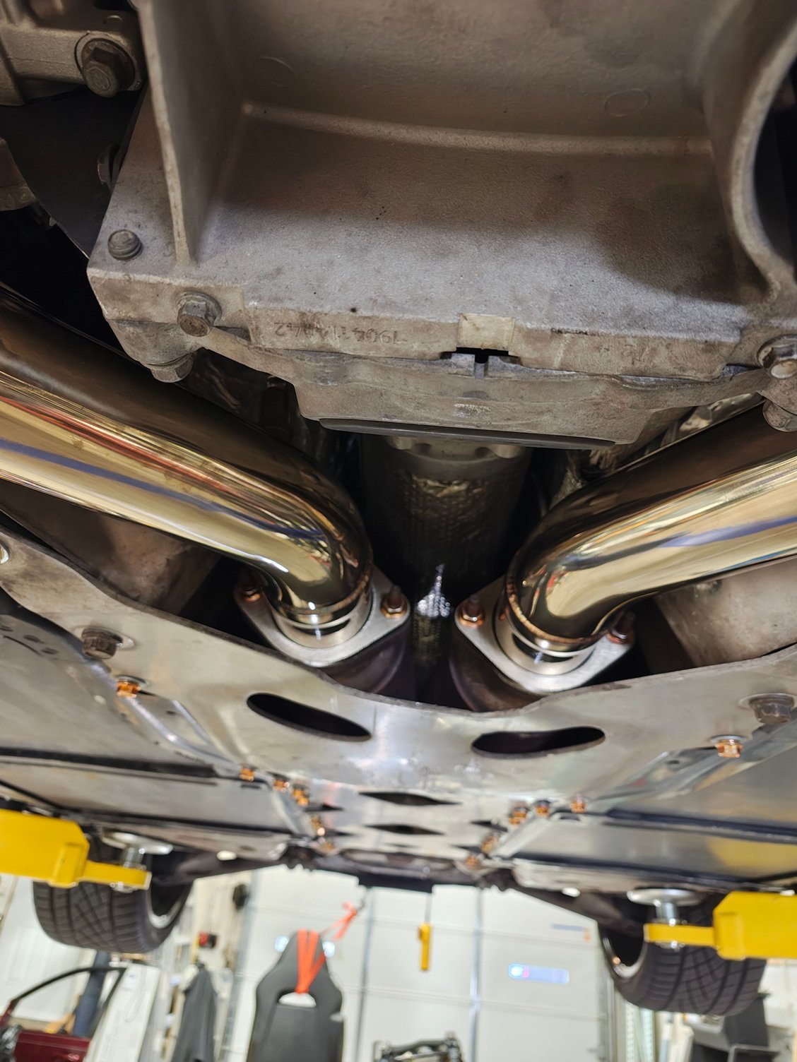

I know I am late to the game , but the way I did it was to loosen the motor mount bolts on each side and jack the engine up enough to get the pipe out. Also I remove the mid pipe to the axle-back. It worked well for me.
